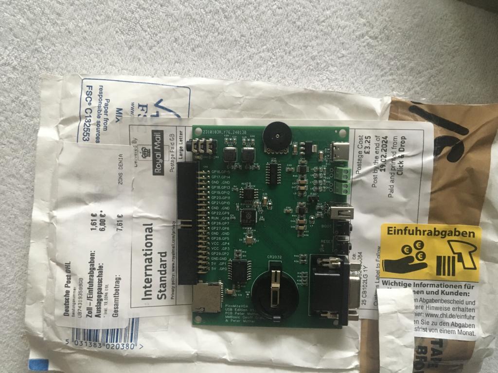

  atmega8 said
What a beauty!
Thank you Peter.
It is running out of the box with PicoMiteVGA MMBasic Version 5.09.00b0.
Trying to get it in the "Flash Mode" by pressing Boot and Plugin USB.
But that doesn't work for me.
I expected a new Drive to which i can copy the .u2f File?....
Ok, tomorrow i have som time left.
THX to all
Posts: 12045
Posted: 12:30pm 17 Feb 2024
You have to program it through the USB-A connector using a A-A male-male cable

Posted: 12:35pm 17 Feb 2024
  matherp said  You have to program it through the USB-A connector using a A-A male-male cable
Already tried it.
But i'am victim of a poor USB Cable, i think...
Try to find another one.
Posts: 12045
Posted: 12:41pm 17 Feb 2024
Remember assuming it is powered (though the USB-C) you need to hold boot and press reset

Posted: 12:45pm 17 Feb 2024
Another Cable works.
Is it allowed to ask where I can download the latest version?
