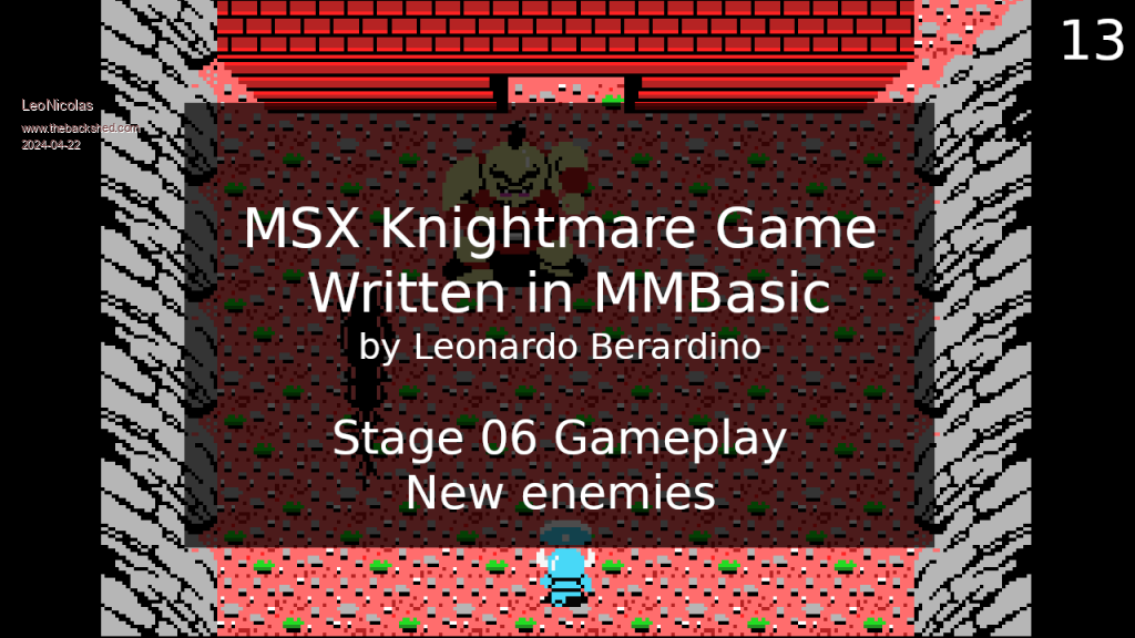

I released the stage 6 gameplay video.
https://youtu.be/TD_DWqn7wSA

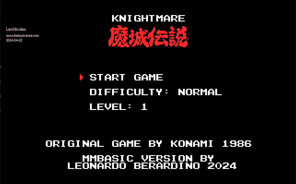

Hello everyone
I completed the game intro and main menu implementation. The next steps are to implement stages 07 and 8.
https://www.youtube.com/watch?v=xB08OaIKxmU
Posts: 6187
Posted: 07:49am 28 Apr 2024
Nice, even without level 7 and 8 it is a complete game now.
Excellent work Leonas.

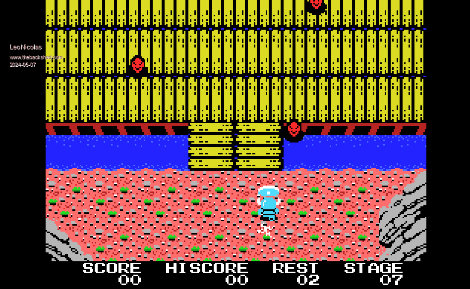

Posted: 02:25am 07 May 2024
Stage 7 is coming

@LeoNicolas,
Is the code here https://github.com/leonicolas/knightmare-cmm2 out of date ?
I ask because if I look at init_menu() it makes a series of calls to print_centralized() which will ultimately blit the text glyphs to PAGE 1 ...
... but I can't find any code that then copies PAGE 1 to PAGE 0 so (at least in MMB4L) that text will never be displayed.
Doesn't seem to work as it currently is on either MMB4W or MMB4L ???

At the start of "init.inc", Leo uses "mode 3,12". Page 1 sits on top of page 0, no?

Yes, I use mode 3,12 and both pages (0 and 1) for background and text. It works on MMB4W. I haven't tried on the real CMM2 or the Pico yet.
Yes, the source code is up to date in the repo.
