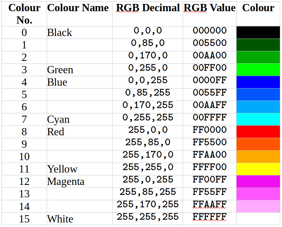

Here's an example of the palette table I was thinking of.  It could even include a column that shows the output levels of the corresponding pins from the Pico.
I'm not sure if this is the order that the palette is defined in or if the "Colour No." is relevent.", if indeed the colours can be specified by number.
Also, I only allocated the names that were obvious to me without Googling.  Another reason why a picture with colours would help in this situation.

Here is a colour counter that shows the colour numbers for R, G and B for each unique colour.
'Display Colour Counter - requires MISO connected to LCD_SDO
Dim a$(2)=(" Blues"," Greens"," Reds")
Dim integer b, c, n
Print
For b=0 To 2
 n=0
 For c=0 To 255
  Pixel 99,99,c<<b*8
  If Pixel(99,99)=c<<b*8 Then
   Inc n
   Print c,
  EndIf
 Next
 Print :Print n;a$(b): Print
Next
And the output for the PicoVGA
0       255
2 Blues
0       64      128     255
4 Greens
0       255
2 Reds
So for green  the 4 colours are 0  1/4  1/2  1 of maximum.
That is the top two bits from G in a 24 bit RGB value
Edited 2023-04-29 12:35 by phil99
