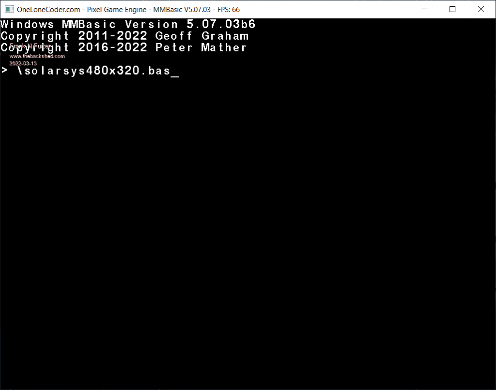

When I try to start a program with the name "solarsys480x320.bas" with
MMBASIC 0 "solarsys480x320.bas"
, only follwing happens:
That's all - nothing else happens...
This program is in the same folder as MMBasic.exe "\Documents\MMBASIC"
Frank
Posts: 3413
Posted: 03:36am 13 Mar 2022
The output screen shows that MMBasic is looking in the root directory for the program and not finding it. To test this put a copy of it in "\" or include the path in the command.
MMBASIC 0 "\Documents\MMBASIC\solarsys480x320.bas"
If you want that to be the default path type:-
OPTION DEFAULT PATH "\Documents\MMBASIC"
or if you wish to keep the current default path:-
OPTION SEARCH PATH "\Documents\MMBASIC"
To see what the current default path is type:-
OPTION LIST
Edited 2022-03-13 13:42 by phil99

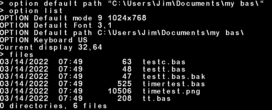

Posts: 6626
Posted: 08:49pm 13 Mar 2022
A space in the default path is not a problem.
Just start from "C:\" and enclose it in quotes when specifying.
Seems to work for me...
Edit:  If you have any Unicode characters in the path there could be problems.
Edited 2022-03-14 07:02 by TassyJim
