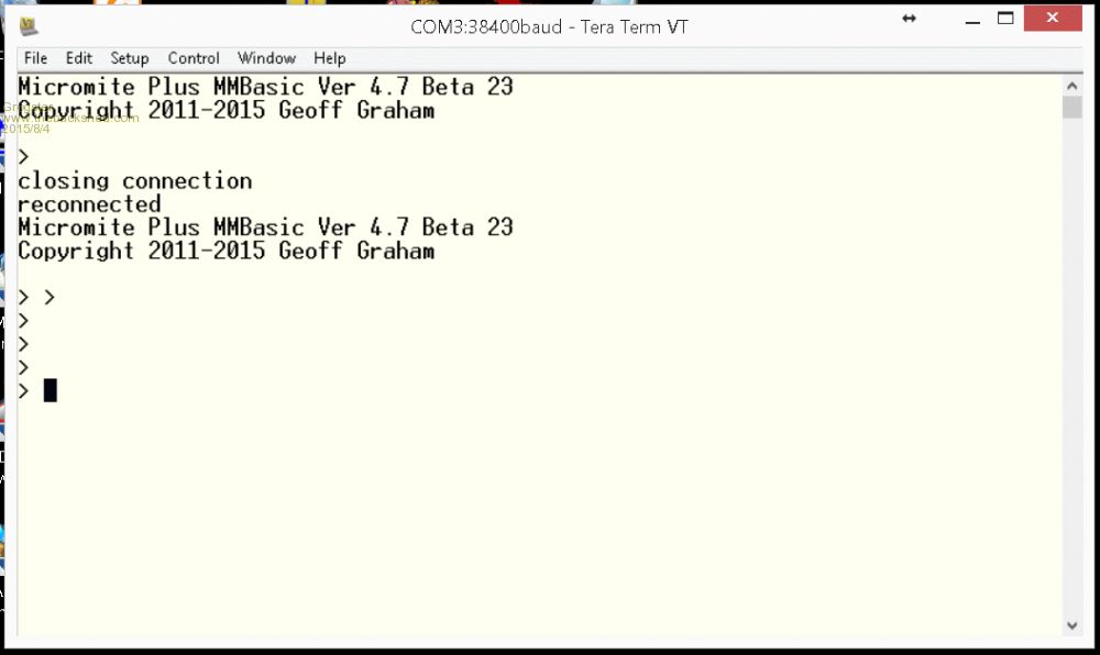

One thing that has been really annoying me, is having to unplug and replug, and restart TT. Not an issue if you do it once or twice, but if more then that....
Excellent tool - I vote that this info be in a thread of it's own - many would find it very useful.
EDIT: Just tried this, but it does not work - for me. Exact same problem - VCP vanishes, and you can't get it back, CTRL+F1 does nothing, have to power down, remove MM+, replace MM+ and restart TT.
Any idea why this is not working for me?

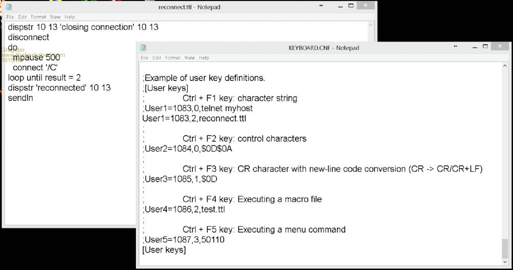

EDIT: Here is a shot of how I have the files configured:
Also I should point out that I never get either of the prompts at ANY point in the process. I am guessing that "Closing connection" and "Reconnected" should be showing up as prompts in the TT window, yes? If that is the case, I never get them.

5) "Closing connection" prompt [FAIL]
6) "Reconnected" prompt [FAIL]

aha, you need to remove the ";" before "[user keys]" as well!
it took me a couple of hours to get the incantations just right, teraterm is quite finicky about things being just right.
rob :-)
Posts: 10075
Posted: 03:58pm 03 Aug 2015
AWESOME - thanks for that, Rob.
...one rotten semi-colon later.....

BobD (Bob Denton) has sent me a nicely written up set of instructions as a PDF, attached here for anyone who would like to keep a copy or add to the archives.
2015-08-04_094221_Easy_reconnect_of_USB_port_to_TeraTerm_after_client_reset.pdf
there are a few other neat tricks that TeraTerm can be set up to do that may also be useful. it is possible to turn the modem control lines on/off and send a break signal. the micromite+ could potentially respond to this internally to do things like resetting itself (if the USB code carries on running after a crash), sending internal interpreter debug information out a spare serial port or even saving it to an area of onboard flash, etc.
the commands are:
setdtr <flag>
setrts <flag>
sendbreak
while the micromite+ would need to respond to these events internally (as there are no physical modem wires present), the physical lines DTR and RTS could be used with a MX170-based micromite (connected via a USB to serial bridge) to manipulate the reset pin.
TeraTerm can also respond in 'complex' ways to command sequences sent to it. when i worked at one place, we had TeraTerm set up to upon request download the current date/time to an embedded system that had no onboard RTC.
for more info, see:
http://ttssh2.osdn.jp/manual/en/macro/
rob :-)

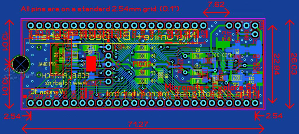

I've read through this post and I can't find it
Does anyone know the pins needed to connect to an SSD1963 display?
my mind has gone blank on what' needed to connect the display up
Also can anyone tell me the distance in mm between the 2 rows of pins?
I want to make a board that will plug directly onto an SSD1963 and have one of these plugged into it

The pin spacing I'd like to know is the horizontal spacing between the E64 rows of pins
palcal
Joined: 12/10/2011
Posts: 2053
Posted: 09:36pm 13 Mar 2018
OK just measured my board and that spacing is .9" or 22.86mm.
Paul.

Posts: 10075
Posted: 11:31pm 13 Mar 2018
I drew this ages ago, sorry you had a hard time finding it anywhere.
