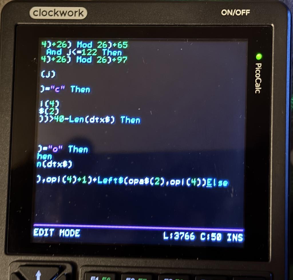

I continued testing long lines on Picocalc.
When I press backspace in the beginning of a line after a long line I got the same problem. Check picture. The other lines I will never see (expect the long on where I can navigate) until I escape editor and come back.
G@bor
