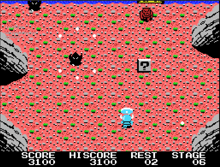

I committed the fix for the error you reported. I hope it is fixed. . I tested stage 1 after fixing the issue, and it looks like it is no longer happening.
This screenshot is from stage 6. Not enemies or boss implemented yet.

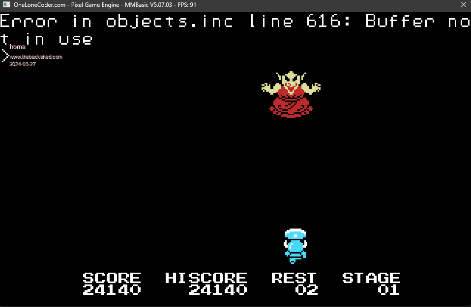

Hi Leo,
I tested the current git version today with the MMBasic you specified. So far it works! Even with XBox controller and/or keyboard without any code changes.
However, there is an error with the final boss in level 1 ...

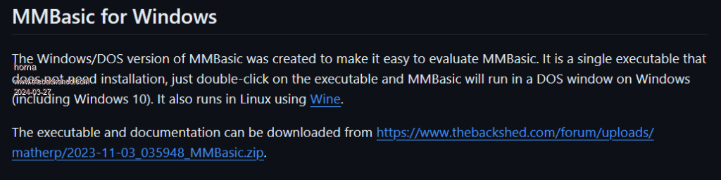

And I think you should update the GIT info page. https://github.com/leonicolas/knightmare-cmm2
It still refers to an old, incompatible version of MMBasic.

I have fixed the issue you reported and the link to download MMB4W.
Let me know if you find any other issues.

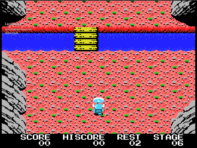

Sure, and immediately:
There was another glitch. Before a river, I left the screen on the left and came back on the right.
This happened so quickly that I had no way of documenting it. (Stage 3 or 4?!?)
Matthias
LeoNicolas
Joined: 07/10/2020
Posts: 625
Posted: 10:28pm 28 Mar 2024
Matthias
This is a normal behavior. There are some places in the maps where you can wrap around the corners.
I will fix the bug from your screenshot.
Thank you for helping me testing the game

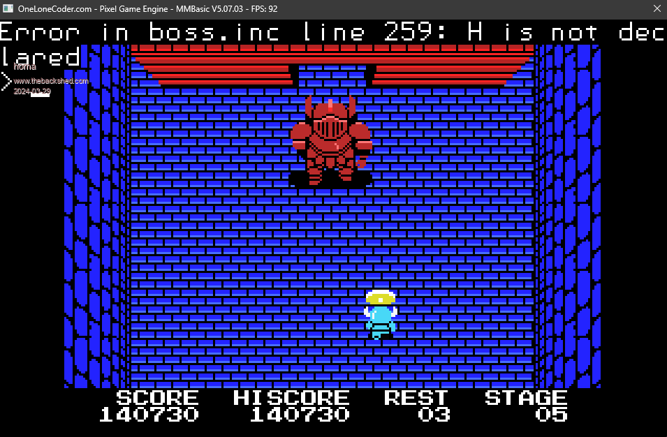

Posted: 06:02pm 29 Mar 2024
Matthias
I have fixed the stage 4 boss movement pattern and the crash from your screenshot.

Posted: 09:25pm 30 Mar 2024
Leo
Understanding, knowing
Try the following... Start, run left in front of the obstacle and let yourself be pushed down out of the screen area.
You will get an error message ;-)
