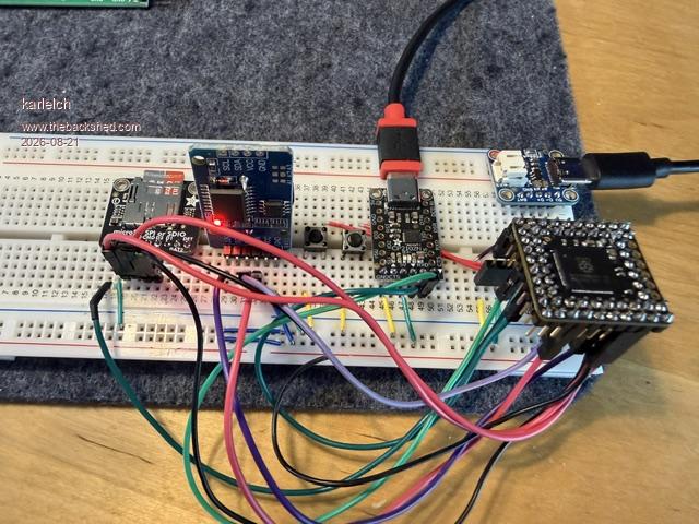

karlelch
Joined: 30/10/2014
Posts: 361
Posted: 08:04am 21 Aug 2026
  Quote  If you don't have a RTC and GP27 isn't wired use the PC2 sdcard wiring. If you connect a RTC and GP27 to the 32K output then the firmware will know it is running on a PC3 and you must use its sdcard wiring. You can uses SPI for the SDcard unless you connect and RTC, This was a mistake of mine on the PC2 but MMBasic, MicroPython and now Fuzix work round it using a bitbanged sdcard driver. I don't think this is particularly any slower.
In both the PC2 and PC3 you really should have a RTC as this is used for timestamping files etc.
I added now a RTC and changed the SD card wiring to PC3 - now it works really reliably. My impression was that with the bitbanged SD card access (in PC2 mode), the jumper cable solution was not reliable - but I am also using shorter wires now. In any case, it now recognises the SD card everytime.
One question: It always asks for the bootdev - can this be set to hdb2 by default?

Here is a picture of the working minimal setup:
Thanks and best
Thomas
Posts: 9220
Posted: 08:16am 21 Aug 2026
The PGA2350 is a bit less than breadboard friendly, isn't it?  :)
karlelch
Joined: 30/10/2014
Posts: 361
Posted: 08:24am 21 Aug 2026
... I just saw that networking is now supported ... I can't keep up.
Now I have to add another breakout board to my contraption
karlelch
Joined: 30/10/2014
Posts: 361
Posted: 08:25am 21 Aug 2026
  Mixtel90 said  The PGA2350 is a bit less than breadboard friendly, isn't it?  :)
Yes ....

For breadboard use with the PGA2350 I installed the row of pins with things like USB pointing down and the rest pointing up. That way you can plug it into the breadboard for stability but have access to all the pins
