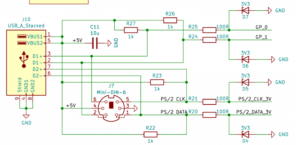

Flashed with new firmware 6.00.01RC5 for RP2350 VGA & HDMI, configured the mouse OPTION MOUSE GP0,GP1 with the option. Took out and connected the PS/2 mouse.
After the reset, if the PS/2 mouse is connected, there is a colored cursor in the editor in the upper left corner, but it does not move. When re-entering the editor, the mouse cursor is no longer there. After the reset, the same situation. Checked with two working PS/2 mice.
What could have gone wrong with me?

Have you installed the pullups?
For the RP2350 use 4.7kΩ to 5V

I use this connection scheme with a 1k bus pull-up to 5V power supply. And it works great for the keyboard, but something is wrong with the mouse...
Also, I connect the mouse and keyboard to one socket on the board via a Y-shaped adapter splitter.
Edited 2024-12-04 08:37 by javavi

Are you using a PS/2 splitter adapter, or plugging the mouse directly into the socket?
The latter won't work.
The mouse plug uses the same pins as as the keyboard plug so a PS/2 splitter adapter transposes pins 6 & 4 to 5 & 3 for the mouse socket.
Posts: 12049
Posted: 10:48pm 03 Dec 2024
No idea, your circuit is far more complex than mine: 4K7 pullups and nothing else. In my case just to 3V3. Try getting rid of all the excess and connecting without a splitter direct to GP0,GP1 with just the 4K7 pullup and power and GND connected. The code is from the CMM2 and known working
Edited 2024-12-04 08:50 by matherp

Why does the mouse cursor appear in the EDITOR only when the PS/2 mouse is connected and disappear when you re-enter the EDITOR?
The impulses from the CLOK and DATA mouse on the Pico2 pins are of normal shape, checked with an oscilloscope.
Any ideas?
P.S. So, on ports GP2, GP3 the mouse worked!!! :))
I will check the scheme further...
P.S.S. I swapped the mouse and keyboard on the adapter and configured their options accordingly, and now it works!
This means that my circuit is in order and works fine for both devices.
