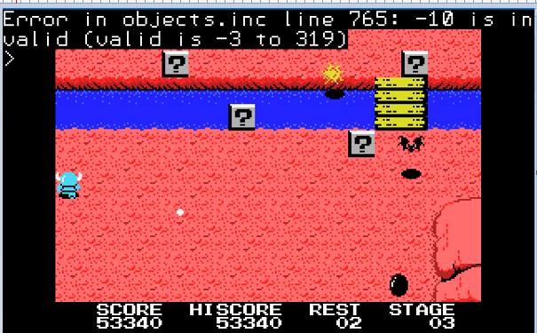

Another crash.
I have not been able to replicate the sprite like artefacts yet. Noticed that the arrows that those other knight things are firing are pointing the wrong way now, I don't think they were before.
MMBasic reporting that it has seen the controller is annoying because you have to restart the game. I'll report that to Peter in the other post. Maybe an MM.INFO flag may be better?

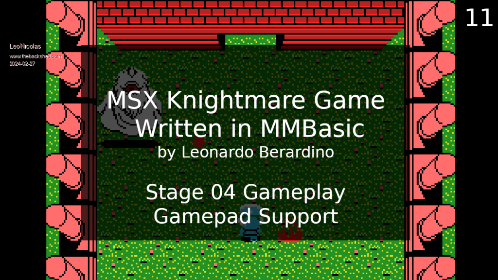

Hello everyone
New video released: https://youtu.be/OcjvFrNt5Hg
News:
- Stage 4
- Support for gamepads
- Bug fixes

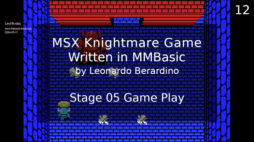

Stage 5 gameplay
there is a bug in the final boss implementation that I will fix today. It is not allowing to the defeat it.
https://youtu.be/in6Or0CSGJE

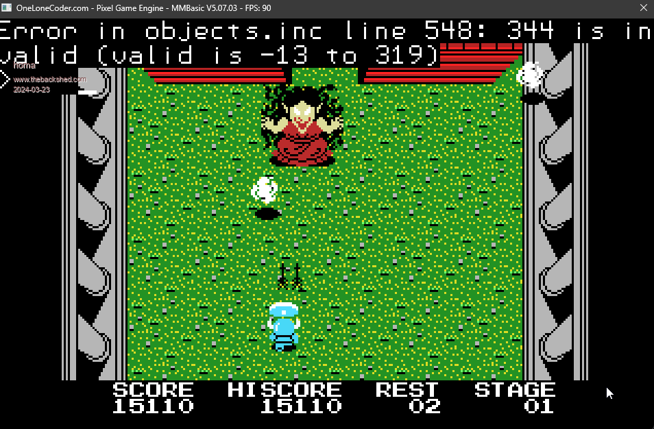

hello LeoNicolas,
I tried out your game again. Status today from github. Because of error messages I had to comment out line 25 in init.inc for the specified MMBasic version:
' gamepad on handle_gamepad
and
in the file "km.bas" in line 157 directly after the
sub process_gamepad()
insert an "exit sub"
Today the keyboard control worked but unfortunately no collision. So unfortunately you are invulnerable.
Nevertheless the gameplay is fun!
However, I received the following error message for the final boss:
continued success!
Matthias
LeoNicolas
Joined: 07/10/2020
Posts: 625
Posted: 03:47am 23 Mar 2024
Hello Matthias
Thank you for testing the game. You need to download the latest MMB4W version to get support for gamepads. Check out this post:
https://www.thebackshed.com/forum/ViewTopic.php?FID=16&TID=16531
I didn't implement the player collision against shots and enemies because it makes the game easier to test. I will try to do it for the next version and add a flag to disable the collision.
I will look at the error you reported. Sometimes, I introduce errors in the early stages when implementing new ones. This error is probably related to some update I did while implementing the stage 5 boss.
