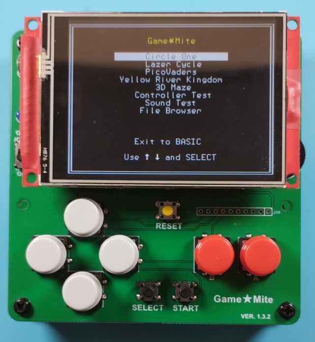

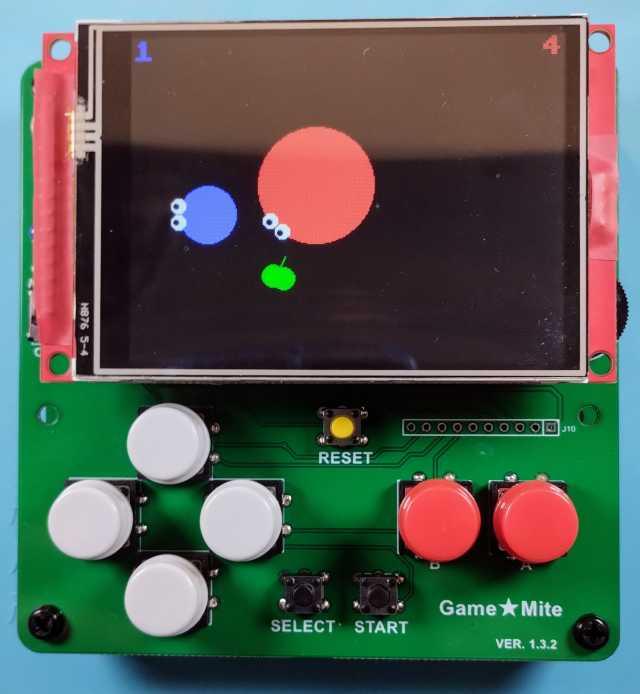

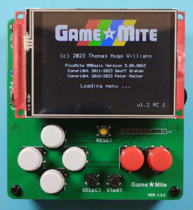

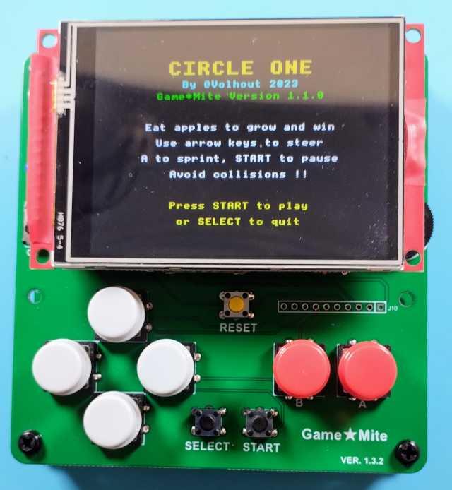

Alas it appears I get worse, not better at taking photos:
Merry Christmas & Happy New Year,

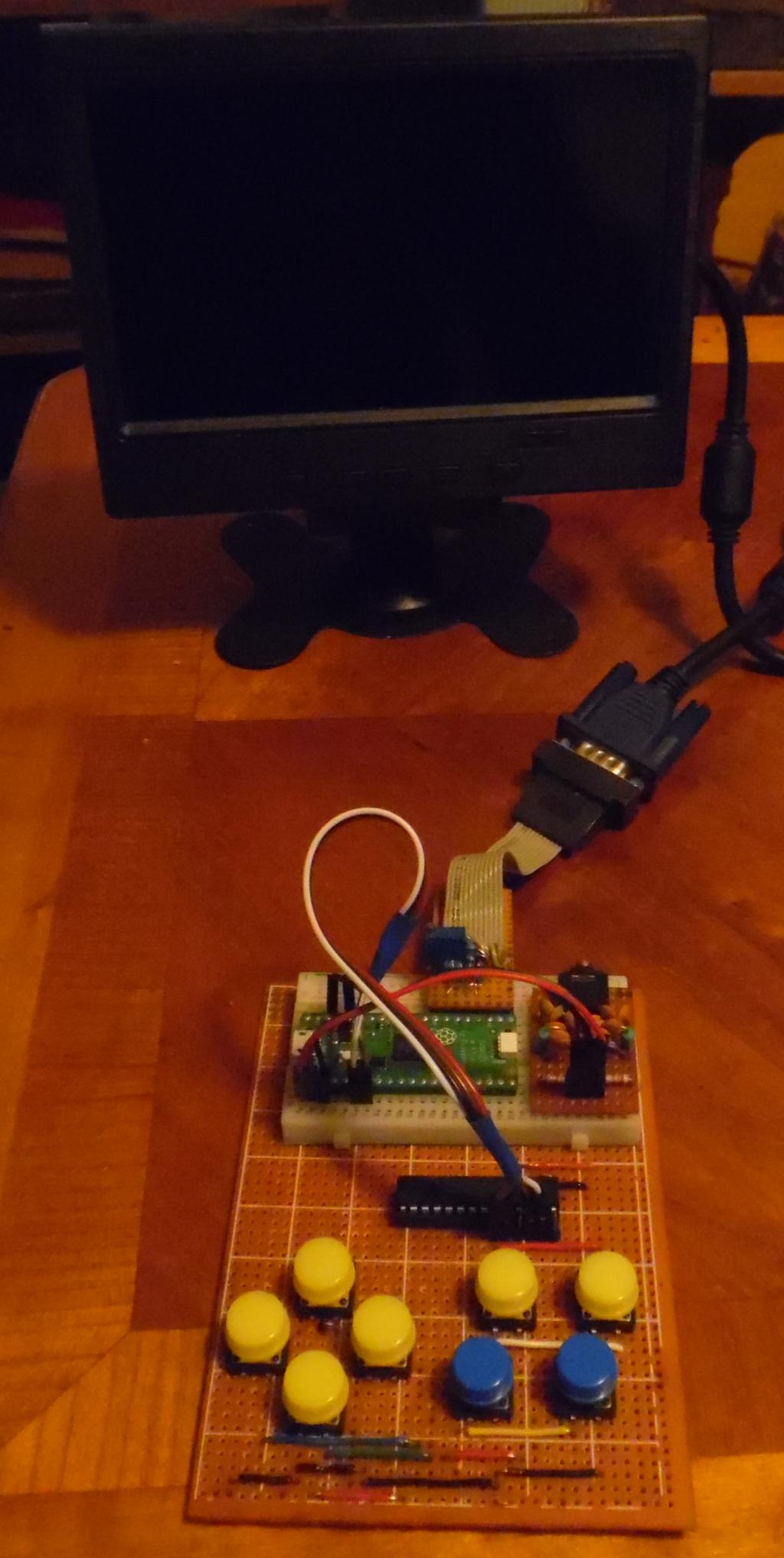

Loved by grandchildren (and older generations):
Pluto

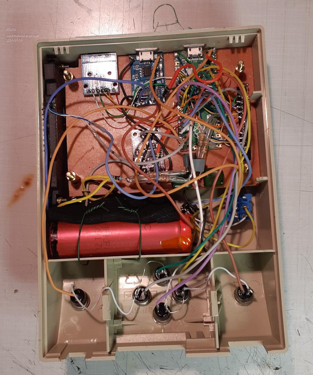

Tom,
it is not only a clone; it is more like a clown.
Enclosure from some old recycled (BOSCH) equipment. Can't remember what it contained.
LCD attached to a scrap PCB used as support for the various modules (SD, Charger, Pico and PAM8302 audio. Black thin box on left side is a recycled laptop speaker. Battery recycled from an old laptop.
Inside looks very much like a transistor radio from the sixties:
Believe it or not; It works!
The longer cables are soft silicone wires which enables the PCB to be removed from the box without need to desolder anything. Servicefriendly!
The only problem I had was with the (cheap) switches. Was corrected by with CRC Contact Protect.
PAM8302 sound is (fortunately) not too loud!
