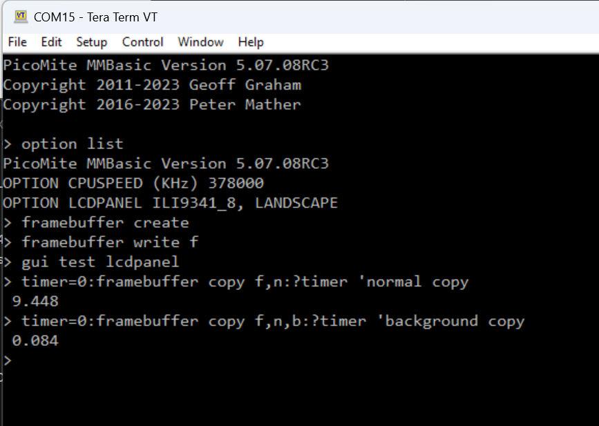

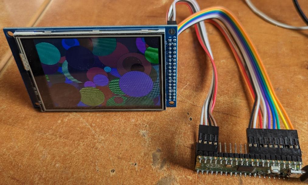

  matherp said  This is more like it    This provides a proper platform for games (Tom!)
Very nice Peter, is it in the download yet? ;-)
Regards Kevin.
Posts: 6193
Posted: 09:11am 26 Sep 2023
Regards Kevin.
Looks like Peter is also using the ILI9341 in parallel mode, not SPI mode.
Tom's game platform needs an update....game*mite2
Impressive as always Peter, I guess I'm not doing it myself or buying you a panel . Given I can't see any configuration in the OPTION LIST I'm assuming it is on fixed pins - not complaining - just observing.
  Quote  This provides a proper platform for games (Tom!)
Not this year, there are software things to be done to take advantage of the current Game*Mite, not to mention I may have to bribe @bigmik if I'm expecting him to do another 100+ hours of PCB work on a future v2.
Even if it were possible to do so, I'm claiming no priority over this. If some other shedder wants to create a handheld based on the parallel interfaced ILI9341 then knock yourselves out.
Edited 2023-09-26 19:18 by thwill

My impression, from Peters comments, was that this will (eventually) work on the serial SPI, maybe not quite so fast, but still freeing up loads of processor time on the MMBasic CPU.
Regards, Kevin.
Posts: 4405
Posted: 09:32am 26 Sep 2023
  Bleep said  My impression, from Peters comments, was that this will (eventually) work on the serial SPI, maybe not quite so fast, but still freeing up loads of processor time on the MMBasic CPU.
Regards, Kevin.
I believe with all the work that Peter has done we should be able to get 8-10 fps from the Game*Mite for PicoSCII Robots which I think should be adequate.
Biased as I am, I believe the current Game*Mite is a good platform and there is plenty of scope for entertainment from it. In addition it has a useful amount of I/O on its expansion port and enough buttons to make it a potential alternative to @Mixtel90's PicoMite backpack for some applications.
Edited 2023-09-26 19:33 by thwill
