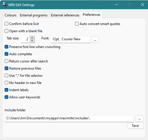

Hi Jim, I'm not running the latest version yet, but somehow I lost the MMEdit's known location of my INCLUDE files, probably my fault because I think I renamed the folder without telling MMEdit.
I went back a couple of posts and found how to tell MMEdit where it was so that's now OK. I don't know if that method is documented yet but it would be good if the location could be set in 'preferences', I think that is a more intuitive way to do it if that is possible.
PS. As I write this I think I may have said it before, if so, I apologise.
Posts: 6626
Posted: 04:46am 11 Jun 2023
  Quote   probably my fault because I think I renamed the folder without telling MMEdit.
A sure way to confuse MMEdit
  Quote  it would be good if the location could be set in 'preferences', I think that is a more intuitive way to do it if that is possible.
I have finally started to add things to Preferences so I will put it on the list.

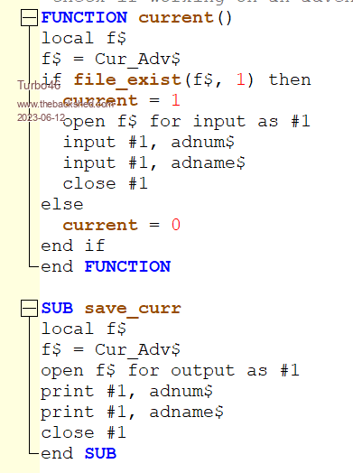

Sorry Jim, but I've come across another 'funny' thing. I down loaded the program from this post, opened the zip and double clicked the .bas file (I have .bas associated with MMEdit). The file came up without any highlighting, the default syntax was DOS as I had set it but the little box down the bottom said 'txt'.
Clicking on syntax > DOS fixes it of course but it seems that opening a bas file from inside a zip confuses it a little.
I zipped one of my own Basic files and repeated the procedure and got the same result. Oddly enough SUB and FUNCTION are highlighted but the tkn files contain no entries to highlight.
Posts: 6626
Posted: 08:08am 14 Jun 2023
SUB and FUNCTION are sued for code folding so they will always appear as a keyword.
