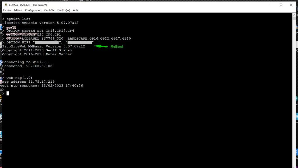

There is progress. I was able (finally) to enter my 3 minimum options "System" and lcdpanel without blocking the card.
However, after entering the WIFi option, I had to restart the pico (powet off/power on) because I couldn't do anything anymore.
After the restart, I have wifi.
A little more effort and the picoW under picomite will be almost as good as under Arduino

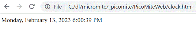

Without having any real understanding of how it might work with the PicoMiteWeb, I thought/hoped that javascript might work, since as I understand it, execution is on the PC side.
I have a little html file which presents Day of Week, Month, Day, Year, Time (with the time updated second by second). This works when I just put the local address of the file in a browser line: file:///C:/dl/micromite/_picomite/PicoMiteWeb/clock.htm
When I try to serve it from the PicoMiteWeb, I get a syntax error:
>run
ntp address 162.159.200.123
got ntp response: 13/02/2023 15:26:41
String is       GET / HTTP
sending page
[33] WEB transmit page ii%,"clock.htm"
Error : Expression syntax
Here's the HTML:
<html>
<div id="clockbox"></div>
<script type="text/javascript">
var tday=["Sunday","Monday","Tuesday","Wednesday","Thursday","Friday","Saturday"];
var tmonth=["January","February","March","April","May","June","July","August","September","October","November","December"];
function GetClock(){
var d=new Date();
var nday=d.getDay(),nmonth=d.getMonth(),ndate=d.getDate(),nyear=d.getFullYear();
var nhour=d.getHours(),nmin=d.getMinutes(),nsec=d.getSeconds(),ap;
if(nhour==0){ap=" AM";nhour=12;}
else if(nhour<12){ap=" AM";}
else if(nhour==12){ap=" PM";}
else if(nhour>12){ap=" PM";nhour-=12;}
if(nmin<=9) nmin="0"+nmin;
if(nsec<=9) nsec="0"+nsec;
var clocktext=""+tday[nday]+", "+tmonth[nmonth]+" "+ndate+", "+nyear+" "+nhour+":"+nmin+":"+nsec+ap+"";
document.getElementById('clockbox').innerHTML=clocktext;
GetClock();
setInterval(GetClock,1000);
</script>
<html>
Am I doing something wrong, and/or is there a way to get this to work on the PicoMiteWeb (the file is named "clock.htm")?

Posts: 6626
Posted: 03:44am 14 Feb 2023
@lixby
You need to replace all instances of a single { with {{.
Any html file a single { indicates the start of a variable name. The double {{ is MMBasic's signal to send a single { and not substitute a variable value.
clock.html
<html>
VAR tday=["Sunday","Monday","Tuesday","Wednesday","Thursday","Friday","Saturday"];
VAR tmonth=["January","February","March","April","May","June","July","August","September","October","November
","December"];
Function GetClock(){{
VAR d=new Date();
VAR nday=d.getDay(),nmonth=d.getMonth(),ndate=d.getDate(),nyear=d.getFullYear();
VAR nhour=d.getHours(),nmin=d.getMinutes(),nsec=d.getSeconds(),ap;
If (nhour==0){{ap=" AM";nhour=12;}
ElseIf (nhour<12){{ap=" AM";}
ElseIf (nhour==12){{ap=" PM";}
ElseIf (nhour>12){{ap=" PM";nhour-=12;}
If (nmin<=9) nmin="0"+nmin;
If (nsec<=9) nsec="0"+nsec;
VAR clocktext=""+tday[nday]+", "+tmonth[nmonth]+" "+ndate+", "+nyear+" "+nhour+":"+nmin+":"+nsec+ap+"";
GetClock();
</script>
</html>

I copied your "replace all instances of { with {{....."
Along the way, several keywords now are in capitals or initial capitals , these need to be in lower case.
Initial tmonth line has an extra CRLF.
else if has turned into ElseIf, function into Function.
Anyway, fixed these up and the clock now runs via the web page :)
