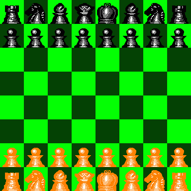

Here the sprites are adapted to the edges of the tiles, each sprite is 48x48 pixels, i.e. 6 tiles wide and 4 tiles high. The highlights can, as they are on other tiles, be set independently of the colour of the playing field
enlarged here for clarity
so, in Mode1 it could look like this:
Edited 2024-11-15 02:13 by Martin H.

Looks nice, the queen is a bit out of scale. How high is the actual piece? In case it is 36 pix, you can use a trick to place it in the centre of the field, and offset the playfield 6 pixels down.

  Volhout said  Looks nice, the queen is a bit out of scale. How high is the actual piece? In case it is 36 pix, you can use a trick to place it in the centre of the field, and offset the playfield 6 pixels down.
  Martin H. said   each sprite is 48x48 pixels, i.e. 6 tiles wide and 4 tiles high. The highlights can, as they are on other tiles, be set independently of the colour of the playing field
no, sadley they couldn't be moved pixelwise, the appearance depends on their position on the tiles
