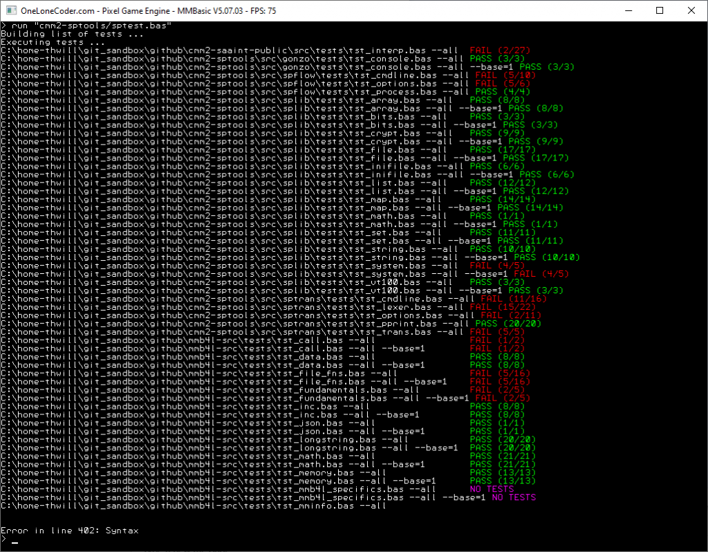

Starting to look pretty good with b4:
Notes:
1. I'm currently focusing on getting them all to run without crapping out ... which is what tst_mminfo is currently doing due to no OPTION SEARCH PATH being implemented.
2. Some of the FAILures are almost certainly false positives.
3. This is NOT a comprehensive set of unit-tests.
Two for today before I do some "real work":
1. Is OPTION SEARCH PATH not supported in MMB4W ? Will it be ?
2. Try this:
> files "a\b\c"
Not found: C:\home-thwill\git_sandbox\github\a\b\\c
Note the double \\ before c.
Edited 2022-03-08 20:18 by thwill

Posts: 4405
Posted: 10:47am 08 Mar 2022
Hi Peter,
1.
  matherp said
  Quote   Is OPTION SEARCH PATH not supported in MMB4W ? Will it be ?
Wasn't going to given there is a full OS available to MMbasic
Your rodeo Peter. I think it should be implemented and I recently did so for MMB4L. As an argument if it were implemented I could then setup MMB4W so I could just type "*sptest" wherever I was in the file-system to run my unit-test suite recursively from that point. YMMV, but if you do implement it then please also implement the corresponding MM.INFO$(OPTION SEARCH PATH).
2. You appear to have implemented OPTION CONSOLE BOTH|CONSOLE|SERIAL without telling us exactly what it is implemented to do - or did I miss that post.
3. Here's a bug for you, fairly sure we saw it on either the CMM2 or PicoMite previously:
> list "timer-bug.bas"
Option Base 0
Option Default None
Option Explicit On
Option Console Both
Dim old_timer% = Timer
Dim i%
For i% = 0 To 200 Step 10
 Timer = i%
 Print Timer, i%
Next
> run "timer-bug.bas"
0.0005  0
0.0009  10
0.0006  20
0.0005  30
0.0005  40
0.0005  50
0.0005  60
0.0009  70
0.0006  80
0.0005  90
0.0005  100
0.0005  110
0.0005  120
0.0006  130
0.0006  140
0.0005  150

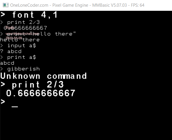

Posted: 08:48pm 08 Mar 2022
Just got some time to play with this (03.b5), and it seems that there's something with fonts: in command line, as soon as I enter something invalid the font reverses to default:
