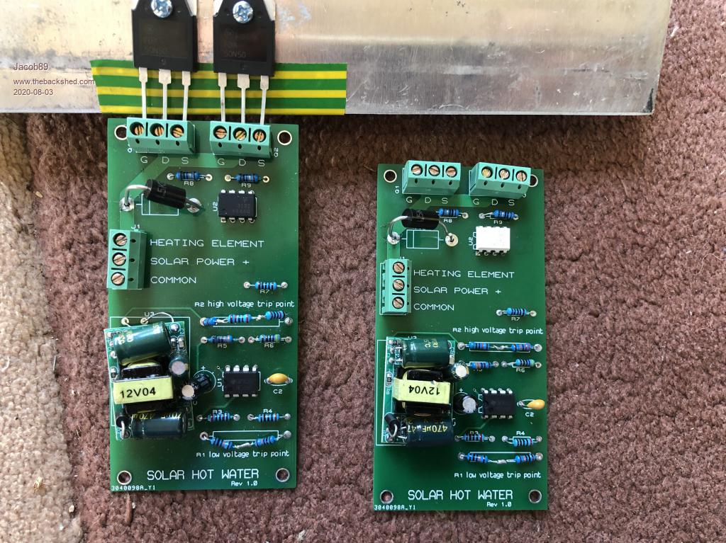

Posted: 06:33am 03 Aug 2020
I finally got enough bits today to put together a couple of units but no luck getting them to run properly.
I was just using a 2kw kettle for a test element and a string of 8 250w panels. 14 470uf capacitors salvaged from an old grid tie inverter.
I didn't have any 1 w carbon film resistors anywhere near the right rating so I put some 1/4 watt metal film in series to get the values for setting the high and low voltage trip points.
I used FDA50N50 mosfets, and also tried some salvaged APT50GN60BG IGBTs. The IGBTs seemed to just be hard on.
A few strange things happened:

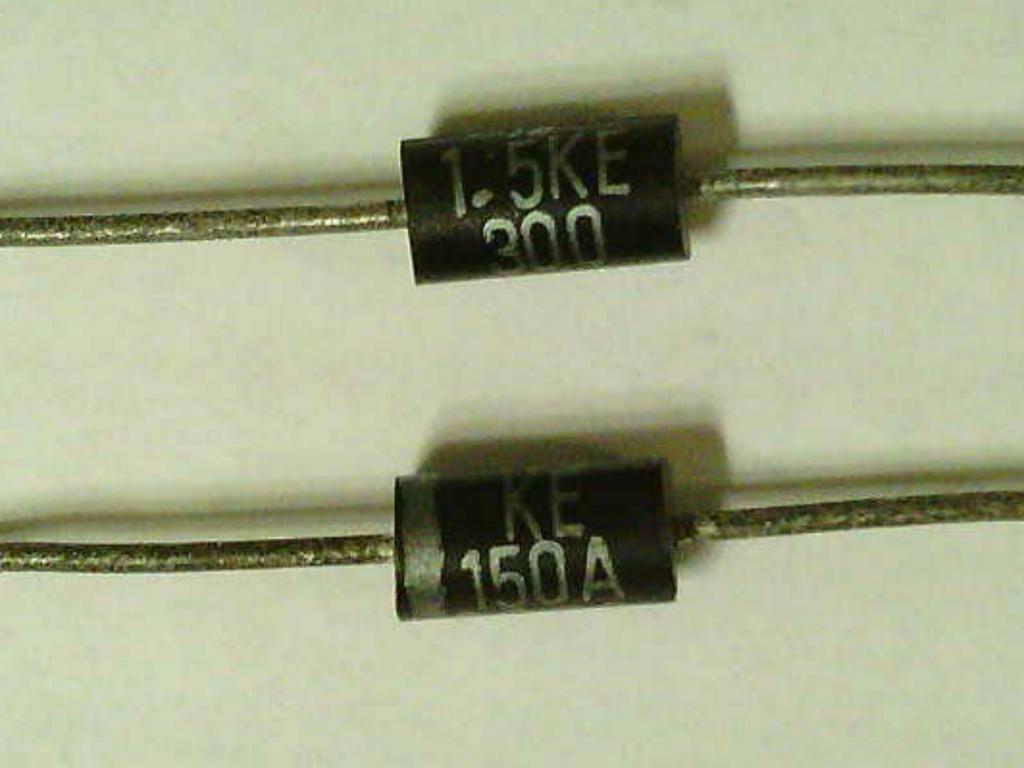

1. Does the TVS diode need to be bi directional, unidirectional, or does it matter either way? I seem to have ended up with unidirectional ones. They don't have any polarity markings on them. On one of my units I burnt up two of them, they seemed to just start conducting and the element was powered through them until they let the smoke out.
I ended up taking them out of the circuit to continue testing.
2. Couldn't seem to get either unit to do any switching, except by accident. The capacitor bank would charge up to the maximum array voltage (270v) and stay there.
Measuring voltages at different points on the board, I accidentally found that when I put my multimeter between the Solar + terminal and the midpoint of the high voltage trip point voltage divider it would start switching the mosfets and powering the elements. I don't think it was switching as intended though, although it was difficult to tell exactly what was going on.
Has anyone else gotten one of these working? I'm a bit out of my depth with fault finding on this sort of thing.
Edit: You'll notice I'm using two different 3182 driver chips. The black ones came from aliexpress and the white ones are more expensive ones from Mouser. I had better luck with the black ones though so far.
Edited 2020-08-03 16:42 by Jacob89

Posted: 09:45am 03 Aug 2020
The transient voltage suppressors come in two different styles, and both will work in this circuit.
I just went out to the shed and grabbed one of each type.
The first is a 1.5KE 300, and its a 300 volt ac type that works exactly the same in both directions. Yours appear to be like this, so it can go onto the board either way around.
The second example is a 1.5KE 150A. This has both the A suffix, and a clearly marked polarity band indicating its the dc type.
This type MUST be installed the right way around with the band as shown on the circuit board.  It would clamp at anything above 150 volts in the forward direction, and act as an ordinary diode in the reverse direction.
If the dc type is connected the wrong way around, its like placing a conducting diode right across your solar panels, and the several amps of short circuit current that would flow, would quickly burn it up.
Quarter watt resistors will work perfectly well for initial testing, but if they get wet or dirty over time, may cause long term reliability problems simply because they are so small and can suffer from electrical leakage, or even break down over time fairly readily.
Now the mosfets should turn on at the upper voltage threshold, and cause the load to pull the voltage across the electrolytic down to the low voltage threshold, where the mosfets are supposed to then turn off.
Several things can go wrong with this if the voltage thresholds are inappropriate, or if the load is insufficient, or solar is excessive compared to the load (same thing really).
The solar panels must be able to charge the capacitor right up to the upper voltage threshold. That may not happen if either the threshold is set way too high, or its a grey day and there is just insufficient solar, as in twilight conditions.
Once the mosfet turns on, the load should pull the capacitor voltage down in voltage to the low voltage threshold.  That can go wrong too.
If the voltage threshold is set way too low, or there is insufficient load, the voltage may not fall low enough to switch the mosfet off.  So the load just locks on continuously.
If it goes up to 270v and stays there, set the upper trip point lower. Try a 220K or 180k resistor for the upper trip point. Anything higher than about 270k is just not going to turn on the mosfet.
Posted: 09:53am 03 Aug 2020
Dave, pack it up and mail it back to me.
Chances are pretty good something has died on the board.
There is not that much there to fix, so its going to be pretty easy to locate the problem.
I don't have any spare boards here, I ordered only five and sent you the lot.

The TVS I have is a 1.5KE400CA. I don't know what the C indicates but the A would still indicate its the DC type? Odd though, considering there is no polarity band.
I Googled "1.5KE400CA data sheet"

At the top left of the data sheet, under "mechanical" it says:
  Quote  Marking : Unidirectional -type number and cathode band                      Bidirectional-type number only
There are two versions, 1.5KE400C which is the bi directional ac type, and 1.5KE400CA which is the unidirectional dc type (and should? have the band).
Try a 220K for the upper set point resistor.
Try 100K for the lower set point resistor.
That should get it to switch on and off. Once you have that, experiment with the set points so they are either side of the actual maximum power voltage.
