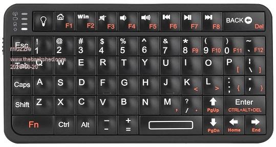

One more observation / minor niggly issue:
Would it be possible to get info on the Bluetooth keyboard / mouse connection in the PicoMiteBTH build? Could this then be used to force a re-connect to the same device?
I have a few Bluetooth keyboards that can connect to the PicoMiteBTH, as sods law would have it, the cheap crap ones re-connect every time either the PicoMite or keyboard is power cycled, however the better quality Rii unit I want to use needs to be re-paired on every power cycle. Not a big problem in the larger scheme of things but the position of the switch requires the keyboard to be removed from a prospective device to re-pair.
This is the unit that does not re-pair: (Rii518bt)
Thanks again.
Regards, Lyle.
Footnote added 2026-09-20 17:24 by mozzie
Just tested on PicoMiteBTH060302b12 and its only power cycling the Picomite that causes the problem, power cycling the keyboard it re-connects OK.

Mozzie I have been trying to get a K250 BT keyboard going but claude for some reason refuses to setup the 6n so the K250 can pair. Now with BT mouse sometimes it does connect on boot and it has a 40 second delay before working, just did a reboot and 40 second later the BT mouse worked.

This keyboard and most others tested seem to connect to PicoMiteBTH in around 6 seconds for initial pairing and a couple of seconds after that. As far as I can see if they don't connect within 10 seconds it doesn't matter how long you wait. YMMV.
Considering you are on the Python build it may be more the host end rather than the device, perhaps it does a full scan or something, well beyond my knowledge of Python I'm afraid   , struggling enough keeping up with MMBasic, only AI used here is Aussie Intelligence (this version is quite slow at times)
