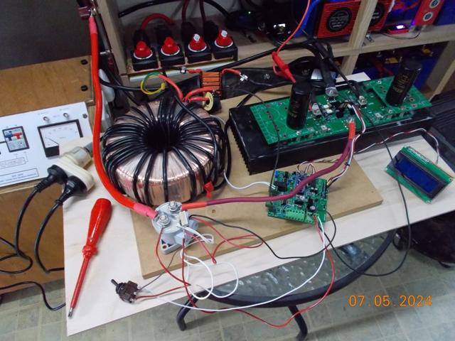

I though I had posted this, but no - crap test setup for the last post above.

For anyone interested, the Nano controller is now running in my main inverter - I had the property running off grid on it for a few hours this afternoon in the testing phase, only up to 4kW though, I ran out of time today and hopefully I will finish the conversion tomorrow.
I really miss the Peak input current meter that was on the V5 SYM controller. I have a small board I made when designing it initially, and I really need that back in with a connection for Peak DC-OC to the Ext OC pin on the Nano controller board.
I'm pleased to report that noise is again not an issue for the nano controller - all LCD readings are as expected, and the startup shutdown and error tripping is perfect - it actually saved the Inverter when I had one lead back to front - and the LCD error info was 100% accurate, I knew exactly what I had done.

  wiseguy said  Sorry mike polluted your thread - I thought this was my thread lol.  And now I've written this I cant even delete it so I will copy the Variac portion to my thread.
Mike, any information about the Nano or Variac is 110% welcome here. Thanks for the post.
Klaus, R1, R9, R5 and R13 are Zero ohms in both my inverters. Either a link or an R0 resistor.
Edited 2024-05-15 08:25 by KeepIS
Murphy's friend
Joined: 04/10/2019
Posts: 678
Posted: 03:50am 15 May 2024
Thanks for explaining the gate resistor question. I'll try to short the 10R when I next tinker with the driver board. The 1R directly at the gates is on the power board I will leave that - too hard to get at easily.
