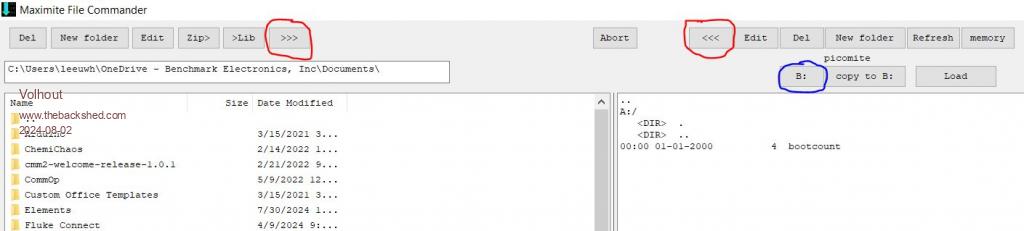

In MMEdit / MMCC select Mode --> File Manager.
In the C:\ pane (left) navigate to the file, highlight it then click ">>>" button and it should be copied to the right pane A:.

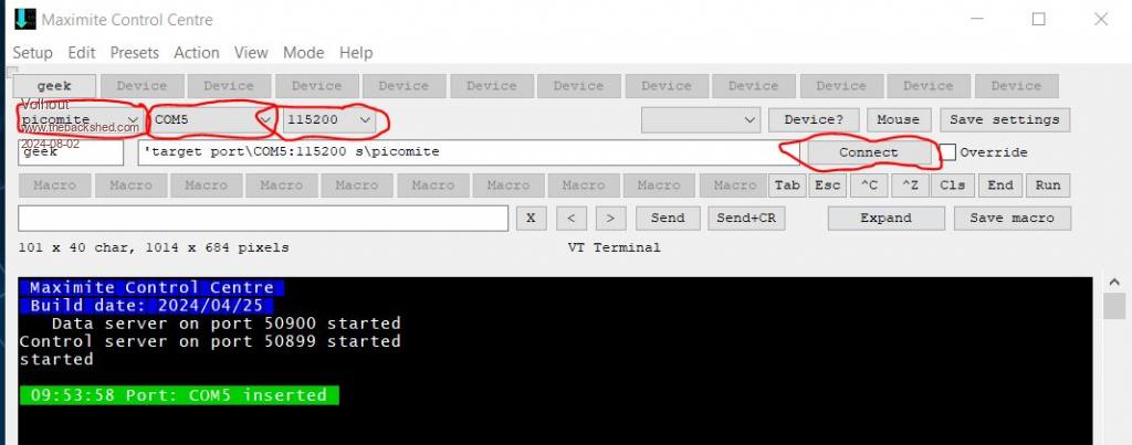

When you have installed:
- open MMCC
- select COM port
- Select PicoMiteVGA (or PicoMite)
- Press "CONNECT". In the text field a green message is shown that it is connected.
Then open the file manager
- press MODE
- select file manager
You can select files, and using the ">>>" and "<<<" buttons copy them. Change the drive with the blue button (A or B on PicoMite) Right side is the PicoMite, left side is the PC.
When done, close the file manager.

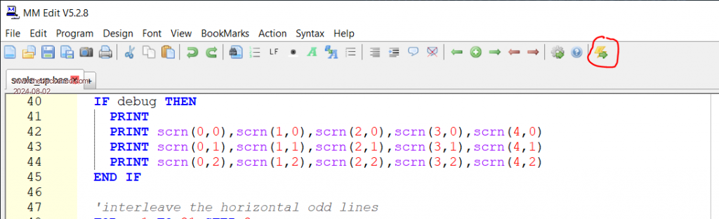

If you want to modify or create a program you can open MMEDIT, the opening, editting and closing of files is very intuitive. To run the program on a connected PicoMite, you press the rightmost icon. And it is automatically copied to the Mite (using MMCC) and run.
