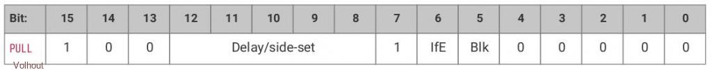

Chapter 10: Shift out data from OSR to a 74HC595 shift register
Serial peripherals can extend the functionality of a microcontroller. Such devices can be DAC's (digitial to analog converters), shift registers, but also ethernet chips. The PIO can assist in communication with these devices. For most, if not all, of these serial protocols, the OSR (Output Shift Register) is used. This is the output equivalent of the ISR (Input Shift Register) we have used in several earlier experiments.
Of coarse we need to write data into the OSR before it can shift data to the peripheral. The data path looks like this:
MMBasic ---> Output FIFO ---> OSR ----> GPx pins.
To get data into the output FIFO we use the MMBasic PIO WRITE function.
PIO WRITE a,b,c,d
a/ the PIO (in out examples PIO 1)
b/ the state machine (0...3)
c/ the number of 32 bit values to write (1..4)
d/ the integer variable that supplies the data (can be an array in case multiple 32 bit words are send).
Once the data is written in the FIFO the PIO can fetch the data using the PULL instruction
The PULL instruction has a few flags and a delay parameter.
DELAY/SIDE SET : we have discussed this before
IfEMpty: we will not discuss this here
Block: When 1 the PULL instruction halts the PIO until there is data to pull from FIFO.
We have used the BLOCK flag in an earlier exercise where we generated the GATE signal for the frequency counter.
To shift data out to the IO pins, the OUT instruction is used. The paramaters are listed below.
DELAY/SIDE SET: already discussed earlier.
DESTINATION: "000" for PINS, "001" = X, "100" = PINDIRS, "011"=NULL (shift data lost)
BITCOUNT: the number of bits to shift out.
So it is pretty obvious to us how we can shift out 1 bit of data to pins. Use the OUT instruction, destination "000", and number of bit = 1
But there is something specific we need to do to assign a GPx pin to the OSR. The OUT instruction has it's own configuration in PINCTRL.

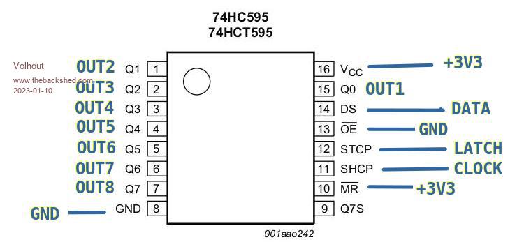

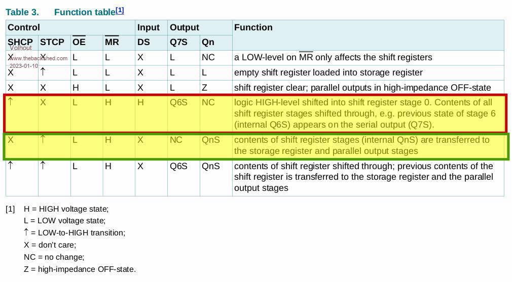

To explain how these puzzle pieces fit together we will explain using a concrete application: sending data to a 74HC595 shift register..
Similar to chapter 9 we will use the datasheet to determine how we can send serial data to the chip. The 74HC595 contains a set of 8 shift in registers, shifting happens on the rising edge of the SHCP (CLOCK)signal. The input data must be supplied to the DS (DATA) pin. Once all 8 bits are clocked in, the data is latched (frozen solid) into the 8 output registers at a rising edge fo the STCP (LATCH) signal.

Above information results in below connection diagram for the chip.

It must be said that there is no explicit requirement for the LATCH and CLOCK to become low again as separate instructions. But for clarity here we do so. Also note that we store the value 7 in the counter. For this register we need to provide a clock pulse to get data in the first shift register. So for 8 bits we need 8 clocks.
Let's assign GP pins: CLOCK = GP0, LATCH = GP1, DATA = GP2
GP0 and GP1 will be controlled from SET instructions, GP2 from the OUT instruction. So this gives following configuration(see above):
PINCTRL 0,2,1,,,GP0,GP2

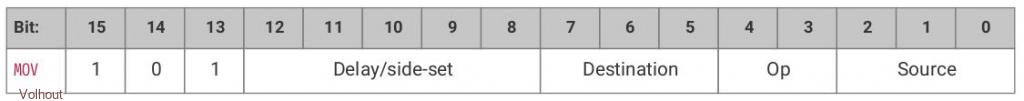

OUT pindirs 1 = 011 00000 100 00001 = 0110 0000 1000 0001 = &h6081
But we can only shift a logic "1" out OSR when there is a logic "1" in OSR. So first we have to program OSR with a "1". That may not be easy, but we can (in 1 instruction) fill OSR with all 1's, by MOV'ing an inverted NULL in it.
DESTINATION: "111" = OSR
OPERATION: "01" = INVERT
SOURCE: "011" = NULL
MOV -NULL-> OSR = 101 00000 111 01 011 = 1010 0000 1110 1011 = &hA0EB

Re load pulse (Storage Register Clk, STCP). I misunderstood the datasheet. Thought that a separate pulse was needed for each bit. I was in fact reloading the 8 databits 8 times. After the Shift Register is loaded, one load pulse (STCP) is enough to transfer all bits to to the storage register and the outputs.

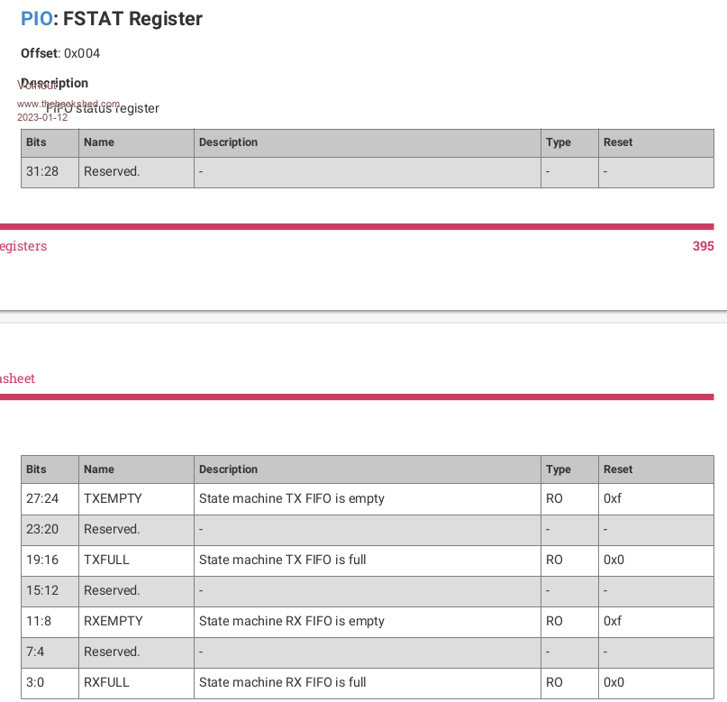

Some additional information for exchange of information exchange between PIO and MMBasic.
MMBasic has a function that can check the status of the FIFO's:
b% = PIO(FSTAT a)
a/ the PIO number (0 or 1)
b%/ 32 bit variable that holds the 16 flags of the FSTAT register.

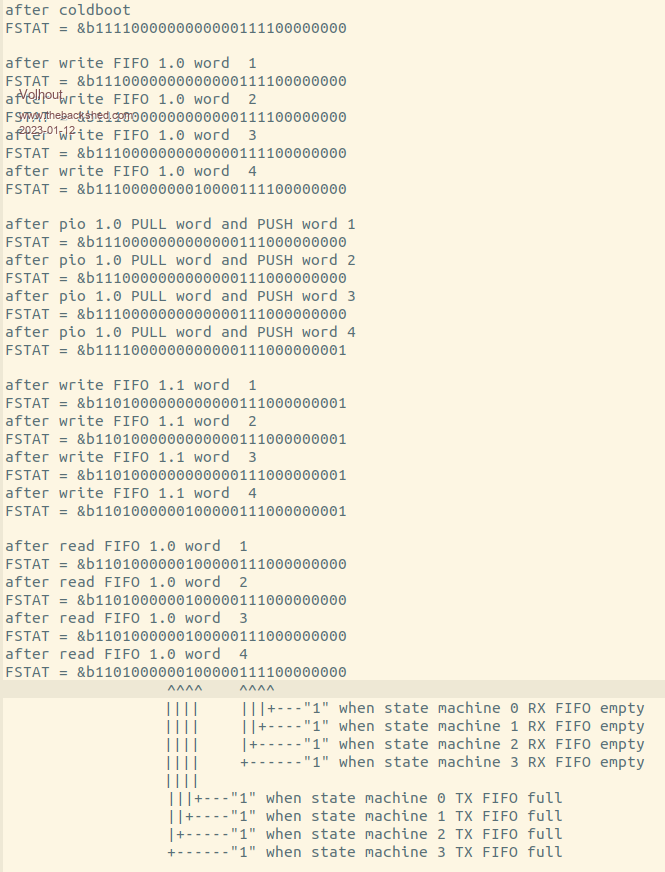

I wrote a small program that writes and reads data from the FIFO's to check the behaviour of the flags in FSTAT.
'Check flags in FSTAT register for flow control
 dim d%=&hAA55AA55
'configure pio1
 p=0                                   'not used
 f=1e4                                 '10kHz
'address    code    mnemonics         comment
'  0      2000      WAIT GP0=0
'  1      2080      WAIT GP0=1
'  2      8080      PULL noblock
'  3      8000      PUSH noblock
'  4      0000      JMP 0
'PIO clear
pio clear 1
'program pio1
 pio program line 1,0,&h2000
 pio program line 1,1,&h2080
 pio program line 1,2,&h8080
 pio program line 1,3,&h8000
 PIO program line 1,4,&h0000
'write the configuration
 PIO init machine 1,0,f,p,,,0
'Halt the PIO from GP0 from MMBasic
 setpin gp0,dout
 pin(gp0)=0
'start the pio1 code
 PIO start 1,0
'check FSTAT behaviour when writing and pulling data
 print "after coldboot"
 print "FSTAT = &b"+bin$(PIO(FSTAT 1))
 print
 for i=1 to 4
   pio write 1,0,1,d%
   print "after write FIFO 1.0 word ";i
 next i
 print
 for i=1 to 4
   pin(gp0)=1:pause 10:pin(gp0)=0:pause 10
   print "after pio 1.0 PULL word and PUSH word";i
 next i
 print
 for i=1 to 4
   pio write 1,1,1,d%
   print "after write FIFO 1.1 word ";i
 next i
 print
 for i=1 to 4
   pio read 1,0,1,d%
   print "after read FIFO 1.0 word ";i
 next i
end
There are 8 flags that sound usable to me:
4 flags (one for each state machine) that show when there is data in the FIFO's to read from MMBasic:
RX_FIFO_empty = 1 , not empty = 0
So at a logical zero, you can read data from FIFO
4 flags (one for each state machine) that show when you can write data to the FIFO because it is not full.
TX_FIRO_full = 1, not full = 0
So at a logical zero, you can write data to FIFO

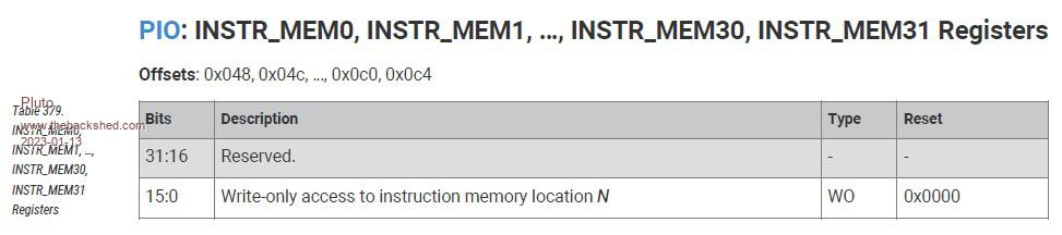

PIO DEBUGGING.
I tried to find a way to read the PIO program instructions from the program memory.
Did not find any direct way to do it. Noticed however that there are two registers from which it is possible to get the latest instruction number and instruction.
"Current instruction address:"  HEX$(PEEK(WORD( &h503000d4)))
"Current state machine instruction:"  HEX$(PEEK(WORD( &h503000d8)))
First attempts to read these registers while PIO was running caused problems due to the fact that during the time you read one of the registers PIO might have already moved to the following. For this reason the PIO is stopped before reading both registers and restarted afterwards.
Low PIO frequency makes it easier for MMBasic to catch the PIO instructions.
Run the program and stop it after a while when you see that it has got some fish in the net. Then run the PrintProg subroutine from console and you get a proper(?) listing of the program running in the PIO.

The pio program is memory mapped in the ARM memory map. Check the list of PIO registers in the RP2040 datasheet, and you will find all 32 memory locations. A simple set of 32 successive peek(word address) will list the whole pio program.
But nice, you made a start for a disassembler..good
P.s. would you be willing to look at Mixtels PASM pio assembler. It worked in earlier versions of mmbasic, but needs some debugging in current.

Pluto
Joined: 09/06/2017
Location: Finland
Posts: 418
Posted: 05:23pm 12 Jan 2023
@volhout.
Wish I asked about the program
memory before!

I hope you did not mean these.
Write-only access to instruction memory location N.
I have tried to read, but all I get is 0.
I did not find any other locations.

Posts: 6197
Posted: 10:36pm 12 Jan 2023
@pluto, i didn't see they where RO.
Sorry
@disco4now: good find, peter may use that to clear them.
