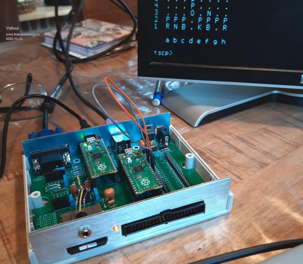

Posts: 6185
Posted: 08:45am 23 Oct 2022
@Peter,
The basis is working: 2 pico's (one with your chess engine, the other a VGA picomite) on the 1.7 board. On the 3'rd socket I have connected COM1 of the chess module to COM2 of the picomite.
I use a small terminal program to route COM2 on the picomite to the console.
'setup COM2 to communicate with chess module
SetPin gp5,gp4,COM2
Open "COM2:115200" As #1
'keyboard text to chess module
 a$=Inkey$
 If a$<>"" Then Print #1,a$;:Print a$;
 If a$=Chr$(13) Then Print
'feedback from chess module
 l=Loc(#1)
 If l>1 Then Print Input$(l,1);
Loop Until a$=Chr$(27) 'stop when <ESC>
The christmas project is to show the ASCII board (command "d") in graphics on the VGA screen, and provide a command interface for the player.
It plays fast.... reponse in seconds, versus minutes...
Thanks, and I'll post my progress on this thread.

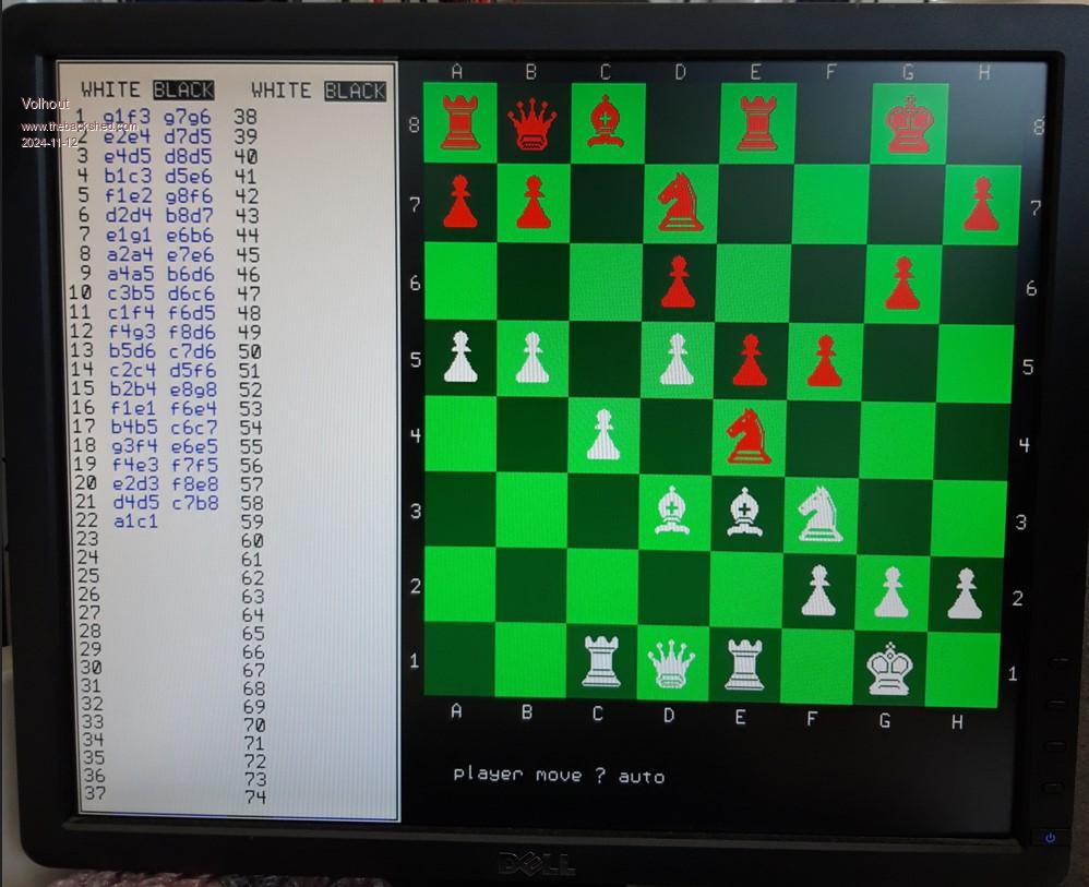

Posted: 09:40am 12 Nov 2024
Kevin,
Finally picked up the dual pico chess project again.
It is far from finished, but can play a decent match already. Runs in 640x480 on the PRP2040 VGA.
The second pico runs Peters compiled TSCP (2 posts back). Its useds UART at GP0/GP1, and is wired to the UART on the first pico at GP4/GP5. Since this TSCP pico is very sensitive to typing errors I pre-process every command in the first pico.
In auto mode it plays itself.
Edited 2024-11-12 19:45 by Volhout

Posts: 6185
Posted: 06:48am 13 Nov 2024
Peter,
The earlier code does not echo.
When I get home this weekend I will have access to a pico2 again. I will try it.
500 MHz…?
But honestly, the earlier version was pretty fast already, a 70 move game lasted 2 minutes, that is 1,7 seconds per 2 moves (black and white). I may have trouble keeping up with displaying the board, which is quite clumsy currently, because the sprites are smaller than shown.

Posted: 07:53am 13 Nov 2024
  Volhout said  I may have trouble keeping up with displaying the board, which is quite clumsy currently, because the sprites are smaller than shown.
Harm,
if you need a new set of sprites for the figures, just let me know
Martin
