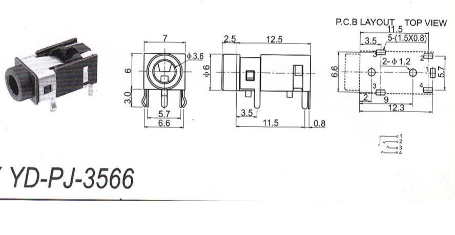

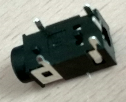

The audio jacks I ordered aren't quite right, there is an extra pin at the back (?) and the other pins aren't quite aligned with the PCB, though there is some mechanical give so I expect I'll be able to bodge it one way or another:
  Mixtel90 said  Up to 10 minor PCB fixes and minor enhancements for the next version. No problems (so far) will prevent the current version from being built though.

Posted: 10:58am 11 Apr 2022
  Mixtel90 said  Better check the connections on that socket, Tom, it may not work out the same. What make/model is it?
Good catch, not the same:
I'm guessing since it seems to have 4 independent pins it must be a "4 pole combine" with Mic.
My reading is that Pin 1 is Ground, Pin 2 is right, but is it pin 3 or 4 that is left ?
Assuming I can just leave the Mic disconnected (or GND it ?) then I might still make this work with bent pins, bodge wires and insulation tape.

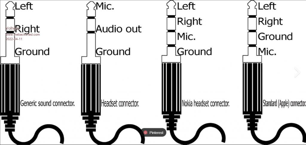

Posts: 6197
Posted: 11:22am 11 Apr 2022
1=gnd (depending apple of nokia standard mic or gnd)
4=gnd (depending apple of nokia standard mic or gnd)
3=left (tip)
2=right
Posts: 4405
Posted: 11:35am 11 Apr 2022
Thanks Volhout, it appears to be the port for a Nokia headset connector - unless I've got my head on backwards that can be bodged into Mick's PCB without too much difficulty.
What should I do with the Mic pin ? - ground it ?

Posts: 9238
Posted: 11:53am 11 Apr 2022
I *think* the connections to that socket would be:
1 - Tip - L
2 - Ring1 - R
3 - Ring2 - GND
4 - Sleeve - GND
It should be signal compatible then.
Mechanically the best way might be to:
Cut off the plastic locating pins
Bend up pin1 (the odd one) to isolate it. You'll need to wire link this to GND later.
Mount the socket on the *bottom* of the pcb.
Wire link pin1 to the GND connection to the north - towards R36.
I think it'll work now, but R & L will be reversed.
Alternatively, mount it dead bug style on the top of the board, but you'll need to insulate it in some way.

Posts: 6197
When you ground the MIC pin you are sure that whatever headset you plug in (apple or other) you get stereo sound.
When not, you can only use certain mfgr headsets as earphones.
