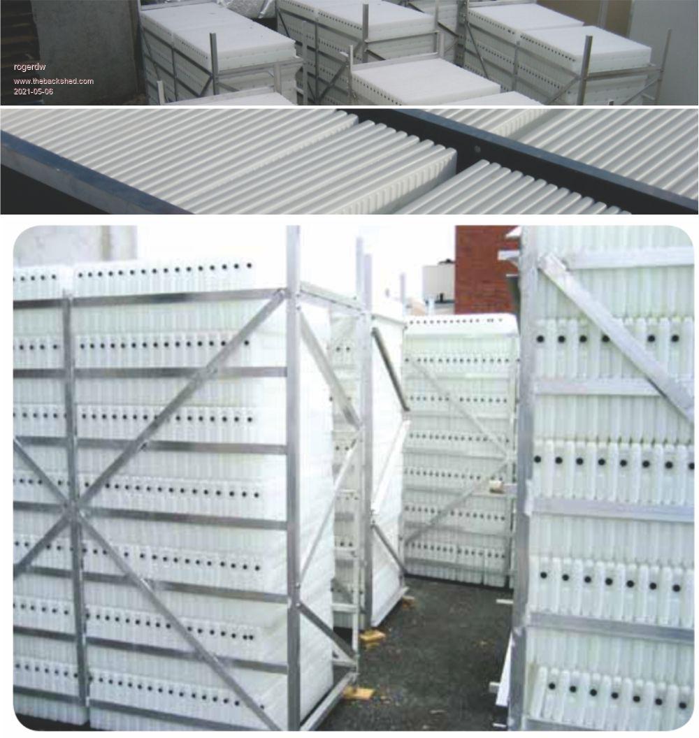

  Davo99 said  Is there a specific type of PCM you would use or is readily available?
There are a number of commercially available products that can be bought at great price.
There are some that come in big sheets with capsules of the PCM  ...  look like large versions of strips of tablets or capsules you get from the chemist.
These can lay on the ceiling under the insulation, in the walls or under a wooden floor.
Here's a quick visual plus an overview
This article also suggests that "In Australia, expect to pay between $55 and $110 per square metre for PCM"
You can also buy containers of the stuff  ...  like 860 x 470 x 27mm  ...  which can be stacked to create a large mass. Like large versions of our freezer cold packs.
Some has been packaged into tiny plastic balls that can be used in concrete or in wall cladding.
PCM's can be made from various salts, or paraffin wax, or even various mixtures of oils like coconut oil.
Almost sounds like DIY  ...  but when you look into it, it seems either complicated or just expensive to buy the raw materials. And of course they frighten you with suggestions of fire risk and costs of doctoring it to make it safe.

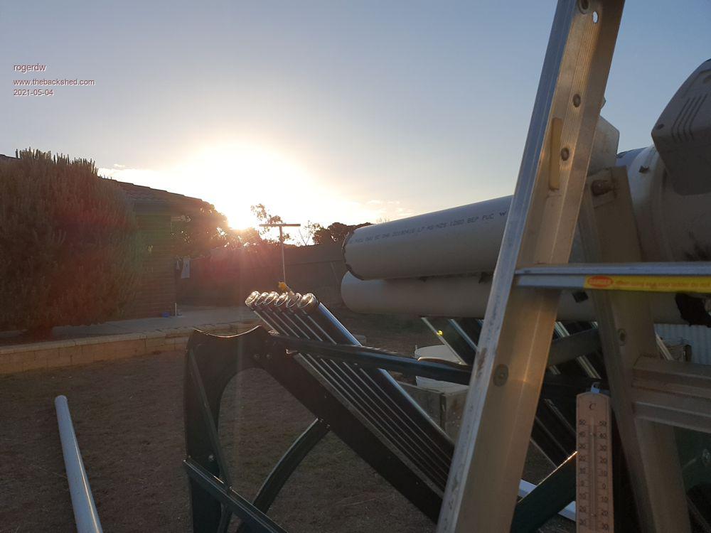

I learned two things from experimenting today.
After talking to the PCM guy I was trying to work out what sort of improvement going to 18 tubes would make. Could I get up to 40 degrees?
Rather than trying to add another 6 tubes to my existing 6, I decided to cover over 3 tubes to halve my array and see what happened.
The temp dropped from 26.7 down to 24.6 over about a minute.
Then I removed the cover and it took three minutes to get back to 26.7
The second came after I did the school run and had the fan off for nearly 2 hours.
At 4.48pm the temp in the outlet manifold with no fan on was (coincidently) 26.7 degrees still  ...  though at that time the sun was way off to the side and quite low.
(this heat comes from the warmth rising from inside the tubes and hanging in the manifold)
Turned the fan back on   ...
4:48  ...  26.7
4:49  ...  53.3  ...  took 1 minute to climb to this
4:50  ...  52.6
4:51  ...  47.5
4:52  ...  43.5
4:53  ...  38.1
4:54  ...  35.3
4:55  ...  31.4
4:56  ...  29.1
4:57  ...  27.3
4:58  ...  24.9
4:59  ...  23.1
If you check out the position of the sun at 4:50  ...  clearly it can't be providing much energy to the array  ...  so all that heat that took 10 minutes to draw out must have been added over the previous 2 hours. The tubes are a great storage device.
So to get higher temperatures, I need to add more tubes, slow down the fan  ...  or turn off the fan intermittantly to give the tubes a chance to catch up.
Sun position at 4:50pm
Cheers,  Roger

  Quote  Now with PCM  ...  I could put a box in the corner of my lounge and fill with PCM modules and feed my hot air through them to warm them up.
So this stuff comes in different forms like bricks or something other than like flat Rolls? That was what I was trying to get my head around. The physical packaging as it were.
In this photo below I reckon these are the ones that are 860 x 300 x 27mm
$30 each and supposedly good for 400 watts of stored energy.
I did ask how long the 400 watts lasts for (as in Whr or kWhr) ...  but that seemed like an odd question to him.
Like it's not going to provide 400 watts forever, or a day  ...  maybe it is for an hour  ...  .4kWhr  ???
I suppose 10 of them for $300 would then be 4kWhr  ...  and 30 would be $900 for 12kWhr
If they are as good as I believe them to be, I'd pay $900 to try them out.
Cheers,  Roger
They appear to have hollow passages to circulate air though. That will be perfect for your application!
First thought was to compare the amount of water it would take to store that energy at something remotely relevant to your purpose. It would take 10L of water to be risen from 20 ( which would be low as you'd want it) to 55o ( high as you would practically make it) to store 400 WH of energy.
That seemed to make the PCM impressive.
Then I worked out the area of the PCM and unless my usually dodgy mats is wrong again, I came up with a volume of just under 7L.... Which does not add up with the heat storage efficiency  mentioned. I think My maths is correct and if it is, I can only assume the PCM advantage is more in it's heat capacity for it's weight rather than it's actual volume.
I can see where it would be great to hang off a ceiling but if you have a pile of the stuff and a tank of water, the PCM would save about 30% in occupied volume.
In most cases I'd suggest the weight would be a secondary concern.
I Imagine it has a heat dissipation limit but that would also depend on things like if you were blowing air across it and what the temperature differential and volume of air flow was.  Obviously going to radiate more slowly in static air than it would with a moving airflow.
That's an advantage though.  Very easy to put a fan on a cheap thermostat to blow air though the medium when  more warmth in the room is required and if it has a gentle radiation it may only require very intermittent forced air although more as the material and the ambient air temp equalised.
You are much less of a Tight arse than I am that's for sure!  :0)
For $900 I'll put a 200 drum of water in the corner and raise the temp 55o to get my 12 Kwh of storage.
It would be good to verify my questionable calculations though.  They don't seem to add up with the claimed energy density but again, maybe it's the weight that counts.
If I could pack 12 Kwh into something the size of a shoe box, that would be significant to me but the weight is not so much an advantage from MY perspective. Just going to sit on the floor and the size difference isn't significant for the room I'd put it into.  Might be different for other peoples needs and situation of course.
The other thing though is no need to worry about a leak  with the PCM but OTOH,  I could use sand as the storage medium in a drum and take it up hotter and get the same or greater energy density.
Not trying to berate the PCM in any way, It's very interesting and I'd be very interested to get some first hand info about it. I'm just making comparisons mainly from a $$ POV and comparing the advantages over my typical Low buck solution default mentality.

  Quote  They appear to have hollow passages to circulate air though. That will be perfect for your application!
Yes, they could be spaced out inside a large box and have hot air pumped through them when it's available  ...  and at night, open up the box or have a seperate fan to circulate inside air through them to warm up the room.
  Quote  First thought was to compare the amount of water it would take to store that energy at something remotely relevant to your purpose. It would take 10L of water to be risen from 20 ( which would be low as you'd want it) to 55o ( high as you would practically make it) to store 400 WH of energy.
That's kinda out of my league, I'd have to do some serious study to work all that out.
I think that's why I was so impressed with PCM when I read that a one inch thick panel can store the same energy as a 28 inch thick brick.
  Quote  I Imagine it has a heat dissipation limit but that would also depend on things like if you were blowing air across it and what the temperature differential and volume of air flow was.  Obviously going to radiate more slowly in static air than it would with a moving airflow.
Yes, exactly.
  Quote  You are much less of a Tight arse than I am that's for sure!  :0)
Haha, maybe. Perhaps I've just been sucked in by the hype. That's why all the questions.
I don't reckon I'd get away with a 44 in the corner filled with water  ...  though it could work in the workshop.
  Quote  Not trying to berate the PCM in any way, It's very interesting and I'd be very interested to get some first hand info about it. I'm just making comparisons mainly from a $$ POV and comparing the advantages over my typical Low buck solution default mentality.
Nah, I don't see it that you're having a go  ...  all good questions  ...  and I'm pretty close to king of the heap when it comes to being a cheapskate, so I've really got to be confident before I spend my money.
I decided to ask the question over on the washing machine forum about how PCM works. Will be interesting to see if anyone knows about it and can explain in laymans term so I can understand  ...  or even better has some first hand knowledge.
Cheers,  Roger

  Quote  I think that's why I was so impressed with PCM when I read that a one inch thick panel can store the same energy as a 28 inch thick brick.
I relate that comparison to marketing hype. Despite first thoughts for what many that haven't looked into this fascinating area , Brick is not that energy dense. I know that off by heart.
Looking it up, water is 4182 , Brick is only 840.... KJ/ Lb I think it was. Don't matter, in that equation, you'd only need about 5.5 inches of WATER to one inch of the PCM.  Still favourable to the PCM but not nearly as impressive in real terms to the king of thermal storage for non exotic materials, water. I suspect the comparison to brick came from some sales hype because people would naturally think of  brick as being dense and holding a lot of energy once heated. Water does better than Steel, aluminium, stone, sand and most everything else quite easily.
Only way to beat it is go above 100oC but then you have to go a LONG way above to catch up on a volume/ weight basis.
I am also getting a better handle on this PCM.  It seems the different formulations have different temp ranges at which they function. That penny didn't quite drop before.  Your input would have to be fairly specific to get it to function. You would also want to choose one that worked at a suitable " discharge" temp.
Bit involved this stuff!
And there are many questions I'd ask too.  I hope I put some of the " Hype" into perspective above.  There is no question the PCM is a more effective heat storage medium but for mine, the benefits and their importance should be weighed against the cost and particularly that of other storage mediums.
  Quote  I don't reckon I'd get away with a 44 in the corner filled with water  ...  though it could work in the workshop.
Thats just the packaging. You could have an ordinary water heater tank outside and just duct the air through a heat exchanger from the tubes in the day and from the tank into the house at night.
The question that comes to my mind is how and where you going to set up the PCM?
Slabs of 800 x 300 or whatever aren't exactly small and Inconspicuous either so I'd suggest where you locate them could also be possibly used to situate a water storage tank even if it was bigger.
Might be that you can get away with a 50L tank for the energy you will generate.
The difficulty I see in all this is the energy potential is not at all constant. The energy needs won't be either so it's not going to be an easy equation to work out.
Not meaning to shove my idea down your throat but I would suggest maybe using something like water may be a good idea initially at least till you work out in practical terms what you do and don't need storage capacity wise. No use spending more on PCM than you need or finding some other bug in the system that may bring up difficulties no one foresaw.
At least with water you can get your numbers and then get the Right pcm you need and the right amount.  Testing with the cheapest option  to figure out what the final requirements are to me would be wise.
Think about using water ( or sand or brick or whatever is cheapest) as a test medium to get your numbers and then spend the money on the final solution you know you need.
  Quote   and I'm pretty close to king of the heap when it comes to being a cheapskate, so I've really got to be confident before I spend my money.
That's only smart and Intelligent.
The way I see it there are 2 parts to this system, the heat generation and the storage.... and maybe the distribution.  In any case the generation and distribution will be the same regardless of the storage medium.  Get the generation working first, measure it and get some Numbers then add the ( cheap) storage system, work out your numbers again and then build the final iteration from there Knowing you are close to the mark as you can be without spending the big bux.
