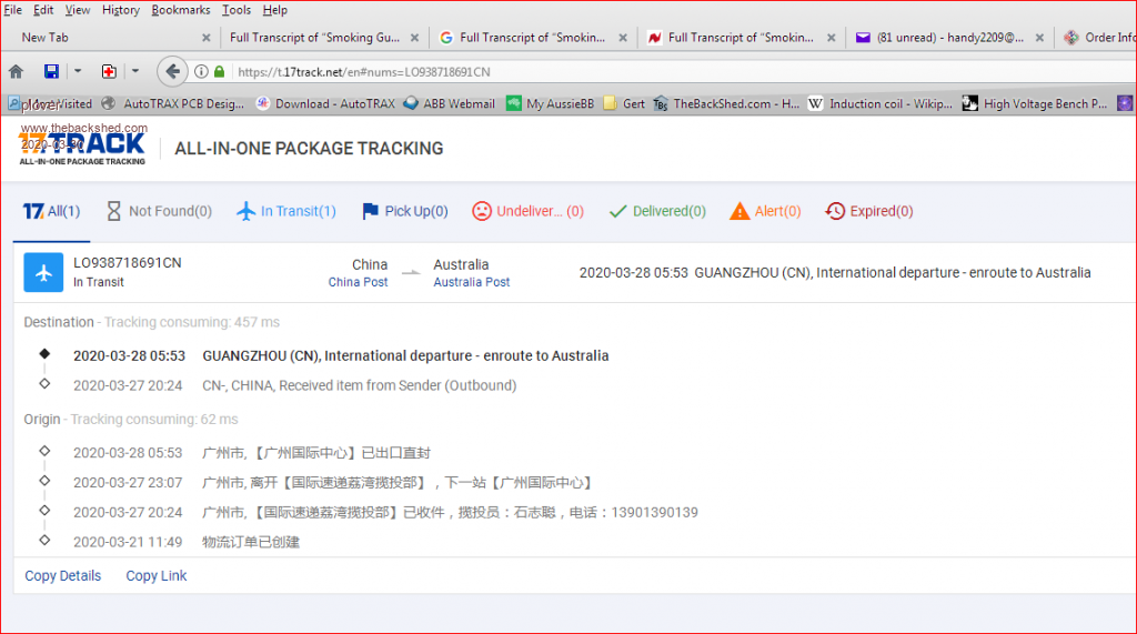

Just an update on dropping Warpseed's zip file in the 'letterbox' at ShenZhen2U
Looks like it has worked, ie I need not change file extensions. This seemed to be an obstacle.
WIll be interesting to see when they arrive some time. The parcel has been in transit in China for a couple of days according to the tracker.

Update on my boards from ShenZhen2U I have looked at the tracking having chosen E-Packet shipping it looks like this may be China-Post as well I think it is coming airmail
