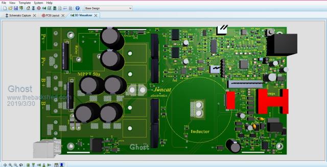

Hi all , I appreciate the good works you guys are doing, this is my own designed mppt 50a , max input 150v , currently sourcing the materials to build it ..

Based on arm processor . Auto battery 12v to 48v

Nice, what sort of relay are you using for PV isolation, I did have a good look but could find nothing suitable to withstand the high voltage and compact enough to fit on a PCB.

40a relay, but in this design, processor gnd is isolated from buck gnd, I suffered system freezing when I was using pic microchip, so I decided to isolate this present design, but do you have any idea why chargers freezes up in high current (42a) precisely.

Can I see the PV isolation circuit you are using, am using relay, but most times on high solar volt relay creates noise to the gnd. which is bad for most chips, so I limited to 150v input, but 120v practical.Edited by Ghost 2019-04-02

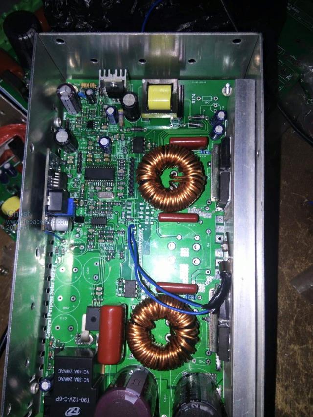

My mppt , based on pic, 40a recorded so far, very stable.. I handle over volt issue in this by switching off the pwm pins immediately output reaches 59v ..

Well done that looks excellent, are you using two buck inverters there combined to single output. The coils look quite small.
I haven't decided on a final buck inductor, will pick the best on test, but at 100 amps it will be quite large, thus the reason for not mounting on pcb.

That's 33mm inductor, interleave 180 degree phase, combined to single output . though it's fan cooled at current above 20a ..
