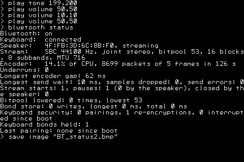

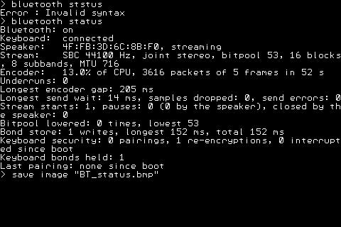

Ok so today's fun has started
flashed the last uf.2 posted and the first thing I do with a new flash

Some further testing today has proven the hypothesis from your previous post, with Option Audio Bluetooth 0 the M12 speaker works on first connection and reconnection every time. The speaker does not appear to have a sleep mode but does re-connect when the mode is cycled.
Please see attached ZIP file for Bluetooth status reports.
BT_Status_M12.zip
Also re-tested the AX1801 car stereo, this is still dropping audio briefly approx every 3 seconds. Car stereos might be a challenge as they are mostly configured to work as handsfree as well, not sure if this is a factor.
This is tested using PicoMiteRP2350BTH with ST7796S LCD panel attached, this works fine with the Bluetooth dongle and M12 speaker.
Regards, Lyle.
