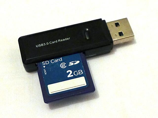

hi Peter,
   an interesting idea came up in discussions:
given USB HOST mode being available, does the picomite even need to have an SD slot taking up 4 GPIO pins? instead, a USB to SD adapter could be used to gain the same functionality:
or even simpler, just plug in a USB flash drive - so the SD card slot on the front of a picomite would be replaced with a USB socket with a stumpy USB flash drive plugged in. as an added bonus, this would also mean users would no longer need to find an SD to USB adapter if they wished to plug the flash storage into their PC.

Posts: 6192
Posted: 04:15pm 31 Jan 2024
Supporting keyboard, mouse, controllers (hid) is completely different from memory devices.
I guess we will loose all flash slots when these libraries are added.

Posts: 2552
Posted: 04:30pm 31 Jan 2024
  Volhout said  Supporting keyboard, mouse, controllers (hid) is completely different from memory devices
valid point - does anyone know what the code overhead for including MSC support in TinyUSB is? i'm picking it will not be enormous (<50k), and the cost may well be worthwhile when compared to gaining back 4 GPIO pins and achieving potentially better flash storage performance.
