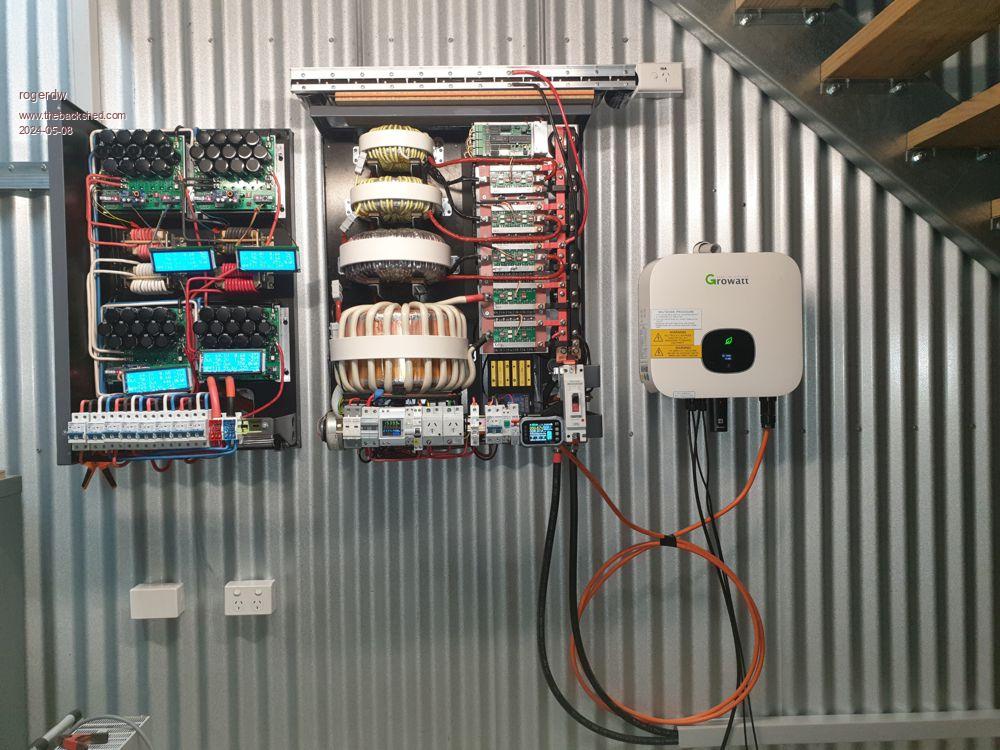

In the picture, the extra gear on top of the Warpverter is a dozen 47,000uF 63v elctros added in parallel to the main ones to increase overall capacitance. Tony was keen to see me add more to see if that would reduce some of the humming and buzz with the electric blanket and whenever the GTI runs. That makes it a total of 846,000uF!!! Should add a few more to make 1Farad  ...  except I don't have any more.
Oh, and it hasn't seemed to make any noticeable difference.
And I do need to tidy up the wiring between the Growatt and the Warpverter  ...  just need the next size up cable  ...  plus hide away the DC-In leads.

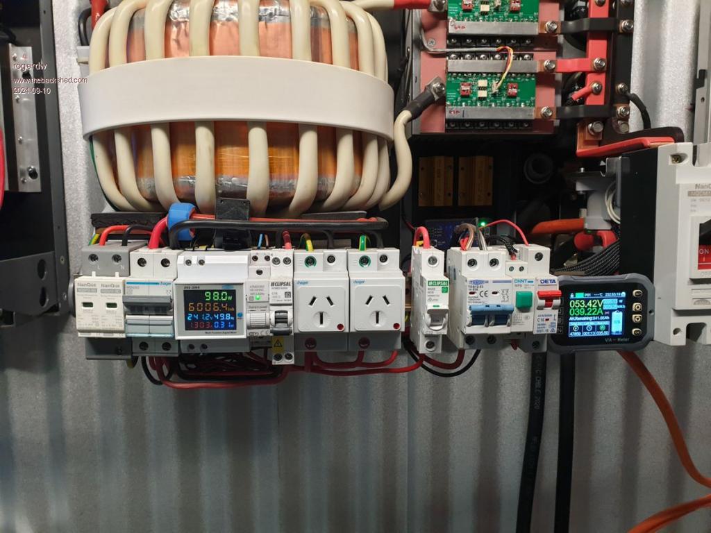

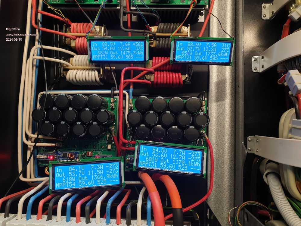

I thought it was time for a bit of an update after noticing the Warpverter clocked over the 6,000kWh mark some time today. It's been behaving well and I have just been leaving it alone.
It was officially installed on 6th of March, so it's been in action just on 6 months.
Still have to make a main cover for it and for the charge controller box too!!!
Combined, the 4 x MPPTs have clocked up 5,946.3kWh  ...  thanks Poida, Nick and Mike.

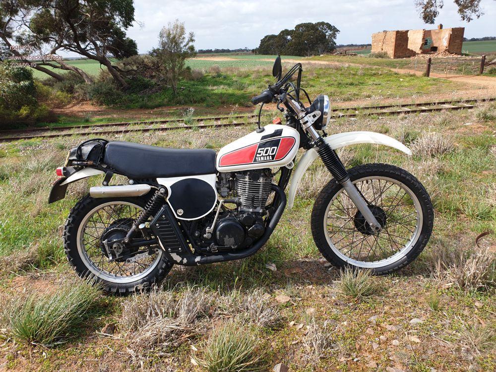

I've also been working on a generator system with a home built 1.7L 4 cylinder diesel "PN" Mazda motor and a 13.2kVa 3Phase Dunlite generator. I bought it 3/4 finished but it hadn't been run in 12-15 years so were a few issues.
I still have more to do to it, though I'm getting closer. I have a 3Phase 115A forklift battery charger, so I plan to use that any time the weather is unkind.
I had a nasty cold a month or so ago and it's taken me a while to get back into things  ...  in fact I realised I was sick of working on solar and all the associated stuff ...  so I decided to drag one of my old bikes out of mothballs.
I did a heap of work on it and finally took it out on the road for the first time in over 20 years. Nice to do something different occasionally.
Cheers,  Roger

Nice to see that your inverter and chargers are still working reliably
Mine have also been working continuously for many weeks, but we have to wait for a four-digit result.
I don't know much about motorcycles, but yours looks old school. Yamaha makes great motorcycles and musical instruments too. I am a big fan of the brand, and as a bass player I use the top model from years ago, from Yamaha.

I bought the bike new back in 1976 so it's definitely getting on, like me.
It's amazing the range of equipment some manufacturers make. One of my daughters has a Yamaha piano and another one a Yamaha trumpet  ...  but I'm no musician unfortunately.
Cheers,  Roger

Ahh the old XT500. If you haven't already looked it up you'll be amazed at what a good clean bike like that is worth now.
I could be wrong but is that the last pre - electronic ignition model with points? Rebuilt one decades ago with a friend and spent half an hour towing it around a paddock trying to start it before we realised we had the timing 180 degrees out...

Yeah, this was the very first offroad version that came out, TT500C along with the onroad XT500C  ...  so it still has the basic points/coil system. It came without lights, but I fitted them so I could register it.
I used to get on okay, but it can be a pig to start if you fluff the process. I need more practice. I had my wife out with me trying to push start it down our long driveway and we both ran out of steam. I drained the carby and put fresh fuel in and then it went okay.
I'm not sure I'm game to tow it to try and start  ...  I have some nasty memories of trying that with a bike when I was a kid  ...  and it didn't turn out well.
So did you have the points backing plate in 180 degrees out?
Cheers,  Roger

"So did you have the points backing plate in 180 degrees out?"
It's a long time ago, but it must have been that because once we realised what we'd done it was a very quick fix and off it went second kick. A torquey beast of a machine.
Tow starting a motorbike is not for the faint-hearted (ok it's only for the young and stupid!), I only ever did it using another bike as the tow vehicle and with a single loop of rope around the handlebar for quick release.

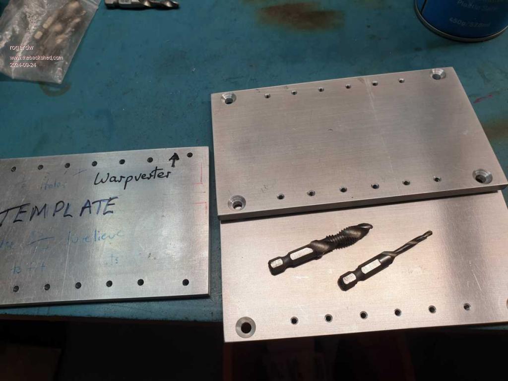

I've been a bit slack since having the Warpverter running but I had always planned to make a few spare modules in case of any failures. Of course that hasn't happened yet so I've made a start on a spare half bridge and a full bridge board.
For all the originals I used Wiseguy's idea of drilling a larger hole from behind to hold a captive nut to secure the mosfets  ...  but I've used (and broken) a few of the combined drill/tap/countersink bits in various other projects in the last couple years  ...  so I figured I'd try my luck with one on these 3mm threads.
I usually pre-drill the holes marginally smaller than the drill section of my tap bit so it has an easier time cutting  ...  and did the same with my aluminium backplates.
The bits are designed to use in an impact drill and fight their way through  ...  and they either make it or break off and remain stuck. Anyway, the tap worked perfectly and took only a few minutes to do 24 threads, Bit nerve wracking, but ended well.
The plates are 6mm thick and I threaded all the way through  ...  and if it had struggled too much, I figured I would drill up from behind so the threaded section didn't have to be the full thickness.
Not sure how I'd approach it if I was doing a full size heatsink  ...  maybe try and arrange the holes so I could do what I described in the last paragraph  ...  or stick to the old fashioned way  ...  slow and steady.
I also included a larger tap so you can see more clearly how they are designed.
Cheers,  Roger

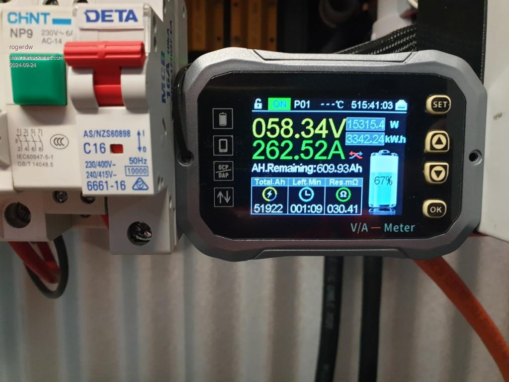

And just out of interest, I happened to walk past the system on Saturday and it was pushing 269 amps into the battery!!!
Of course I didn't have my phone with me and by the time I got back it was at 262. The battery had got flattened the night before because one of the girls had left a big heater on  ...  so was nice to see it fill back up smartly.

I'll have to test one of those bits, that speeds up the process enormously.
That charging current is impressive, all from solar or gen?

Yeah I was impressed with the bits too after I saw them used on you tube. I initially bought an $80 Frost set from Bunnings  ...  but after I broke a couple learning to use them I bought some cheapies off ebay  ...  and they have performed exceptionally well.
The first dozen holes I did on these plates I didn't stop to clean off the swarf  ...  and those took all of about 30 seconds to do  ...  but a few times it got tight and the impact driver started hammering so I figured I shouldn't take chances.
That charging current was all solar. I have 12.6kW coming in via 4 of Poida's MPPTs and another 6.6kW via an AC-coupled Growatt GTI. All secondhand panels, though the 6.6kW lot are relatively new 440 watt ones.
