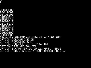

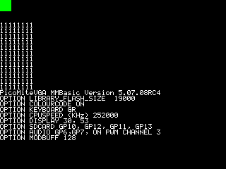

something has changed with the PIXEL(x,y) Function.
@5.07.07 it returns the color of the Dot on the active Layer (Framebuffer write N/F/L), even if the Range was on an Invisible layer. (F or N even if something overlaps on L).
@5.07.08RC4
PIXEL(x,y) returns the Color of the Visible dot, even if a other layer is switched to aktive (Framebuffer write N/F/L)
'no comment

Joined: 04/06/2022
Posts: 1571
Posted: 12:52pm 02 Oct 2023
PicoMiteVGA MMBasic Version 5.07.08RC4
'test
MODE 2:Font 1
FRAMEBUFFER layer
FRAMEBUFFER write n
CLS
Text 0,0,"A"
FRAMEBUFFER write l
Box 0,0,16,16,,RGB(green),RGB(Green)
FRAMEBUFFER write n
Font 7
Text 0,32,""
For y=0 To 11
For x=0 To 7
If Pixel(x,y) Then :Print "1";:Else : Print "0";:EndIf
Next x
Print
Next y
Option list
'Save image "5.07.08RC4.bmp"
if you REM out the BOX on Framebuffer L, it works as it should.
On PicoMiteVGA MMBasic Version 5.07.07 it was correct
Except that the green square on the LAYER isnt saved by "save image"
Edited 2023-10-02 23:22 by Martin H.

Wasn't this a change I made for you? It now reports the OR of N and L when the layer is active to allow SAVE IMAGE to capture the actual display
Martin H.
Joined: 04/06/2022
Posts: 1571
Posted: 01:25pm 02 Oct 2023
  matherp said  Wasn't this a change I made for you? It now reports the OR of N and L when the layer is active to allow SAVE IMAGE to capture the actual display
No Volhout asked for a posibility, saving everything from the Screen..
But that's not the point
The green Square was also @5.0707 on the Screen (Layer) and the PIXEL Function still returns the correct values from the aktiv Layer (N).
What it does not on 5.07.08RC4
So now we can save everything from the screen, but the pixel function only works to a limited extent.
Edited 2023-10-02 23:36 by Martin H.
'no comment
Posts: 12045
Posted: 03:15pm 02 Oct 2023
OK understand - will fix

I just updated the VGA Version, no option was deleted,
Pixel Function is working correct again, thank you
