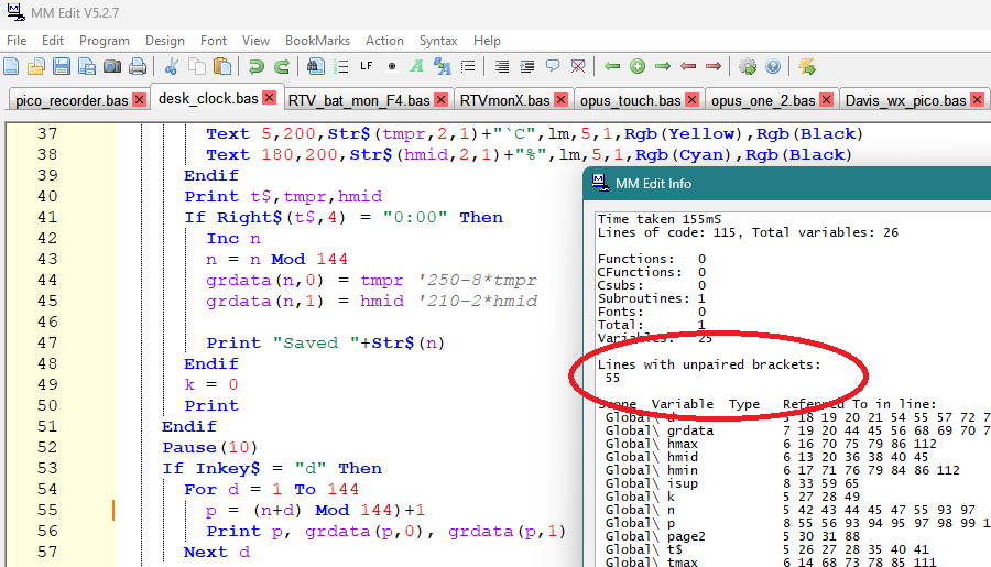

Jim,
There is so much coding help in MMEdit. But the most common remaining error I see when developing code on MMEdit is a mismatch in opening and closing brackets. Which is then detected at runtime.
Is this something for a future release of MMEdit ? Just counting opening and closing brackets, and identifying a mismatch ?
Posts: 6626
Posted: 09:26pm 20 Apr 2024
  Volhout said  Jim,
You mean something like Program/Variable report?
That has been there for many years.
I am always afraid that checking each line as you go will slow things down too much.

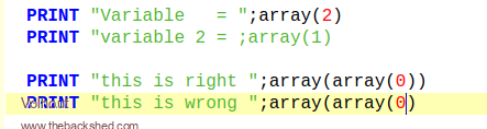

Posts: 6191
Posted: 06:03am 21 Apr 2024
Hi Jim,
I am not sure if I used the correct word. Brackets of Braces ?
Anyway, this is what I meant.
In the second line of code, you immediately see that something is wrong, because the rest of the line is coloured as if the whole line was string.
In the fourth line it is not obvious something is wrong. And this is a simple line, MMBasic challenges the programmer to do things like:
a = MAX(100,(ASC(MID$(a$(index(3,best(2)),which(3),1))) MOD 4)
In such cases it would help in case the unequal "(" and ")" was visible in color or with a mark. I admit this is visible in the report. But you have to pull the report to see that you have problems.

Posts: 6626
Posted: 06:59am 21 Apr 2024
Bracket or Brace - I am happy with either.
I currently do some formatting and things like add new keywords whenever the enter key is pressed.
I could add bracket checking to that subroutine without any major effect on performance.
That would catch many of the errors but what if you edit a line and leave that line without pressing enter? Any bugs introduced would be missed.
Same goes for copy and paste. I currently don't do any formatting etc with a paste.
The Scintilla editor framework does have support for highlighting brace/bracket error but it is up to me to find the errors and declare which brace to highlight.
The more checking I do, the slower it gets. It wouldn't matter with my typing speed but I am not the norm.
If I can find a way of detecting a change of line without having to poll it continually, I can do more. That is something that eludes me for now.
