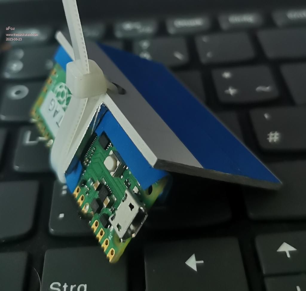

aFox
Joined: 28/02/2023
Posts: 110
Posted: 05:54pm 22 Aug 2023
The use of a heat sink, here a double offset angle profile 30 x 20 x 2 mm made of aluminium, can increase the accuracy of measuring the ambient temperature. The outgoing heat flow from the processor only has a minor influence in relation to the heat sink surface.
