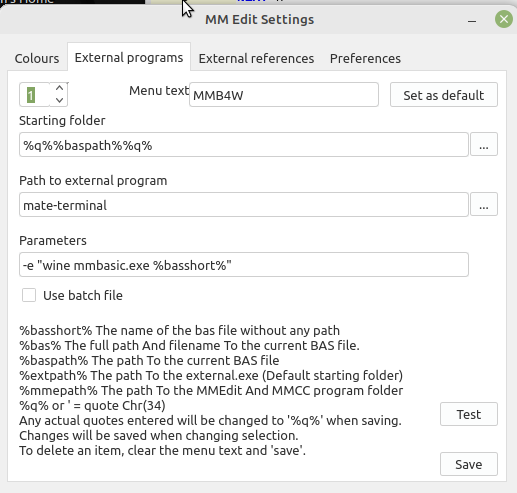

I have had some success with launching MMB4W under wine from the Linux version of MMEdit
(My Linux is worse than poor so beware)
wine can be run from a terminal.Your version of Wine is certain to be different to mine so these notes might not work.
On my Mint Mate the terminal is called "mate-terminal"
My settings in MMEdit preferences is:
Path to external program
mate-terminal
Parameters
-e "wine mmbasic.exe '/home/jim/.wine/drive_c/users/jim/My Documents/%basshort%'"
The -e causes wine to be executed when the terminal starts.
most terminal incarnations will accept -e I think.
I still have to sort out passing the commandline bas program.
MMB4W doesn't like the space in "My Documents" and I have not finished playing with quotes to see if I can solve it.
The other option is to put my BAS files somewhere in the Wine path that doesn't have bloody spaces. Downloads is a likely suspect.
For MMB4L I used.
-e mmb4l %q%%bas%%q%&disown
Edited 2023-05-21 16:03 by TassyJim

Doug,
Try this
In MMB4W, set the OPTION DEFAULT PATH to "My Documents"
In MMEdit set it to send the bas file name without any path.
Provided the bas file is in the default path folder, it 'should' work

Thanks very much Jim, all good - it was the link via the terminal that I could not get into my head,

A shell script can be started from MMEdit and you could kill all apps before starting the new MMB4W.
Brutal.
Posts: 6626
Posted: 04:44am 22 May 2023
Doug,
change your Parameters to:
--tab -e "wineserver -k" --tab -e %q%wine mmbasic.exe %basshort%%q%
It will kill any and all wine apps then run a new MMB4W.
Peter will rightly condemn me for suggesting anything other than a clean exit.
Edited 2023-05-22 14:46 by TassyJim

That's great Jim, works a treat,many thanks.
Doug.
