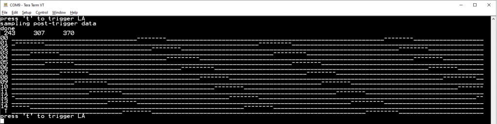

Posts: 6197
Posted: 08:35pm 24 Jan 2023

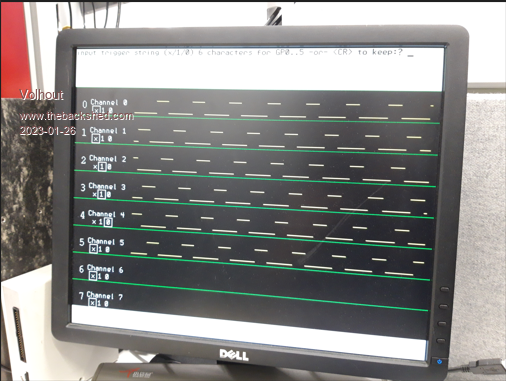

Wauw Peter,
You make me re-think the way I write PIO code. So now we have 3 ways to write PIO code: MMBasic embedded, MMedit+MMreplace, and hand assembly.
For now I just want to share the status of the logic analyzer, which is done the old manual assembly way.
The trigger is build in for the VGA picomite. There are 6 input channels (may become 8 later, but then you loose audio), and you can trigger on any logical combination of the 6 channels.
The user interface is still terminal.
For trigger you can choose "x" (don't care), "1" and "0". Type that in a string for the 6 channels.
i.e. 100001 means trigger when GP0=1, GP1=0, GP2=0, GP3=0, GP4=0, GP5=1
i.e. 1xxxxx means trigger when GP0=1
With the build in test signal some combinations will wait forever (i.e. 11xxxx) since this does not occur.
Next : add edge trigger
Next : add GUI (thanks Martin, will use yours)
The current trigger triggers guaranteed when the trigger condition is stable for 300ns. This is caused by the way the trigger works (it requires 20 PIO cycles maximum).
'problem: trigger always fires 2x in MMCC, not in putty

     Print a$(((unpacked%(i%) And mask%)=mask%));
   Next i%
   Print
 Next j%
 print : print : print
End Sub
'when DMA is ready stop PIO's and re-init for next DMA, then unroll buffer
Sub ReadyInt
 PIO STOP 1,0
 PIO stop 1,1
 PIO init machine 1,1,f1,p1,e1,s1,10   'start address = 10 (0x0A)
 PIO init machine 1,0,f0,p0,e0,s0,0     'start address = 0
 unroll
 math set 0,packed%()
End Sub
'Start the DMA to accept FIFO data from PIO 1.0, and set the posttrigger value
Sub arm_la
'the DMA will time out after &h7FFFFFFF samples, or when stopped
 PIO DMA RX 1,0,&h7FFFFFFF,packed%(),ReadyInt,32,samples%      'start DMA with ring buffer
'write to PIO the number of post trigger samples, starts the logging of pre-trigger data
 PIO WRITE 1,0,1,posttrigger%
End Sub
Sub init_memory
'----------------------- define data buffers -------------------------------
'The logic analyzer captures samples% samples into the packed%() array'
'The DMA buffer has 64bit width, is packed with 32bit FIFO (2 per cell) = length%
'The size of the ring buffer is specified in bytes, so size is 8 * length%
'the samples will be unpacked into unpacked%() at 32 bits per location (=2*lenth%)
 posttrigger% = samples% / 2        'set trigger in centre of circular buffer data
 length% = samples% / 2             'packed buffer = 64bit, data buffer staores 32 bit (in 64 bit vars)
 Dim data%(samples%-1)              'array to put the 32 bit samples (in option base 0)
 Dim unpacked%(samples%-1)          'array to put the 32 bit samples (in option base 0) debug debug debug
 Dim packed%                        'name of the array to be formed as circular array 64 bit wide
'PIO MAKE RING BUFFER creates array called "packed%()" specified in bytes (64 bits = 8*)
 PIO MAKE RING BUFFER packed%,8*length%
End Sub
Sub generate_test_signal
' Test signal: Three phase motor drive - picomite V50706+
' runs autonomously on GP0...GP5 50Hz
 SetPin gp0,pwm  'CH 0a
 SetPin gp1,pwm  'CH 0b
 SetPin gp2,pwm  'CH 1a
 SetPin gp3,pwm  'CH 1b
 SetPin gp4,pwm  'CH 2a
 SetPin gp5,pwm  'CH 2b
 PWM 0, 50, 33.33, -66.66, 1, 1
 PWM 1, 50, 33.33, -66.66, 1, 1
 PWM 2, 50, 33.33, -66.66, 1, 1
 PWM sync 0, 100/3, 200/3
 Pause 20
End Sub
'program the PIO with the sampler code (PIO 1.0) and the trigger
'framework (PIO 1.1) that is reprogrammed each time trigger is changed
Sub PIO_prog
'assign GP22 (trigger_not) to PIO
 setpin gp22,pio1
'the PIO 1.0 program: the sampler
'in this program the PIO reads GP0..GP5 brute force
'and pushes data into FIFO. The clock speed determines the
'sampling rate. There are 3 instructions per cycle
'address    code    mnemonics         comment
'  0        E081    SET GP22 output
'.wrap target
'  1        E001    SET GP22 high
'  2        80A0    pull block        'pull data from FIFO into OSR when available
'  3        A027    mov(x,osr)        'load gate time (in clock pulses) from osr
'  4        4006    IN pins 6         'read 6 pins
'  5        8000    PUSH noblock      'and push to FIFO
'  6        00C4    JMP (GP22) 4      'while no trigger (GP22=1) loop to 4
'  7        4006    IN pins 6         'read 6 pins
'  8        8000    PUSH noblock      'and push to FIFO
'  9        0047    JMP (X<>0) 7 X--  'while X<>0 decrement X and jump to 7
'.wrap
'clean start
 PIO clear 1
'program pio1.0 : sampler
 PIO program line 1,0,&hE081
 PIO program line 1,1,&hE001
 PIO program line 1,2,&h80A0
 PIO program line 1,3,&hA027
 PIO program line 1,4,&h4006
 PIO program line 1,5,&h8000
 PIO program line 1,6,&h00C4
 PIO program line 1,7,&h4006
 PIO program line 1,8,&h8000
 PIO program line 1,9,&h0047
'program pio 1.1 : trigger engine
'since PIO does not know logic, we shift in bits, and qualify each bit at a time
'this makes PIO trigger slow (21 instructions), so 300ns (f1=63MHz) is needed
'for guaranteed trigger detection
'.wrap target
'  10       4006    IN ISR 6          shift in the same data as the sampler
'  11       A0E6    MOV ISR->OSR      mov data to shift out register
'  12       E020    clear X           clear X register, prepare for new bit
'  13       6021    OUT OSR->X 1      shif 1 bit (GP0) into X register
'  14       E020    dummy             will be re-programmed with conditional jump on X
'  15       E020    clear X           clear X register, prepare for new bit
'  16       6021    OUT OSR->X 1      shif 1 bit (GP1) into X register
'  17       E020    dummy             will be re-programmed with conditional jump on X
'etc...
'  27       E020    clear X           clear X register, prepare for new bit
'  28       6021    OUT OSR->X 1      shif 1 bit (GP5) into X register
'  29       E020    dummy             will be re-programmed with conditional jump on X
'  30       E000    SET GP22 low      we passed all qualifiers -> trigger = OK
'.wrap
'  31       000A    JMP wrap targer   not needed...
 PIO program line 1,10,&h4006  'IN ISR 6
 PIO program line 1,11,&hA0E6  'MOV ISR->OSR
 PIO program line 1,12,&hE020  'clr X
 PIO program line 1,13,&h6021  'OUT OSR->X 1
 PIO program line 1,14,&hE020  'trigger GP0
 PIO program line 1,15,&hE020  'clr X
 PIO program line 1,16,&h6021  'OUT OSR->X 1
 PIO program line 1,17,&hE020  'trigger GP1
 PIO program line 1,18,&hE020  'clr X
 PIO program line 1,19,&h6021  'OUT OSR->X 1
 PIO program line 1,20,&hE020  'trigger GP2
 PIO program line 1,21,&hE020  'clr X
 PIO program line 1,22,&h6021  'OUT OSR->X 1
 PIO program line 1,23,&hE020  'trigger GP3
 PIO program line 1,24,&hE020  'clr X
 PIO program line 1,25,&h6021  'OUT OSR->X 1
 PIO program line 1,26,&hE020  'trigger GP4
 PIO program line 1,27,&hE020  'clr X
 PIO program line 1,28,&h6021  'OUT OSR->X 1
 PIO program line 1,29,&hE020  'trigger GP5
 PIO program line 1,30,&hE000  'set GP22 low
 PIO program line 1,31,&h000A  'jmp top
'configuration PIO 1.0
 f0=1e4                             'PIO run at 10kHz
 p0=Pio(pinctrl 0,1,0,gp0,,GP22,)       'IN base = GP0, SET = GP22
 e0=Pio(execctrl gp22,1,9)          'wrap 9 to 1, gp22 is conditional JMP pin
 s0=Pio(shiftctrl 0,0,0,0,0,1)      'shift in through LSB, out is not used
'configuration PIO 1.1
 f1=63e6                            'PIO run at 63MHz
 p1=Pio(pinctrl 0,1,0,gp0,,GP22,)   'IN base = GP0, SET = GP22
 e1=Pio(execctrl gp0,10,30)          'default
 s1=Pio(shiftctrl 0,0,0,0,0,1)      'shift in through LSB, out through LSB
'write the configurations
End Sub
Edited 2023-01-25 06:41 by Volhout
Posts: 6626
Posted: 12:00am 25 Jan 2023
  Quote  'problem: trigger always fires 2x in MMCC, not in putty
You probably have CRLF set for sending. I find LF alone is the most compatible but it does depend on the MMBasic version you are talking to.
adding a input buffer flush allows for any setting to work as expected.
   IF LEN(z$)=6 THEN
     setup_trigger_pattern
   END IF
   DO : LOOP UNTIL INKEY$ = "" ' add this line to flush keyboard buffer
Posts: 6197
Posted: 12:53pm 25 Jan 2023
Hi Jim,
Not sure what is happening. But if I choose TX is CR or LF only still it triggers twice. Maybe something linux is doing under water.
Your SW fix helps. But do't spend any effort on it since this is most likely the last version that uses terminal. VGA is soon to come.
P.S. Maybe I stop here ;-) . This logic analyzer looks like a good entry for the 2023 programming challenge, it requires no external circuits or hardware. I'm not going to be disqualified this year... Tom, are you with us...??

Pluto
Joined: 09/06/2017
Location: Finland
Posts: 418
Posted: 02:27pm 25 Jan 2023

  Volhout said said  P.S. Maybe I stop here ;-)
Can not wait to see the LA operating on VGA!
/Pluto
