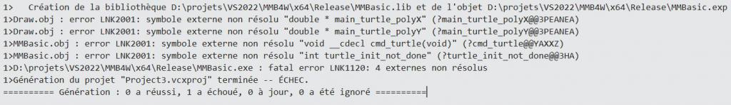

I just get your beta 0 from github and try to compile , they are 4 errors , when i tried to compile the alpha version everything was OK.
Here the log :
I use VS2022 like you.
Cheers.
