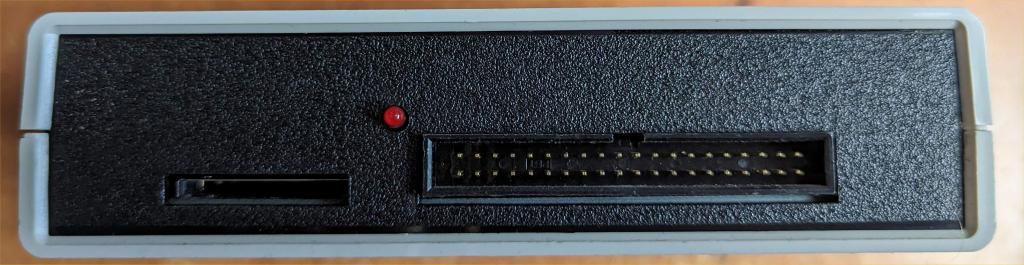

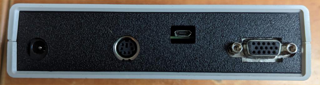

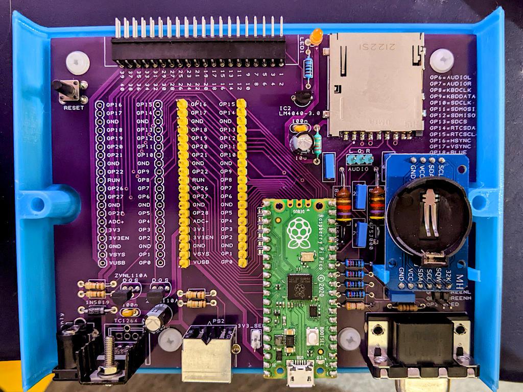

Here's my almost-complete build:
I've been designing my own 3d-printed case, as the Multicomp ones aren't all that easy to get here. It's almost entirely interchangeable with the original case. I'll release it when I've got one with proper cutouts for the ports
Posted: 07:11am 02 Jan 2023
Nice build !
I like the purple board. Mine where "cheap" green...
But the combination with the blue casing is challenging !!
Welcome to the VGA club

Attached dxf and the original Cambam design files for my end-plates.  As pictured these were cut with a LED laser
PicoMiteVGApanels.zip

  matherp said  Attached dxf and the original Cambam design files for my end-plates.
Much appreciated. Working out where the ports are supposed to live is harder than designing the case in OpenSCAD, so everything helps here.

Oh, absolutely - sorry for the delay in posting it:
PicoMiteVGA case - Printables
You don't have to use the colours I did.

Posted: 03:53pm 08 Dec 2023
  matherp said  Attached dxf and the original Cambam design files for my end-plates.  As pictured these were cut with a LED laser
Sorry to be a pain (and probably a bit idle too) but I've successfully 3D printed cases for the PicomiteVGA (and having just acquired a CNC Router) I've just downloaded these DXF files to cut some aluminium panels.
However, I seem to have two front panel DXFs (the 40 pin end). I wonder if you could publish the back panel DXF again please.  :-)

Posted: 04:00pm 08 Dec 2023
