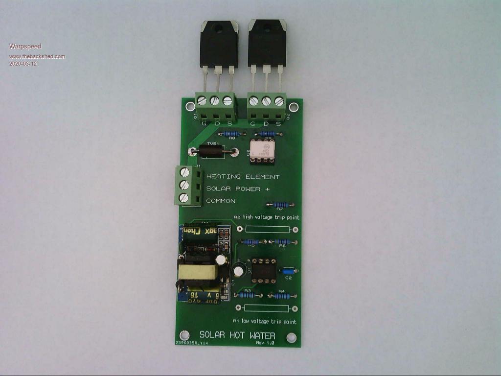

Dave, DHL delivered a nice little package for us about an hour ago.
If you can pm me with your address, it could be in the mail to you today along with the four extra blank boards.
Just bench tested it, no surprises, everything works exactly as anticipated.
Interestingly, the +12v supply is sightly low at only 11.74v which causes the switching points to coincide almost exactly with the resistor values fitted. 180K=180v 220K=220v 270K=270v  etc..
These little supplies always tend to be a bit short of voltage, typically 11.9v. I have never actually seen one at the full rated 12.0v.

Made my week Tony, Literally!
My own efforts have been very depressing.  Blew a few boards with different accidents and stupidity but I guess I learned something. Then the one DC SSR I had gave up which I was really confused about till I did some research and found this is not uncommon.
Haven't been able to play with this at all and it's very frustrating but I am trying to learn more in able to do things properly.
I have been reading up on how to use the mosfets  and studying  this circuit quite a bit and going back and forth learning how it works and what and why you have done things on it. Got most of it now and can appreciate it's simplicity and how clever you have done it. Just need to read up on the Mosfet driver to understand that better as what I have read so far seems a bit conflicting.
The thing that is going to be hard to learn for me is the physical construction of something not on a PCB. Breadboarding confuses me a lot!
These boards look great! Very different to how I pictured them and a very neat layout! Seeing things laid out like this makes me confident even a Dilettante like me could put them together. Tis a thing of beauty!
My idea was to put the Mosfets on a CPU heat sink with a fan. I take it as long as I keep it under 100o ( Mosfet is Limited to 150 right?) that should be ok or do they have to be cooler as I would try for anyway?

Pm received, boards will be in the mail first thing tomorrow morning.
The mosfet driver chip does three things.
It inverts the signal from the LM555, as the output of the LM555 is "upside down". Pin three is logic low when we want our mosfets to switch on, and goes logic high when we want the mosfets to switch off.
The gate drive chip also provides a nice clean very fast high power drive waveform to the mosfet gates, and can easily drive a couple of giant mosfets.
The gate driver chip also has an internal undervoltage shutdown.  At sunrise and sunset the small 12v dc supply really suffers and struggles, and the undervoltage shutdown ensures that the mosfets cannot "half" turn on and create even more problems. The mosfets will either be held off when the +12v supply is very low, or start working when the +12v is high enough for the system to function.
It will probably still have fits and starts when the sun is just below the horizon, but its not going to be destructive. Its an interesting thing to watch any solar control system struggle pitifully into life at first light, and usually die in convulsions at dusk.

Nice circuit Tony, we'll probably see them on AliExpress in the coming weeks lol

Just a reminder to everyone, I can supply Gerbers for this board to anyone that wants them, but I cannot attach the Gerber files to the thread or a PM directly.
You will have to e-mail me first so I can then attach the Gerbers to a reply.
To do that, go to the top of this page and click on "members".
Click on "W"  then scroll down to "Warpspeed" and click on that. My personal details should come up, along with my e-mail address.
That way, you can order your own boards from China direct. Five boards cost about three dollars, but the postage will be more than that.
If I order in a big bunch of boards myself, I have to re post them and mess around with small ammonts of money and make numerous trips back and forth to the post office every time, and I really cannot be bothered with all of that.
Much easier for both of us if you order your own boards direct from China. Feel free to pass the Gerbers on to third parties, its all completely public domain.
This is all so wonderfully simple, it really has no commercial value except perhaps for the Chinese, and I would like to see the whole concept become as widespread and known about as possible.
