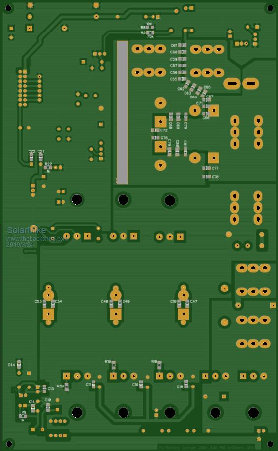

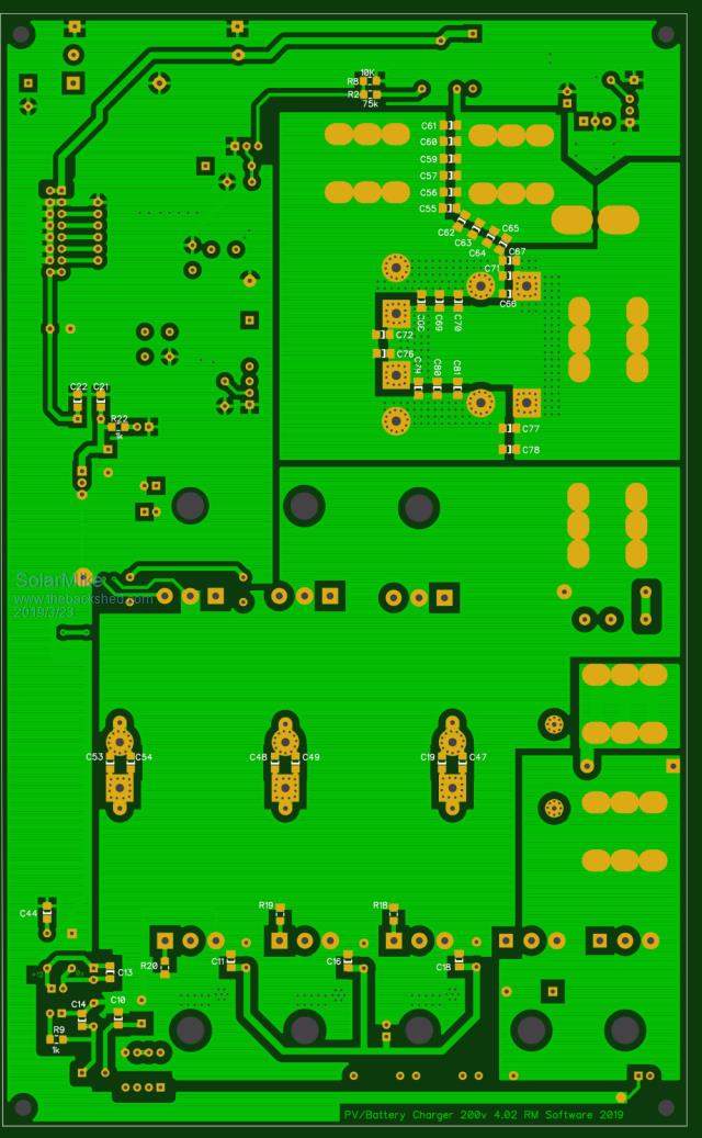

It's been awhile getting this project off the ground, my initial intention was to build a controller that would handle 100 amps or more charge into a 50v bank, built using modular boards that plugged together. However other more pressing projects intervened and now the humongous mppt controller idea has been sidelined for awhile.
My more immediate requirement is something smaller that will accept up to 200v PV and output 60 or so amps into the bank. From a spin off from another project have designed new pcb's, using a single power mppt pcb and a controller cpu pcb linked by ribbon cable. I want the size to be smallish and not limited to any particular CPU. My idea is to bolt 4 of these units into a low profile metal box with large door, so 4 PV arrays can be connected.
The main power board is 2 layer 2oz copper, this sits atop a large finned heat sink, with the mosfets bolted to under the pcb using 3mm bolts and insulation washers. The large holes allow allen key access.
Synchronous rectification has been used in the buck stage using a dedicated control chip. The main switching mosfets each have high current buffer drivers and connect to the cpu board by a high speed opto-coupler.
Intended switch frequency is 100Khz, with the cpu having secondary control of the PWM to effect the MPPT and charge function.
PCB sizes 243 x 150mm, the EasyEDA gerber viewer I'm using doesn't show the top silk layer very well, resulting in some components with no outlines (Big Caps) they all show correctly on the JLCPB cart page ??
Top:
Bottom:
More to come...

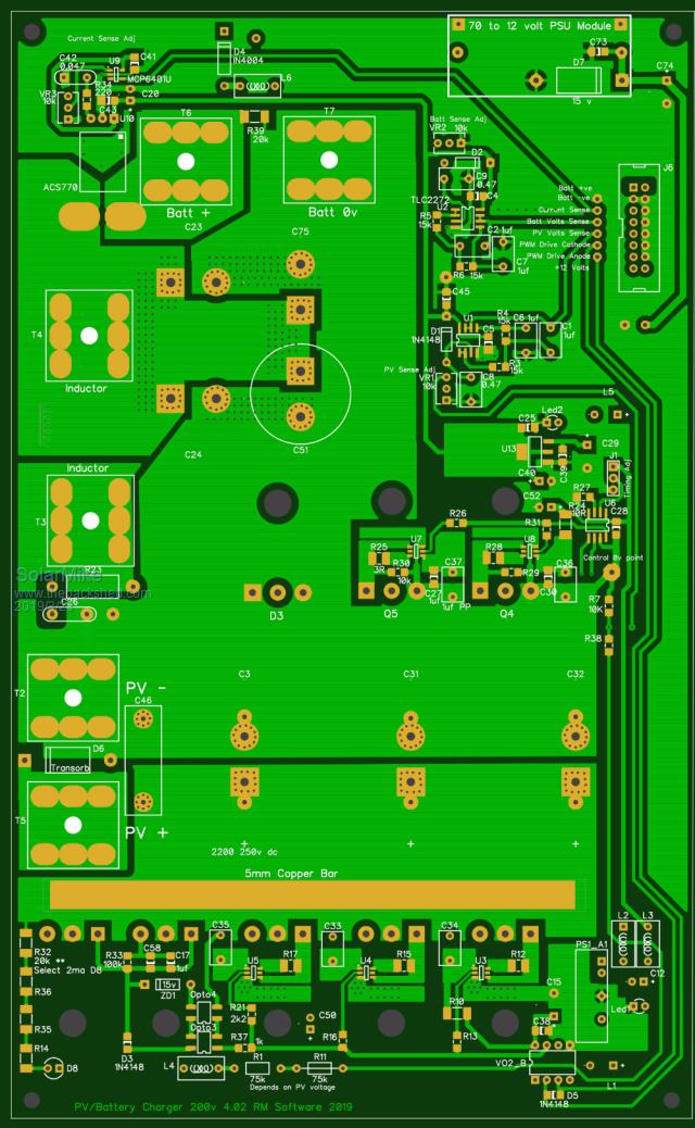

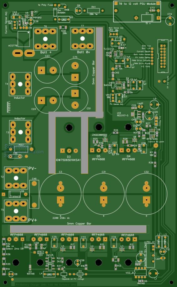

Made changes to pcb to allow soldering of additional 5mm sq copper rails to pcb in areas of high current, existing tracks should be good for 60 amps. but you know how we want to push things a bit. The mosfets are good for > 300 amps, so .....
Mike
