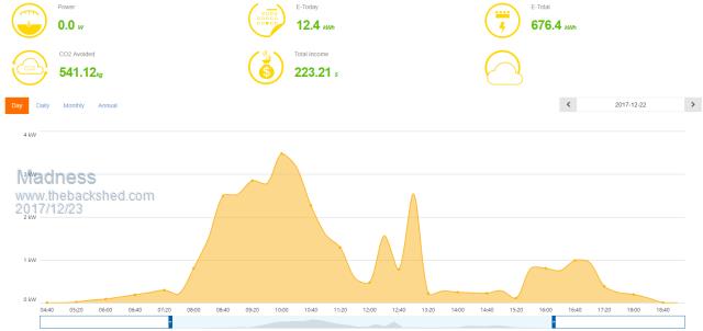

If you replace all your lights with LED ones they use bugger all. We use an electric oven also they are not quite as bad as you think because once it is up to temperature it cycles on and off to regulate the temp. If it is 2400W like ours you can cut that in half so if it is on for 1 hour it uses 1.2KWH. Also if you are able to use it during the day more than you are currently it helps too.
My wife was bragging on Facebook recently how we still had power when everyone else around us was in the dark for 24 hours after a severe storm went through.
The image below is from my 5KW GTI for yesterday, it is only half of the picture as there is another 4.5KW as well not shown. Power kept increasing up to 10 AM with the sun then the regulator started throttling it back as the battery had reached Absorb volts. Total solar energy generated for the day was 22.2KWH, it was mostly clear skies, due to the regulation it holds it back, I have had around 40KWH in one day. This was after a few days of very cloudy weather so battery needed a lot of charging and hot water was right down as well. I divert power to the HWS when the battery reaches absorb, it can take 2400W most of the day when the temperature is down.

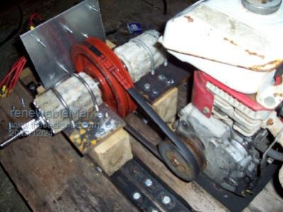

I was going to build one like this Higlander did
here
I have an older 42 stator and just recently scored a newer 36, I'll add that to the list of projects.
