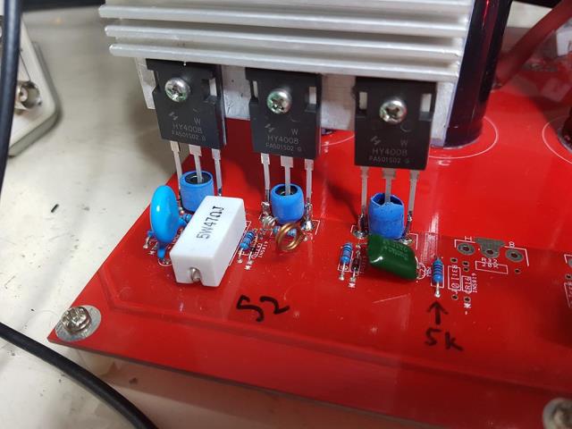

Part 35: Further examinations of Madness' power board. Differences between driving 1x HY4008 and 3x HY4008
I now have 1x HY4008 on one half of the full bridge and 3x HY4008 on the other 1/2.
All MOSFETS have the large ferrite beads on their Drain pins.
The inverter runs fine.
The first thing I noticed is the EMI caused by the hard switching of DC supply
has been reduced to a very large degree. This now gives me unexpectedly clean
signals when I attach probes (with their little ground leads too) at current sensor output, for example. The much reduced EMI is a welcome result and will help in unexpected ways, particularly on the nanoverter board. RenewableMark found his nanoverter was upset by EMI and the fix was to add ferrite beads until stable running returned. I think with these beads on the Drains, we might have sorted out this problem.
Secondly, adding 2 more HY4008 to the totem pole drive outputs does not delay the switching, or degrade it in any way I can see. This is to be expected, Madness
has a lot of confidence in these boards, stemming from his continual use of the board in his home inverter.
Finally, I notice the high side charge pump seems to HAVE been effected by the addition of the 2 extra MOSFETS per leg. When driving one HY4008, the peak gate drive voltage is about 16V and this is maintained for the duration of the PWM pulse.
But when driving 3 HY4008, the high side gate voltage exceeds 17V for a little, then drops down to about 13.5V near the end of the PWM pulse.
The HY4008 specs show a maximum Gate voltage of +/- 25V to Source. This 17V is good.
Not too high and not too low. Too high and we risk having a short service life due to the oxide insulation layer of the Gate wearing out. (they do, at high Vgs)
Too low and we risk spending too long switching, that is too long in the resistive area of Vgs. This increases inverter power loss and adds a lot of heat. It also is responsible for poor service lifetimes.
So the 17V is good. Particularly putting 17V in to get the switching done fast and then reducing it a bit, for maximum Gate oxide insulation lifetime.
Below is a link to large image, comparing gate voltages of the low and high sides
for (on the left) 1x HY4008 and (on the right) 3x HY4008.
I have recorded these at 3 time locations in the 50Hz half wave.
5.0ms, 1.3ms and 8.7ms
At each of these times, I show the entire PWM pulse first, then zoom in to the switch ON and then switch OFF events.
I used different vertical attenuation settings for the 3x sadly.
But you can still see enough.
imagur link
This work nearly completes my investigations into the suitability (for use in my home inverter) and behavior of the Madness 6x HY4008 totem pole driven power board.
I think it's time to build the working inverter board, with 4x HY408 per leg

  Madness said  ... Actually, I have never powered up a power board without a control card attached.
Poida would you mind posting a picture with the Beads in place, please?
I have seen the high side charge pump retain voltages of 16V for an hour
after I remove the DC supply. I wonder if this might be part of the reason
why I had the blow-up when I plugged the controller board in.
The beads have a bit of shrink tubing due to their surprising resistance.
The Drain will be 55V to Source, so if it touches the Gate?
I just checked the bead resistance (probe points on opposite side of cyclinder)
and it can be as low as 150 Ohms.
The LCR meter at 10kHz thinks they are about 11uH with a wire passing once through the hole of the bead.Edited by poida 2019-06-16

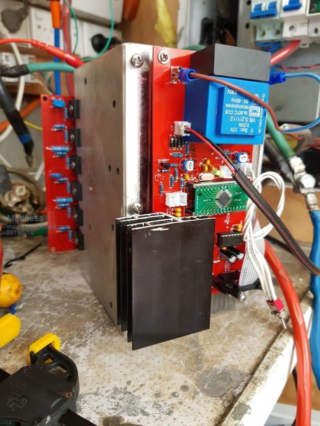

My 4KW power board does not have TOTEM poles as it does not need them.
This Inverter runs my house just fine so long as I don't run AC or use my 240 amp MIG welder off of it.

That board in the picture has 12 mosfets
I like your matching control board that's pretty cool
I am guessing and would be willing to bet it would run anyting I would need and more

The PCB above is as follows "My 4KW power board does not have TOTEM poles as it does not need them.
This Inverter runs my house just fine so long as I don't run AC or use my 240 amp MIG welder off of it."
It is not capable of 8KW.

Hey Buddy.
Did you pushed 8kW from the 4kW board? Impressive, but looks risky for me.
