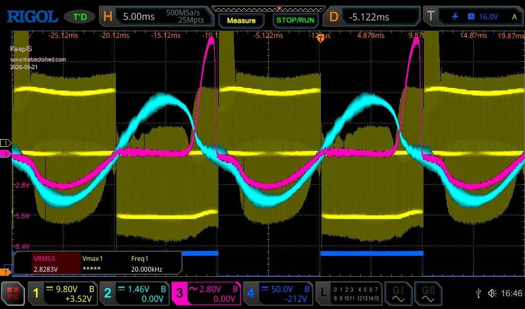

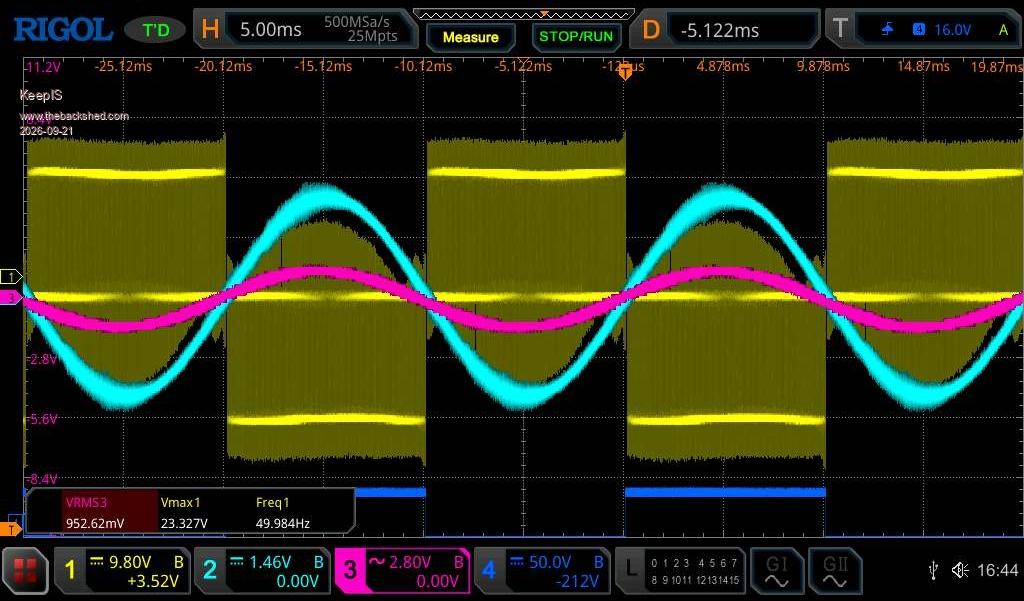

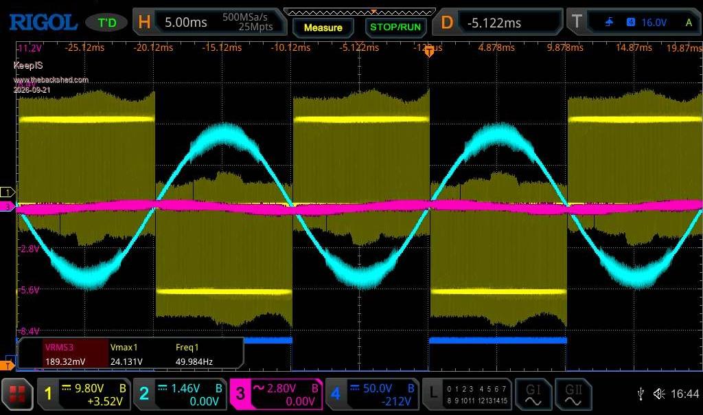

Something I did for fun. No VFB 20V DC supply.
A: Test Inverter, Power board with 34,000uF.
B: DC voltage DOES NOT CHANGE, monitored with A DSO.
C: No AC Feedback connected, besides it's below VFB activation in any case.
D: Inverter powered by regulated 20Vdc supply with a max current of 21 Amperes.
Pink: Primary Current.
Blue: LT AC output.
Capture 1: Idle.
Capture 2: 180w Restive Load.
A: 11.5A Primary current via Clamp meter.
B: 12A  vPrimary current via TLS76L1.
Capture 3: Heat Gun.
A: 34A Primary current via AC clamp meter.
B: 35A Primary current via TLS76L1.
C: DC current switches between 11A and 20A every few seconds.
D: Buzz in Toroid does not change with that swing.

Great image shots and good idea to remove feedback as Nicks also recently did. The yellow drive waveform appears to be phase reversed compared to the output - it just made it a bit harder to interpret at first.
Maybe my analysis below is wrong or questionable, I am not trying to speak with authority, its just a theoretical comment and I invite comments for or against.
The peak voltage for the positive unloaded 180 degrees is ~ 2 divisions, The peak for the loaded negative 1/2 wave is ~ 1.5 divisions. The result of the asymmetrical waveform results in the positive unloaded current but with saturation peaks.
This is why I described our toroids as "puny" compared to the mains. With a distorted waveform such as this applying feedback might make it even worse as it tries to drive harder for the lower average output? My suggestion of 180 degree measurements and applying them to the second 180 degree waveform - not the next immediate period should try to prevent or at least partially mitigate the issue of the low negative toroid drive voltage. I am unsure but suspect that changing the phasing of the feedback might only make a small difference on the idle hum.
I am not telling you or anyone to write the code but I can see an issue that we can either accept or have a further play with the code to see if we can get a better result. I am happy to offer up my inverter as a sacrificial unit for testing if it makes any difference.

I intend to capture the Heatgun on the Main Inverter in a real world off-grid situation, I'm sure that 1kW or more of normal running loads when the Heatgun is connected, will considerably dampen the effect on the Inverter.
Years ago I remember reading many posts on various forums bemoaning the destruction of Inverters when a stupid load like this was connected.
Again, it has never caused a problem for my Inverters. I do understand the desire to see if the effect can be reduced as a technical exercise, I'm just not sure I want to start changing 100% stable Inverter code to accommodate a piece of crap that has no right to be sold or used with Inverter power, or Mains for that matter. If you want to play with that and no one else comes forward, we can certainly do that in the future.

After a few days of thought I am coming around to your way of thinking. Whilst I will remain curious about whether it could behave better with poor loads, when it is presented with typical daily loads including welding etc it behaves just fine.
I think I was falling into a trap of trying to fix a perceived problem rather than a proven problem. I guess I wanted the inverter to behave really well no matter what crap was plugged into it which is probably overthinking a solution for someone elses poor choice. After replacing 16 FETs maybe better choices will be made .

I've been following this mostly in the hope of understanding the come-&-go hum at idle (i will try swapping the v feedback polarity, but haven't yet), but i am fascinated by the torroids reaction to a recified load:
it's as if having passed current (or more like coulombs - is the area under the curve equal i wonder?) on one half cycle, it needs to pass an equal number of coulombs in the other half cycle, but, being unable to pass them through the load on the secondary, the 'pressure' builds on the primary until the H-bridge voltage drops towards zero, letting them all through on the end of the cycle. And yet the secondary voltage doesn't show this 'pressure'.
And then having reset to 'no load' current for the zero crossing, it has to build the load current up again on the new cycle, indicated by the 'sag' on both voltage and current in the rise from zero.
Not really planning on experimenting with asymmetric loads myself, but i sometimes think i should scope the waveforms when charging the EV as i get some quite loud transformer noise from that - but then it is a quite powerful ac-dc convertor (up to 22kW) being modulated down to just 2kW.

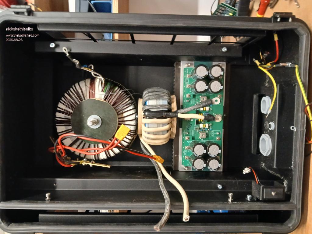

Well I'm "close" (maybe by the end of the weekend) to finishing my first "baby" WG inverter and then I will have a play with assymetric pulse modulation. But not with feedback I think, just to see if this let the transformer hum or cancel it, and then to see the effect on an assymetric load, just for fun.
Here is a teaser:
I need to make thinner plates for the inductor as it is to close to the transformer. But the layout is somewhat made now. It will charge the EV or heat the hotwater tank, it should run 3kW nominal for the heater. But should run the house when I'm converting the ozz inverter to a dual WG inverter.
I mostly charge the car at 1700W wich is the lowest setting, but this does not upset the inverter it looks like a nice resistive load. ( it's a E5008 and only capable of 11kw on 3 phase, maybe a next project, a hf 3ph inverter, someday  )
I'm gonna try to use the car as generator the coming winter, in combination with an eltek psu.

  nickskethisniks said  Well I'm "close" (maybe by the end of the weekend) to finishing my first "baby" WG inverter and then I will have a play with assymetric pulse modulation.
That looks really cute

Several hundred uF of motor capacitors across the AC output will help push that waveform back towards symmetrical when using cheap heat guns or hair dryers. It works, but the tradeoff is that a large amount of reactive current will always be flowing. It doesn't consume any battery energy because it just gets re-absorbed on the next cycle, but it does still have to be switched by the FETs, so some loss occurs by heating Rdson.
I've read that big industrial inverters compensate for this kind of flux walking by using an auxiliary winding on the transformer and integrating the voltage across it. That will give you a signal proportional to the core flux. The controller can compare the positive and negative flux excursions and trim the SPWM to re-center the core.
