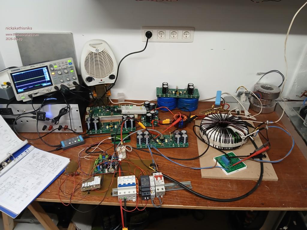

Thanks for the response and advice about the wiring, there is room for improvement here.

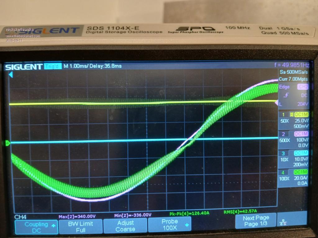

My hum is not that loud, when pulling about 3.6A DC, I only see 30mA variance during the event, when pulling 1000W I would not be able to measure a difference during the event, so it is realy not that bad.
Going from 4x 8200uF to 8x 8200uF made it a bit lower I think. I think because it is difficult to actualy see improvement or such. Shielding the bottom of the pcb with another pcb thin copper plane did not made a difference. I'm allready using an external isolated dcdc psu with grounds tied together, but not everything in one point. Placed some ferrite clamps on the incomming wires to the pcb. So I think there are no stability issues and I'm chasing a ghost here.
What's on the list to do, will be replacing the thin copper plate by thicker aluminium, make a gnd starpoint and try other powerboards.
Edit: another bridge with irfp4110 mosfets gave the same buz.
BTW, Wich firmware "core" of Poida are you using? It might have to do something with the moment (after 1 period or 1/2 period) the pwm is altered and the way my scoop is capturing the signals. The hum is just the mechanical effect and a logical consequence.
Here is another scope image during the hum, only happening once/period. When there is no hum, current and voltage are on top of eachother.
Pink: output ac voltage, yellow: bus voltage, green: bridge current
Edited 2026-09-11 20:20 by nickskethisniks
Footnote added 2026-09-11 22:58 by nickskethisniks
Guess what, I was able to make the buz worse with an rc of 2n2 and 10 between ac out on the bridge. So it's probably real and noise related.
Adding a 0R1 series resistor between bridge and inductor removed the buz but it's not usable.

If you look at this recent thread code question the link in the second post, but change (float)(NPWM-1) to (float)NPWM for correct sine output. I used the SPWM code section as a basic starting point and then went from there. I doubt you will find anything there in the SPWM code section of that, what poida wrote is really sweet.
I remember poida posted a lot of captures of primary current, AC out and switching wave forms, I also spent a lot of time investigating this when I was streamlining the code, and checking code timing etc. With the exception of that slightly extended zero crossing issue with the 1/2 Sine table, that somehow accidentally crept into the code, it looks about as good as it can get with the Nano hardware.
I think that slight cycling hum is not an issue and is not the cause of hum, rather it's just modulating a slight underlying hum under some conditions. This hum has been there from the very first DIY Inverter builds using completely different hardware and SPWM controller designs and going back 15 years or more.
Your footnote is something I also found, and as this is really only on the test unit, and not apparent in the Main inverter, I've just put it down to Toroid construction, winding ratios and anything with the Toroid mounting and enclosure that can often amplify that slight hum.
Even on my test unit I can sometimes place my ear against the Toriod and the Toroid is almost silent

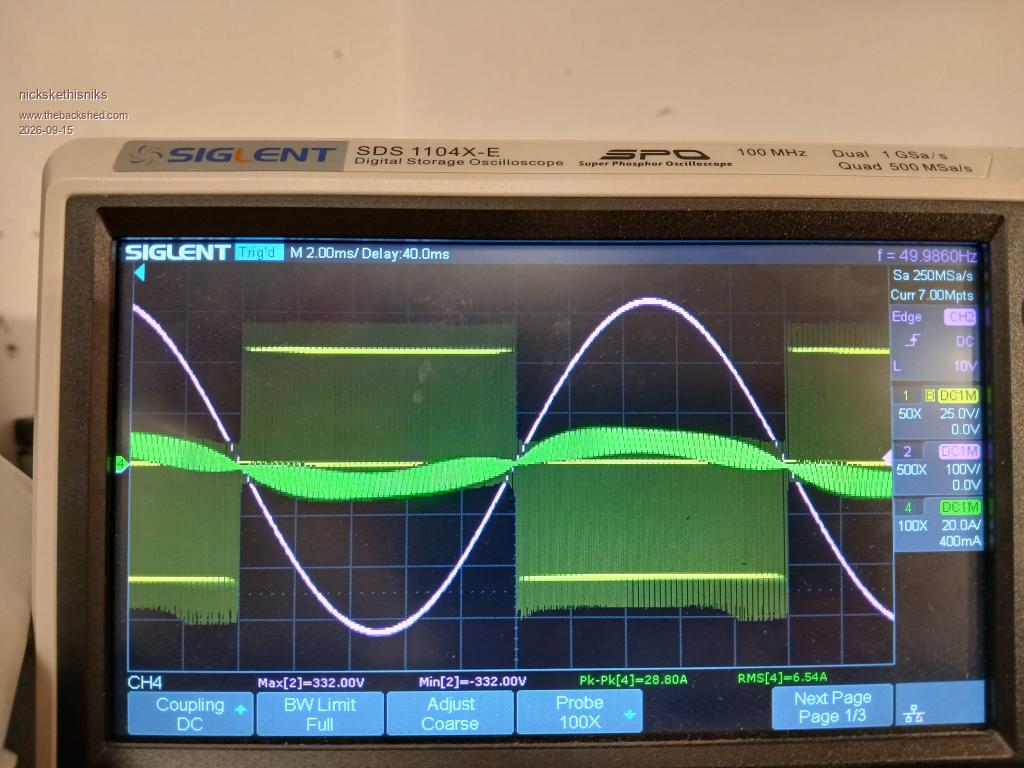

After a weekend full of testing there is some "decompression" and again the normal work and kids routines repeat again...
So, last week I received some suggestions of Wiseguy, it was the reduction of 22nf capacitors to 2.2nf on the small transformer on the controllerboard that made my inverter quiet and stable, I declared my inverter as "perfect" and finished the testing. So this was the version with the hy5608 mosfets and beads with a clamping resistor, lets say apart from the resistors this is the "stock" version like the bill off material suggests. By my feeling it responded more quickly and did not let the current deviate.
Unfortunattely it will not have the same effect in other inverters I guess. When I was testing the next day with my irfp4110 bridge there was the effect again, but not as much as before so I believe its realy helping to make the inverter react more quickly. Dynamics are different because it had only 4 capacitors vs 8 wich is a big difference.
I think each inverter made by someone different with other components needs a different tweak to get it perfect perfect. Before the weekend I think the inverter was allready performing perfect, but with a little tweaking it became perfect perfect.
I think this is under the light bulb load. But to be honest I should make video's.
You might see a small assymetry but this was done with 2u2 ouput capacitor, with 1uF it was allmost perfect symetric, 4u7 made it worse but no variation of the current. It's the variation of current that makes the humm more pronounced.
I had 4 scenario's, 0W 150W 1150W and 2150W, all were stable.

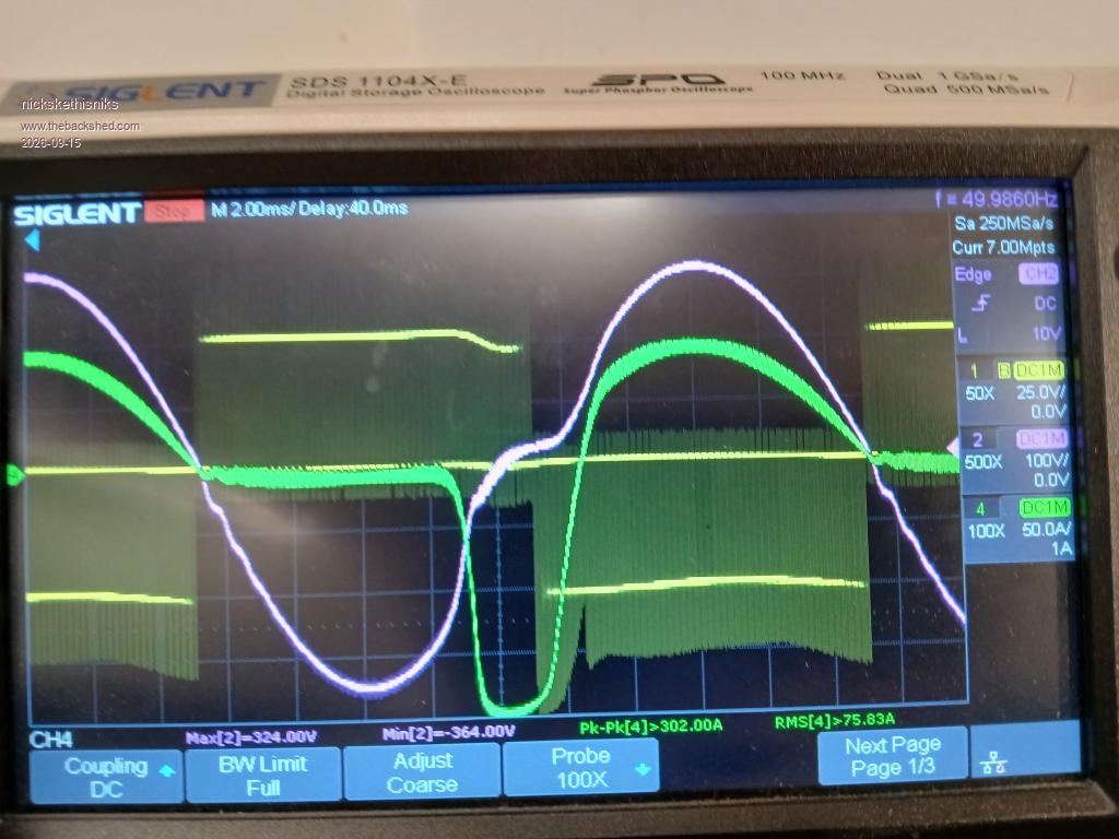

Oh I forgot, what about a heatgun on half power? As far as driving an lf inverter assymetric, this is a scary picture with core saturation in mind. (but no problem)
It's like the LC tank will balance the whole thing somehow.
I even tried it with the small Wiseguy 8 mosfet board   .
It's past midnight here so, I will go to sleep now. I will start my own thread if I find the time.
Edited 2026-09-15 08:11 by nickskethisniks

Thanks for the post and pictures. The last CRO picture tells a story. At the point where the negative current increases rapidly the P-P of the H bridge has drooped markedly from the thicker yellow DC bus line. This corresponds to a droop in the supply voltage which may be fortuitous?
The negative side is the non-conducting part of the heat gun half cycle but its magnitude is ~ 200A, which for a 50V supply is a 10kW event - when not even driving a load! So it is reasonable to assume the toroid is well into saturation.
I am coming up with a theory. If we look at whole 360° cycles the average p-p output voltage with the heat gun reduces, so PWM increases for both halves of the waveform. This is good for the heat-gun conducting 180° half cycle but the increased PWM with the 180° no load is driven quickly into saturation after a few cycles.
Ok so lets say we control PWM with 180° cycles so on the heat gun conducting cycles we see low vfb so we increase the drive on the next half cycle - this is even worse, instead of the average of a 360° event we are now basing the next half cycle on the lowest minimum AC output for the previous half cycle.
So what if we look at 180° vfb but apply the correction on the second half drive cycle. We are now applying the extra drive to the cycle half that needs it. The unloaded half cycle will then (hopefully...) get the pwm it really should have.
Of course, if some a-hole designs a heat gun that skips cycles ie every 3d half-cycle we are probably back where we started, but we can ignore that it's easier to get another heat gun.
So over to Keepis/Poida - is this feasible - sounds relatively easy to me but I'm not writing the code . The speed of the precision rectifier & vfb circuitry must be fast enough to give the correct information to the Nano, so it might need tweaking.
As an after thought, perhaps a current sensor on one of the primary drive wires should be investigated as a fast safety shutdown to stop the controller if it ever sees for example a 200A event, it should be faster than an input DC current sensor and its not much fun changing out a handful of FETs. Ok for Keepis this might need to be 300 or 400A
