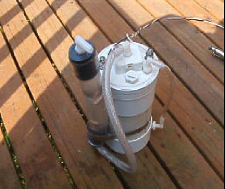

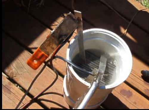

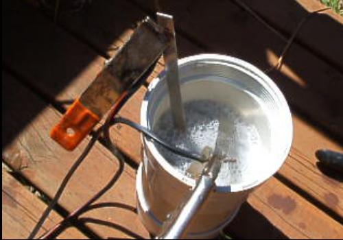

would short circuit the battery.The Photo's below are my own, The smacks design shown in the first photo is my first Generator. Later I modified the smacks, i junked the 304 alloy wall switch plates and purchased a sheet of 316 alloy S.S., Then fabricated 16 plates but only 14
would fit in the PVC Pipe Cell The Second picture is the
modified version with bubbler. My battery charger showed
14 anp at 12 volts input, notice the 2 large bubbles in the bubbler, they were coming pretty fast. Sodium Hydroxide was used as electrolyte.

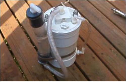

I sent the wrong pic' of the bubbler even though the large bubbles are present in that pic. only one small one shows
here is the correct one

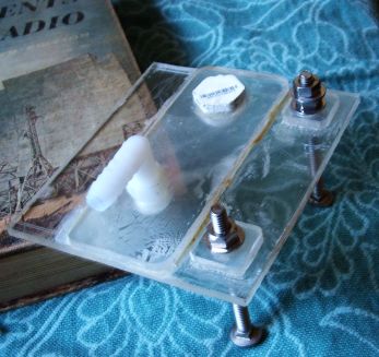

I have not had time to mess with the HYD. generators lately but here is a pic. of the top that
would fit on this design. I previously made up a how to build it instructable for a different web site
but decided not to post it.
