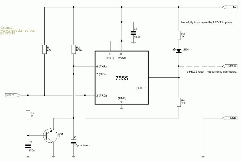

OK folks, I have put the 7555 in place of the 555 and dropped the supply voltage to 3v3. Surprisingly, this did not really effect the time period as I thought it would.
Circuit working fine, but I had to drop the 22k on the output pin, back to 10k with the 7555, or it would not pulse the output - it just stayed on like before. This is not an issue really, as thanks to TZA, we are now using the discharge pin as the connection to the PIC32 when the time comes.
One thing I AM having an issue with, is that once tripped, if you don't pulse the input again within 2s, it starts pulsing again. If I pulse the input again before 2s, THEN wait - the delay is back to 6s or so. This might be something to do with the tolerances between the 555 and the 7555. I think we still need some more tweaking. I will tinker a bit more, and post back with anything exciting.
EDIT: Error on the schematic - 680k resistor is actually a 560k. I am about to change this to 680k anyway, but thought I would mention it, as this is the timing resistor, so it will have a bearing on the time period.
EDIT: 680k has added about 1s to the 1st cycle time period, but the repeat cycles are still only 2s or so, which is really too short - the MM will not be running again in such a short time from reset.
At this point, I am happy for further prods in the design, otherwise we will quit while we are ahead, and I will start playing around with the 6369 WDT chips. It's just they are so tiny...Edited by Grogster 2013-06-14

I suggested the 22k Resistor to go from the 555 output to the trigger input... You have it going to pin 6 (threshold) rather than Pin 2 (Trigger).
Is this a change as my suggestion didnt work?

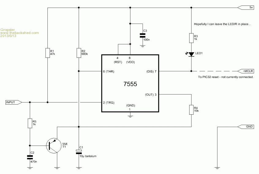

I am also curious... why did you separate the Discharge pin (pin 7) and use that as the output if the cct was basically working previously? This may also have an adverse affect to the original intent of the cct..

I've made a bo-bo with the cct - yes, 10k(was 22k) comes back to pin2, not pin6 as in the drawing - I will update the drawing...
Discharge pin used as "Output" at suggestion of TZA, and it works fine like that.
The reason for this, was that the Discharge pin can pull the ~MCLR line low, as it(the ~MCLR pin on the MM) is already pulled high with the 10k pull-up on the MM. If connected to the Output pin, this line is driven-high and driven low, which when driven high, will bypass the 10k on the MM - that may not actually be much of an issue - opinions? I think the discharge pin concept is a good idea, and all of my experiments since TZA suggested that one, have had the test LED connect as in the diagram.
However, you have a point - as a final experiment, I will put the LED back on the output pin, but still leave your 22k and transistor cap in place, and see what happens.
Corrected circuit:
Yes - this does seem to make all the difference.
With pin 6 & 7 linked again as in original cct, timings are 6s to first pulse, and 6s for every subsequent pulse - much better. Nice prod, Mick!
Although, I still liked TZA's idea, but obviously, the 555/7555 was not happy connected like that with respect to the rest of the circuit. I guess that is to be expected, when I think about it...

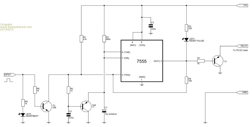

OK, here is the new cct:
This one uses a simple transistor inverter on the input, so that positive-going pulses can be used to keep the WDT going without playing around with the values of the original cct(lesson learnt!), and also a buffer transistor on the output - isolation is a good thing, IMHO. Yes, it uses extra parts, but 548's and 559's are cheap as chips...

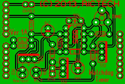

Here is an image from the PCB software:
PCB is 53mm x 36mm, and plugs directly into the CG CMM units, where the Sheild footprint is. Edited by Grogster 2013-06-15

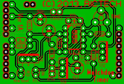

Final PCB is ready - I will get some boards made next week at PCB Zone.
I added two more caps, and changed one other as per the 555 datasheet etc.
ADDED: 100uF decoupling cap on 5v supply, and 10n cap on pin5(CV) of the 555, as per the datasheet recommendation. I checked this on the breadboard, and the 10n on pin5 does not seem to have any effect on the operation of the circuit, and in fact, is recommended when the 555 is used in mono-stable mode like this, so...
CHANGED: 10uF tant for a standard aluminum 10uF electro. Reading about tants, it would seem that they intently dislike being shorted out, and that is exactly what the transistor across the cap is doing, so I elected to replace it. When timing is not mission-critical, a "Drifty over time" standard electro should not really pose much of a problem, and it is also a much cheaper cap then a tant.
The pin-strips where the Shield socket is, have been replaced with just holes only.
This allows the board to suit either male or female pin-strips/sockets, depending on what is on the CG CMM. In MY case, I fitted pin-strips where the Shield socket is, as I thought that would be easier for me to jumper out to breadboards for prototyping etc. In hindsight, I should have put female socket strips on there, as normal. Either way, the holes-only concept allows for either, and means I can use SS PCB's which halves the price of the PCB. (original idea was DS board with plated-through holes just for the Shield footprint, but for the extra pads, I have to pay twice as much for the DS board, so in order to keep the costs down...
You slide the WDT board onto the pin-strips on the Shield footprint(in my case), and then use jumper shunts to link from the adjacent pads, to make the connection. Either that, or short solder links. Not exactly the prettiest design, but it is simple, and it works.
