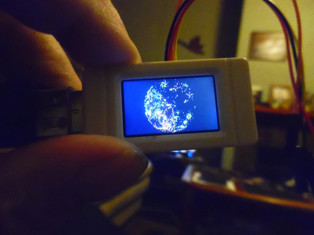

stanleyella
Joined: 25/06/2022
Posts: 2807
Posted: 07:12pm 05 Apr 2024
  matherp said  Does the display still work? Not sure why I set RLANDSCAPE is it what's wanted?
display is fine using bubble universe as test prog and option list shows option autorun on , as the prog is
and option cpuspeed 420000 seems to be stable with bubble universe which seems a bit faster.??
Thank you for supporting so many picos sir.
Connected to COM9 at 115200
> option list
PicoMite MMBasic Version 5.09.00RC3
OPTION SYSTEM SPI GP10,GP11,GP24
OPTION AUTORUN  ON
OPTION FLASH SIZE 4194304
OPTION COLOURCODE ON
OPTION HEARTBEAT OFF
OPTION PICO OFF
OPTION CPUSPEED  420000 'KHz
OPTION LCDPANEL ST7789_135, RLANDSCAPE,GP8,GP12,GP9,GP25
OPTION SDCARD GP23, GP18, GP19, GP20
OPTION PLATFORM RP2040-GEEK
edit I tested temp at 420000 and just laser thermom says around 30 to 36 deg C
bubble universe is the same any orientation
Edited 2024-04-06 05:36 by stanleyella

stanleyella
Joined: 25/06/2022
Posts: 2807
Posted: 07:45pm 05 Apr 2024
I never got these. I got another pico with a display attached  but these are weird
 still working at cpu 420000
