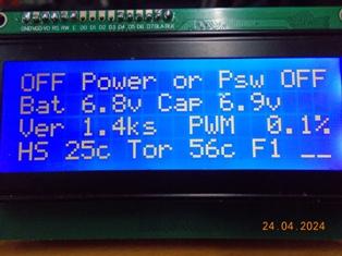

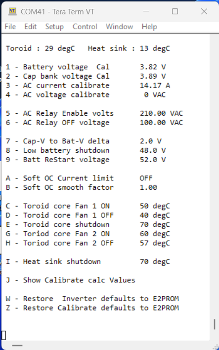

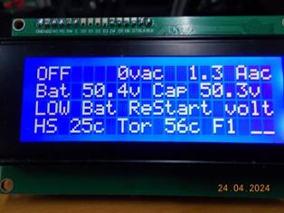

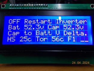

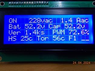

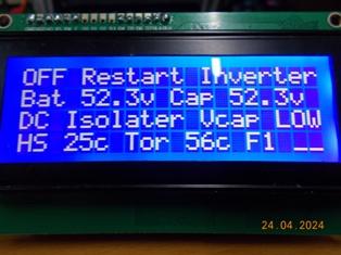

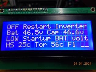

I have added a few LCD screen captures to give an idea of the various information displayed for fault conditions.  FYI it's running with USB power connected:
These captures are running my Dual Toriod Fan setting. If you don't know why I want this, you might if you build a 3 stack toriod core. I don't need a Heatsink Fan in the main inverter, but in the smaller inverter I will, so I have the option.
The first LCD is obvious, F1 on the lower line is indicating that Fan 1 is on for the toriod - if the toriod second fan is triggered, F2 will appear in the last two place markers.
The last LCD screen shown the standard inverter code with Heatsink fan and Toriod Fan, TF is obvious, if the Heatsink fan was running, the last two place markers would show HF.
There are a few more screens missing that display Software Over current, Toriod and Heatsink Over temp, and AC Enable low voltage cutoff.
Most error messages appear on the 3rd line, a couple can appear on the Last line, and the need for a "power cycle" to restart is indicated on the first line.
Dual Toroid Fan option
Normal HS and Toriod Fans
BTW The Nano can be programmed via USB with just a tiny program - No IDE or other software or hardware:
Simply select the HEX file and hit program, the Nano is ready to go.
Edited 2024-04-24 18:04 by KeepIS

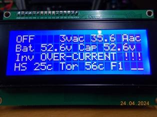

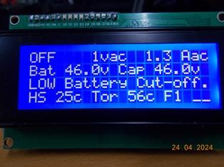

I though I'd run through my error messages and give some idea of things we can do with the Nano.
The first message is: "LOW Startup BAT volt"
When the inverter is first powered on - the battery voltage should at least be above the Low Battery cutoff setting, if not, you see the messages above and the inverter gives you the middle finger, the LCD top line tells you to "Restart Inverter".
"DC Isolater Vcap LOW"
At the point of Kilovac enable "for Auto wiring" or, the Main breaker switched to ON and Inverter switched to Run for "manual wiring". At this moment in time, there should be almost no difference between Battery and Cap bank voltage - if there is, you see the above message, possible causes are High resistance / faulty Main breaker or Kilovac wiring or fault, poor inverter wiring etc.
"Cap to Batt V Delta"
This should never happen unless you have a resistive loss (heat) and this time it's happening under load, so the message above is displayed. It means there is larger voltage drop "Delta setting" between the Inverter battery connections and the Inverter power board Cap bank connections. That could be a wiring fault, terminal connection fault, DC breaker of Kilovac, or other problem.
"LOW Battery Cut-off"
The battery is below the setting for low battery voltage, this is timed so that short transitions below that point from transient high loads will not trip the inverter, when tripped, the inverter will display the message above, SPWM is ramped down and the inverter waits for the battery restart setup voltage before ramping up and running.
"LOW Bat ReStart volt"
This message will automatically appear as the battery voltage rises from the previous error above, the inverter will display this until the restart voltage is reached, whereupon the inverter will ramp up and run normally.

"Inv OVER-CURRENT !!!"
AC current trip - Hardware OC trip. The over current LED lights, the Reset switch must be pressed to allow the inverter to restart, or the inverter must be powered off and on. Also from DC input current trip using an external current sensor - there is a pin on the controller for this input.

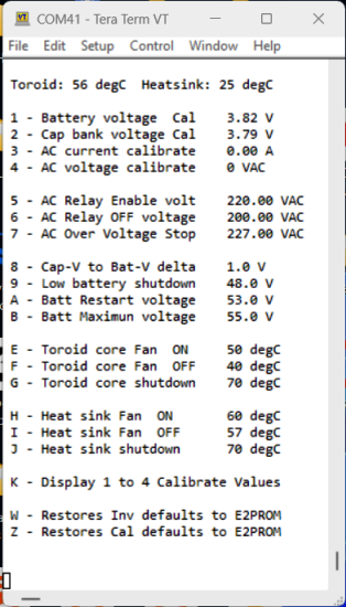

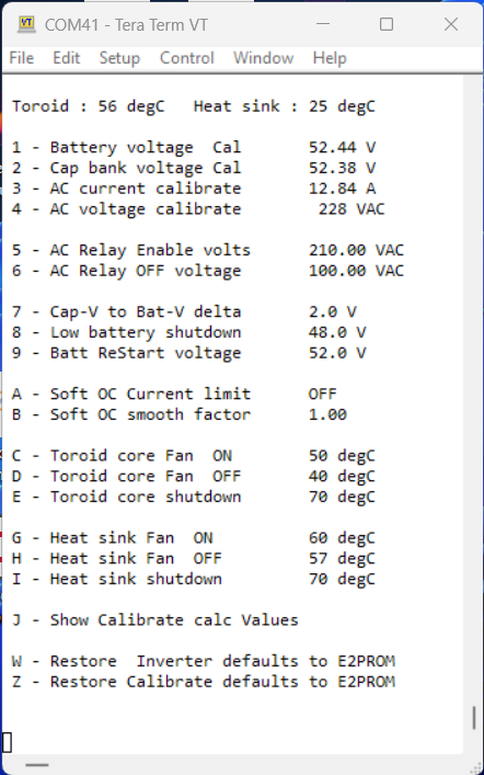

"J11 Link = TEST mode"
This indicates that the Controller has detected the J11 link is in Test Mode, turn the inverter off before changing the Link. It will be automatically detected and show the message above, or return to normal if the link is removed.
In test mode, the Controller will ignore all low voltage conditions - they are not displayed - however it will monitor over temperature settings and will stop SPWM drive until that is resolved. It will Trip on hardware AC over current. It will ramp down on software over current if set, but the LOW AC cutoff is bypassed.
Basically the inverter will run from around 13v to 59v. Yes, it will go higher - do you really want to?

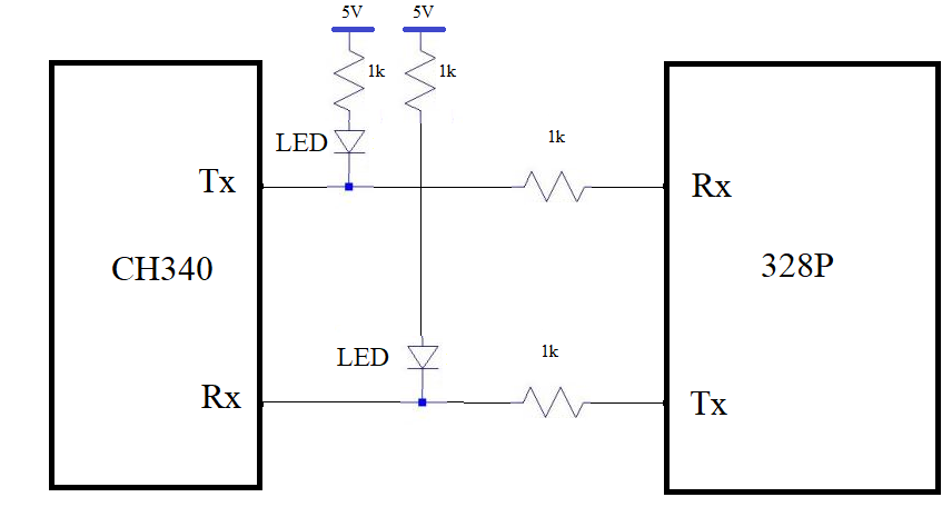

One of my latest Arduino nano purchases has problems with the UART to usb chip, I think some kind of ch340 clones as te marking is scraped off. They don't allow communication at all while working in for instance a mppt controller (to much noise perhaps?) A little bit annoying while in calibration mode or developing phase.
Did not see a extra components, I will need to verify that.

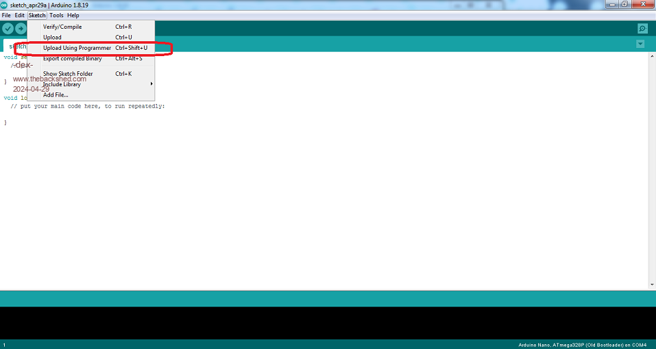

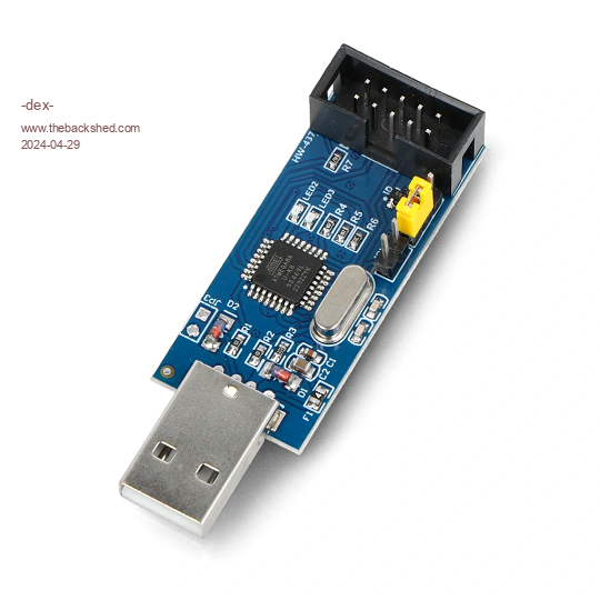

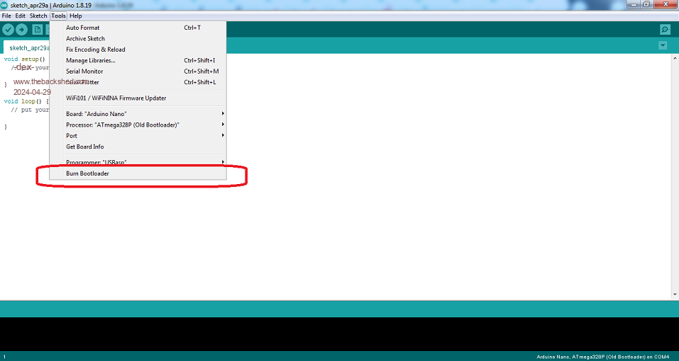

There is a simpler solution that allows you to upload a new bootloader or a written program without using the bootloader. You need a cheap USBASP programmer as in the photo below. It is compatible with the Arduino environment after instaling USBASP driver, you can programm directly from arduino ide.
Edited 2024-04-29 18:31 by -dex-

Hi, I've seen some of those boards, these boards are perfect in communications. I have one of the new boards with CH340 that I programmed by using a method in the previous post, it's running the Inverter perfectly right now.
USB com while running, changing Menu settings on the fly with the inverter powering a load, everything is perfect.

  -dex- said  There is a simpler solution that allows you to upload a new bootloader or a written program without using the bootloader. You need a cheap USBASP programmer as in the photo below. It is compatible with the Arduino environment after instaling USBASP driver, you can programm directly from arduino ide.
Thank Dex, yes I found the upload bootloader in the IDE before, I'll grab one of those little boards - save me time and effort - thanks.

  nickskethisniks said  One of my latest Arduino Nano purchases has problems with the UART to usb chip,
May not be related but worth checking out.
Had one that received data correctly but sending was unreliable. After tracing the circuit between the chips found this:-
The lower activity LED is on the wrong side of the resistor in the data line. Removing the LED fixed it.

BTW thanks Phil for posting that circuit, that is pretty poor, the LEDs in these are at least driven by ports on the USB to serial TTL chip.

Well the cheap USBASP programmer arrived.
Once I had it rewired, I was able to burn a new boot loader or upload a program using it. For program upload the inbuilt IDE software programmer via boot loader is noticeably faster- obviously.
The boot loader, the Nano with the old boot loader is now seen as a Nano with the new boot loader, and runs at a faster baud rate accordingly.
However, the problem with the these Nano boards remains, it's purely a problem in the hardware or the CH340. I am certain that the CH340 chip will not do anything until it is first connected to at 9600 baud, once connected you then release the port for other programs to use, once you do that, you can leave it sit for hours, it will then connect correctly and the baud rate change handshake responds to the baud request and life is good - it programs and verifies perfectly as before.
If you try to program it again - you fail - Why? - because the baud rate is no longer at 9600 after programming, so you can't initialize a new programming cycle, so back to 9600 first.
RECAP: These CH340 Nano boards will not respond to a baud rate request at anything other than a 9600 baud connection, after that, they run and program at normal high speed baud rates.
Changing the boot loader makes no difference to that behavior.
Nice to have the option of installing a new boot loader - or programming without a boot loader, that makes a few extra bytes available for programming.

I realized that two things were missing:
1: I did not have an Inverter DC input over voltage setting - actually really important.
2: I've often worried about having a feedback connection or component fault that might possibly cause the Inverter AC output to go really high, so I've added both options to the code.
BTW, don't take any notice of the settings, they are set to cause the inverter controller to trip at lower voltages for testing and verifying the LCD information for trip condition is correct.
Unless someone comes up with an option they think I missed, this is the final addition to my build of the controller code.
FYI The AC relay enable can be set to AUTO (0) = Enable AC relay at the completion of SPWM ramp up.
Edited 2024-05-04 15:57 by KeepIS
