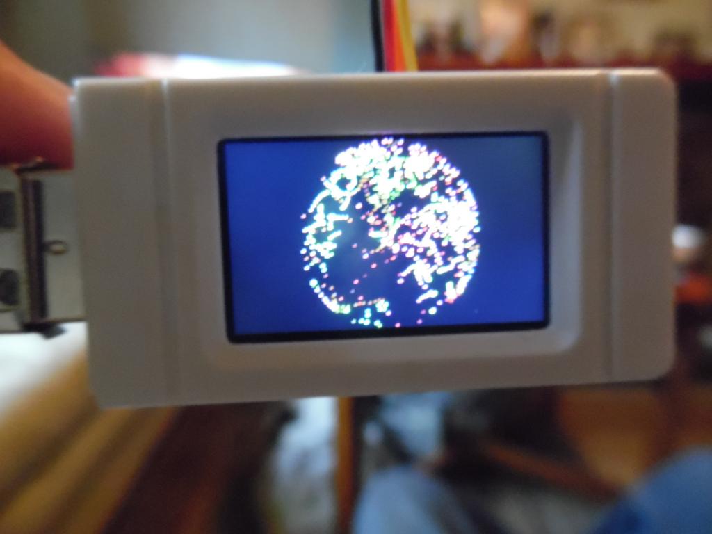

stanleyella
Joined: 25/06/2022
Posts: 2807
Posted: 03:14pm 17 Feb 2024
PicoMite MMBasic Version 5.09.00b1
OPTION SYSTEM SPI GP10,GP11,GP24
OPTION AUTORUN  ON
OPTION FLASH SIZE 4194304
OPTION HEARTBEAT OFF
OPTION PICO OFF
OPTION LCDPANEL ST7789_135, LANDSCAPE,GP8,GP12,GP9,GP25
OPTION SDCARD GP23, GP18, GP19, GP20
OPTION AUDIO GP2,GP3', ON PWM CHANNEL
Waveshare geek and bubble universe worked but Conway's life didn't or any sprite or layer L code.
Bleep
Joined: 09/01/2022
Posts: 863
Posted: 03:34pm 17 Feb 2024
You're right, anything with a layer doesn't work, bubble universe writes straight to the LCD. Had I had any error messages, they are working fine.

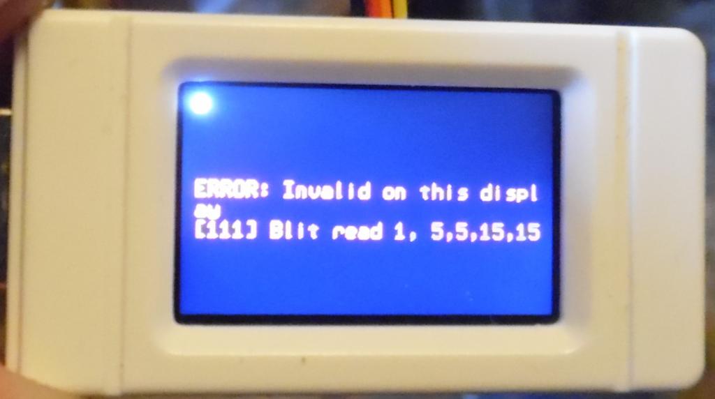

Posted: 04:02pm 17 Feb 2024
This simple scope worked before

stanleyella
Joined: 25/06/2022
Posts: 2807
Posted: 04:06pm 17 Feb 2024
Conway's life worked before.
RUN
[111] Sprite read 1, 5,5,15,15
Error : Not available on physical display

Posts: 12045
Change it to BLIT READ and try again

stanleyella
Joined: 25/06/2022
Posts: 2807
Posted: 04:40pm 17 Feb 2024
  matherp said  Change it to BLIT READ and try again
RUN
[111] Blit read 1, 5,5,15,15
Error : Invalid on this display
is it me?
changed all sprite to blit
cheers, stan
note the different error messages... Invalid--not available
Edited 2024-02-18 02:55 by stanleyella

Posts: 12045
Posted: 05:12pm 17 Feb 2024
The bug is in FRAMEBUFFER COPY if you add ",B" to do the copy in the background it should work
Stan
Your issue is that you are trying to read from a non-readable display. You must put the FRAMEBUFFER WRITE F before trying to read then the read happens to memory
Edited 2024-02-18 03:13 by matherp

stanleyella
Joined: 25/06/2022
Posts: 2807
Posted: 05:39pm 17 Feb 2024
  matherp said  The bug is in FRAMEBUFFER COPY if you add ",B" to do the copy in the background it should work
Stan
Can Mick or anyone explain this for the the dull crayons in the box please? :)
this and usb !?! usb wireless keyboard is working fine
do I need a sd card... drive b: in the sprite demo?
ps thanks Peter for all your work.
pps so it reads a readable display?? thought it would be from ram??
just when I was getting the hang of things :)
Edited 2024-02-18 04:13 by stanleyella
Posts: 12045
Posted: 06:11pm 17 Feb 2024
Version 5.09.00b2
Fixes bug in FRAMEBUFFER COPY for SPI displays introduced in these betas
Major performance improvements for 16-bit parallel displays
