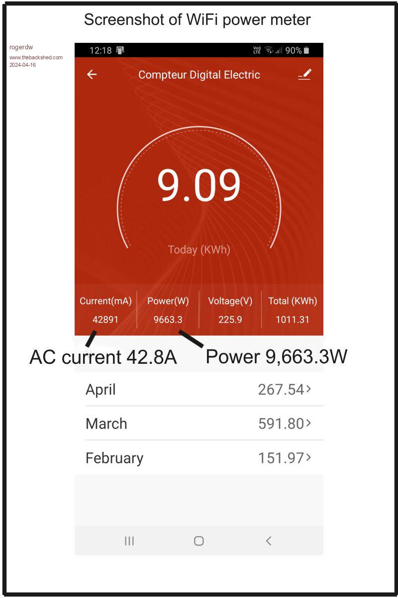

Yesterday we had two segments of underfloor heating running (6,000w total) along with the normal house load for 4 and a half hours  ...  then turned half off and ran the other for an extra hour.
Seemed to handle it okay. The electronics stayed cool  ...  just a few degrees above ambient, but the larger two toroids started to warm up to around 50C  ...  so turned on a pedestal fan which brought them back down to lower 40's. I need to fit the barrel fan I have planned.
Today I'm running both heaters again and I happened to spot the total load right up at 9,663 watts at one stage. Gulp!!
The load pulled the output voltage down to 225.9v at the inverter  ...  and lower again up in the house at the heater connections  ...  so it's time to fit the "feed forward current correction" that Klaus used.
I have the current transformer on the input bus, so just need to find/work-out the rest of the process.
Along with the nicely coloured power meter, I have a basic wifi one which enables me to keep an eye on loads without having to head out to the inverter. Here's a screenshot of the biggest load so far.

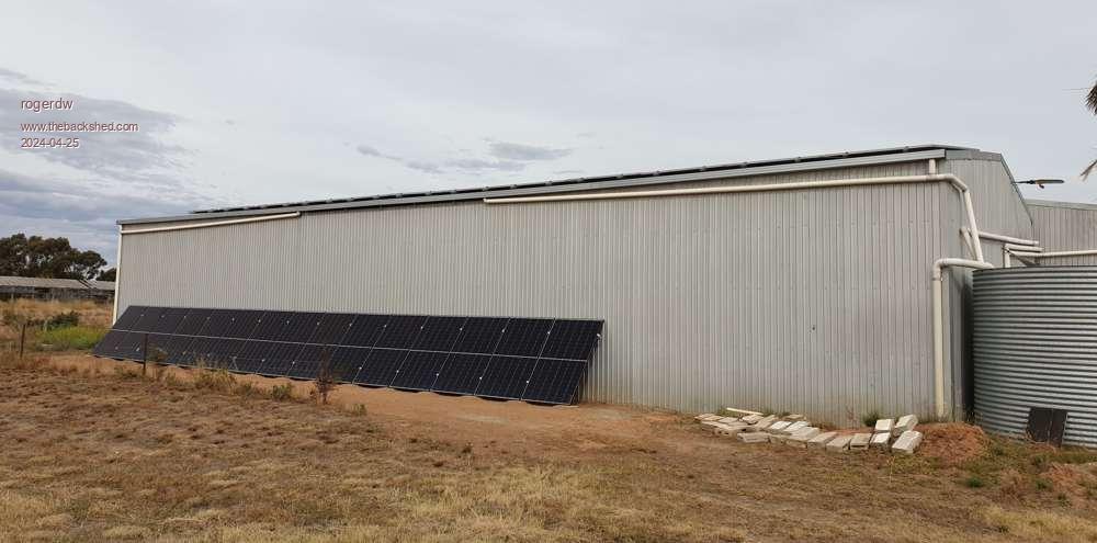

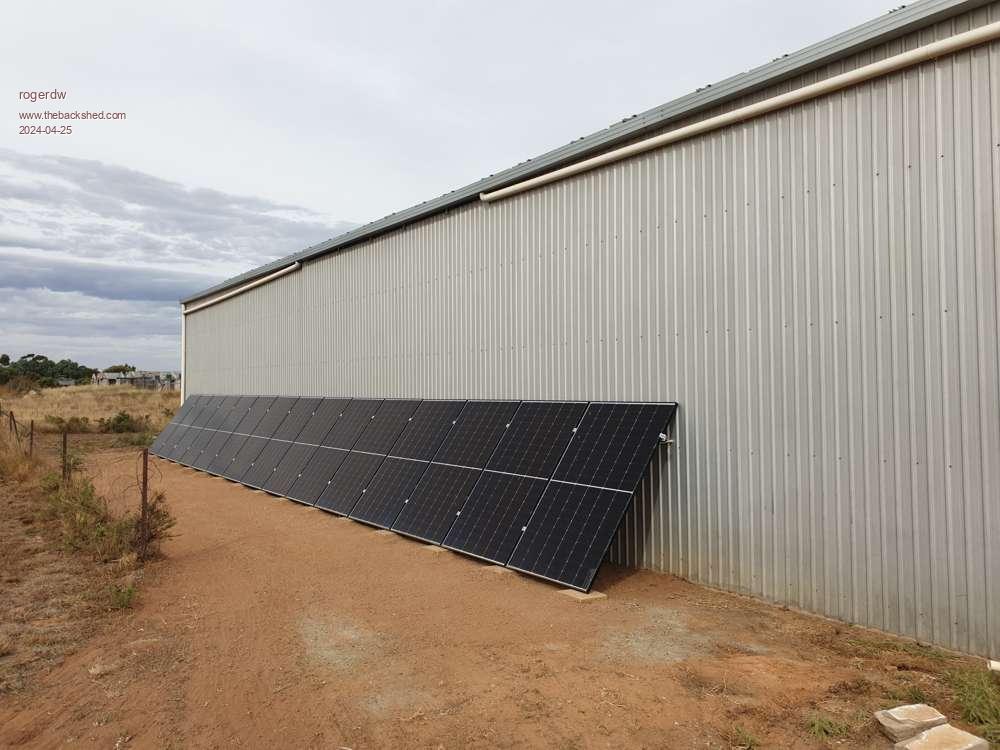

I picked up another batch of panels, rails and a 5kW Growatt GTI from Marketplace last weekend. 15 x 440w Jinko panels for an extra 6.6kW. It cost me $1,000 but I had to remove them from the house which is slated for demolition.
I've leaned them up against the north facing wall of the shed and fed them in two strings into the GTI. They are all clamped together with a rail all the way through and all the bottoms clamped together  ...  then tied to the shed.
It was time to jump into ac-coupling so I hooked it up and turned it on  ...  and stood back. It all seemed to go smoothly and very slowly started to ramp up  ...  and as its output rose, the Warpverters dropped correspondingly. Was exciting to watch.

24 x 250w = 6kW
24 x 275w = 6.6kW
15 x 440w = 6.6kW

Great idea with those solar panels, I assume they face North? Easy to clean too .

  Murphy's friend said  Great idea with those solar panels, I assume they face North? Easy to clean too .
Yes it faces directly north  ...  very convenient layout. I was being lazy I suppose but the inverter is only a couple metres inside the shed from the right hand end of the panels, so it certainly saves in cable too.

I should give an update on how it's going otherwise. It was a dull day on Monday so I didn't wind up the heating  ...  but all other days it has been good solar weather and today for example I turned on 6kW of underfloor heating at 8.45 and didn't turn it off till 3.45pm
And we are using a 2,400w oil filled heater for MIL's room plus another 1,000w one for the family room  ...  so that's 9.4kW of heating!!!
A couple of weeks ago before I hooked up the underfloor heaters, the tiles were between 17 and 18 degrees. They've been slowly increasing each time we have it on  ...  and today I measured some at 30.5 degrees. Unbelievable.
I realise it is not likely to be sustainable once we hit winter  ...  but having it all warm beforehand will certainly soften the blow. And if I were to see another lot of 440w panels cheap enough  ...  well I reckon I could make use of them still.
There's something surreal about powering all that heating and seeing the add-on GTI contributing 5kW  ...  each mppt providing 2,000+ watts  ...  and still 95 amps going into the battery  ...  and the battery sitting at 55.4v.
Today the GTI contributed 35.8kWh and so far the Warpverter 36.33  ...  and we used to average 20-22/day. Just wish I'd jumped on the solar wagon years ago.
