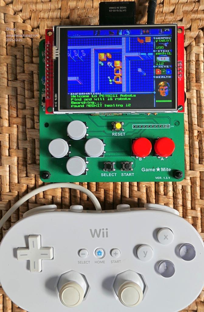

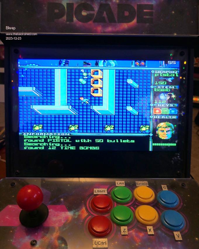

Posted: 04:28pm 22 Dec 2023
Attached, Petscii Robots, running on a GameMite, with a Wii Controller.
AND Petscii Robots, running PicoMiteVGA on a Picade. :-) I have added a new key mapping for the Picade controls for the game. :-)

Or did you use a different input to the monitor (VGA)?
Bleep
Joined: 09/01/2022
Posts: 863
Posted: 07:33pm 22 Dec 2023
Hi Harm,
It's old now, from the original Kickstarter campaign for the Picade, so a Pi3. No that's still there, it's booting into the desktop, where I can run MAME or run up a terminal to connect to the Pico, which now sits alongside the Pi, luckily the screen driver has both HDMI & VGA inputs, as well as audio, so the sound even comes through the Picade speakers. :-) The Picade controls simply behave like keyboard input, hence the re-mapping I had to do.
Picadeomite
Thanks for all your hard work, not only on this but also the PIO.
Have a Great Christmas. Kevin.
