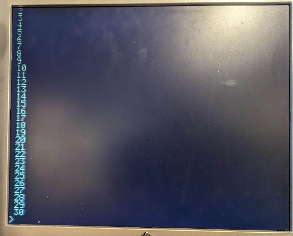

Posted: 06:41pm 11 Dec 2023
Maybe just an anomaly to be lived with:
> list
MODE 2
For i = 1 To 30 : Print i : Next
End
> ? mm.info(version)
5.0708
> option list
PicoMiteVGA MMBasic Version 5.07.08RC21
OPTION SYSTEM I2C GP0,GP1
OPTION KEYBOARD US
OPTION CPUSPEED (KHz) 252000
OPTION DISPLAY 20, 40
Run the program on a PicoMiteVGA. Observe the prompt and cursor at the bottom of the screen afterwards. The bottom line is part way off the screen. Type something such as "print 1234" to see this more clearly. ("Option Display 20,40" is presumably a result of still being in mode 2 when I typed "option list".)

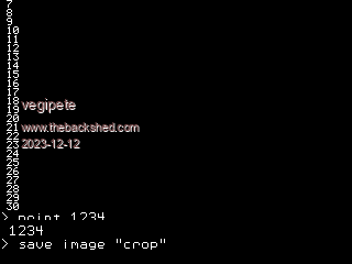

No, pixels are actually missing. At least 2 rows. They are still missing when the screen scrolls up.
Edit: I see 3 missing rows, although the cursor is shifted up into view.

Yes, they are.  (Direct VGA, fwiw.)
I haven't changed the default font size - so font #1 (?) is partially cut off. In your image, the greater than sign (prompt at the bottom) appears to be the same size as the rest of the text.

That looks wrong. Compare the size of the two "4" characters. The one at the bottom is bigger than the one at the top.
Posts: 3415
Posted: 11:23am 12 Dec 2023
Mick is on to something. When the program ends it returns to the command line with a bigger font. Too big for the bottom line so it gets clipped.
Zooming the image, in the program the characters appear to be 8 pixels high then switch to 11 after it ends.
